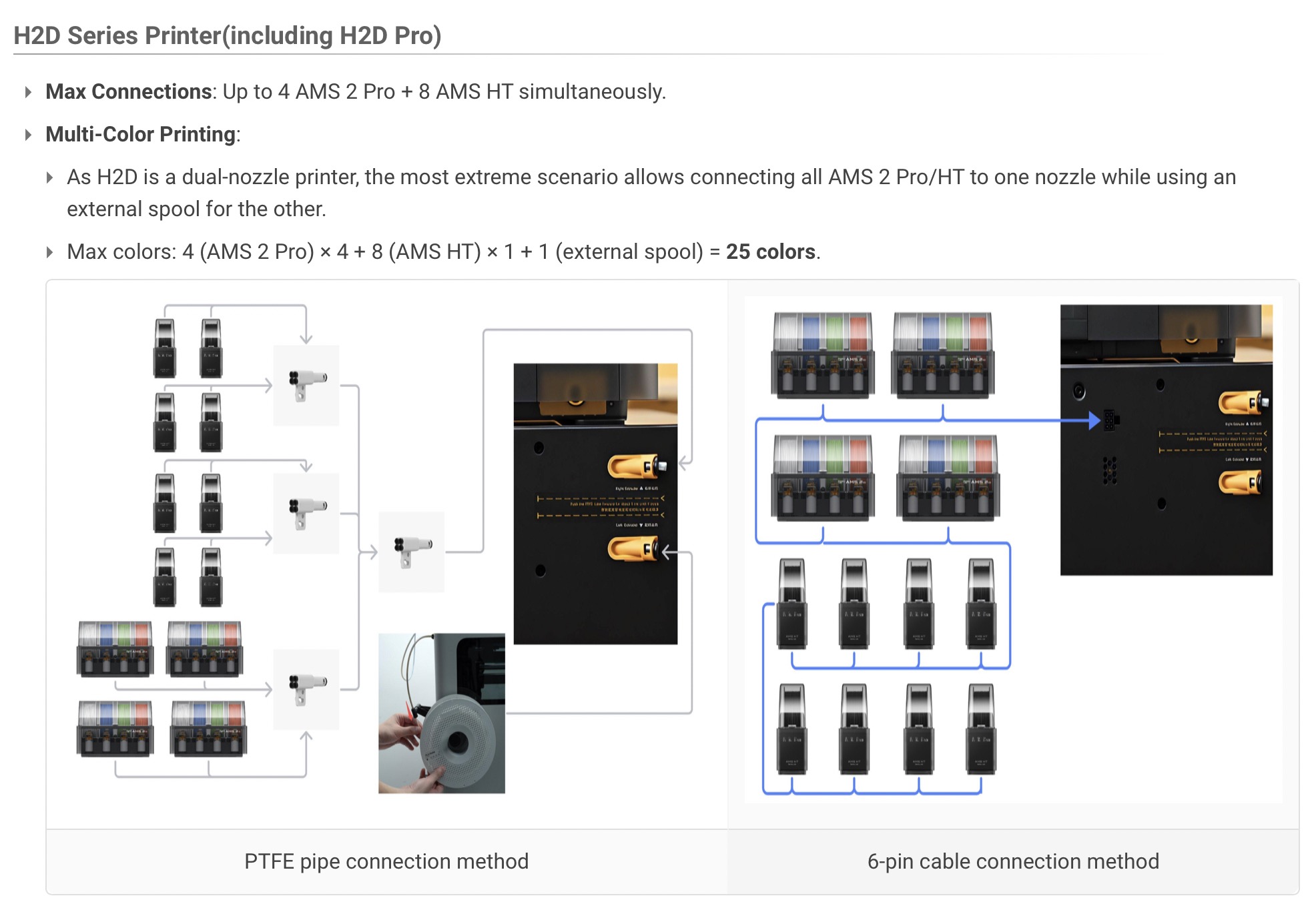

Whilst thinking this through, I spent some time reaching the Bambu Lab wiki, but couldn’t find a “proper” answer - I’m trying to understand which AMS with which filament to daisy chain to which nozzle.
The FAQ mentions that “Because H2D is a dual-hotend printer, and in the most extreme scenario, all AMS can be connected to one hotend while the other hotend uses an external spool holder, it can support up to 25 colors.” - note the word “can”.
This seems to align with the Bambu connection guide - this shows the same, all AMS 2 Pros and all AMS HTs all connecting to the top PTFE pipe (right nozzle), with the bottom PTFE pipe (left nozzle) being fed just from the external spool for TPU etc. Screenshot below.
I would have thought that this approach has some disadvantages. I also appreciate that this is likely to be something where everyone has a point-of-view.
  • You lose true two-material printing, the main advantage of the H2D - two independent printheads.
  • Uneven nozzle wear and usage
  • Longer AMS load paths - friction adds up
  • External spool not accessible to AMS login - external sppl is managed manually, no spool tracking, drying status, purge towers, colour mapping and spool-change notifications - all advantages of AMS-fed nozzles.
  • No dual AMS redundancy - if nozzle 1 clogs, all AMS inputs are blocked.
Anyway, in this scenario, how would you advise me to set up the 3x AMSs - as Bankbu sets out in the Wiki, or a different way entirely? Which filament would you put in which AMS, which would you daisy chain, and which port would you route them too

I would recommend one AMS2Pro on each nozzle, plus the AMS HT sharing one of the nozzles (probably right fixed nozzle for TPU etc.) with via a 4 way joiner.
Then depending on what multi colour or multi material prints you do be prepared to swap your spools between the two AMS2Pro’s in particular to minimise print time and waste. So I wouldn’t dedicate any particular AMS to any particular material or colour.
I usually find it best to get the slicer to give me an optimal timing and compare it with the time if I don’t move the spools around - and only swap the spools around if there is a large benefit.
This isn’t a universal setup, but it’s how I’ve configured mine:
I have 2 AMS2 Pro units and 3 AMS HT units connected to the left nozzle,
and 2 AMS2 Pro units plus 1 AMS HT connected to the right nozzle — the latter also serves as the bypass for TPU/PEBA printing.
That means I’m using three 4-in-1 PTFE splitters for each port on my H2D, and I might add more splitters later.
I keep all support materials on the left and the main materials on the right.
