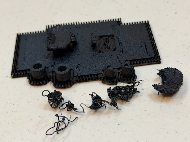

First post here, and relatively new to H2D, with some prior printer experience.
I am having some challenges getting small scale prints to come out using Bambu ABS on my H2D. Latest attempt using “0.08 Extra Fine @ BBL H2D”, 0.4mm nozzle, on a smooth PEI plate. (And I have done calibrations, and Vision Encoder.)
I am getting a lot of “curling” on the underside, and around where the tree supports attach, above a brim.
Hopefully attached pics will help show the issue. Overall quality has issues too. 3mf attached for settings I used this time. Previous failures were similar, and I have run out of ideas to improve the results.
Any suggestions appreciated.

Small parts = short layer times = plastic isn’t cooling off enough on layer “N” before “N+1" is underway. The nozzle extrudes over plastic that’s still molten, so it “splooges out” under pressure. Slow down, turn part fan on, reduce extrusion temp 5-10º if the filament will allow it. And since these are small, the defect areas are in close proximity to the build plate, so lowering that temp a bit might help, too.
It can also help to have more objects on the bed.
Consider using a 0.2mm nozzle, because 0.08mm layer height for a 0.4mm nozzle is really sub-optimal for overhangs.
And take all the other given into account also.

I had a spaghetti failure and aborted. That attempt was clearly no better than earlier attempts, and a curling piece of ABS clearly snagged on the nozzle and yanked a part off the raft.
I changed to the “0.12mm Fine BBL H2D” profile, and decreased speeds even more. I confirmed fan speeds matched the suggestion above, and this is what it looks like now.
Any other suggestions or ideas? I don’t feel like I’m making any headway here.

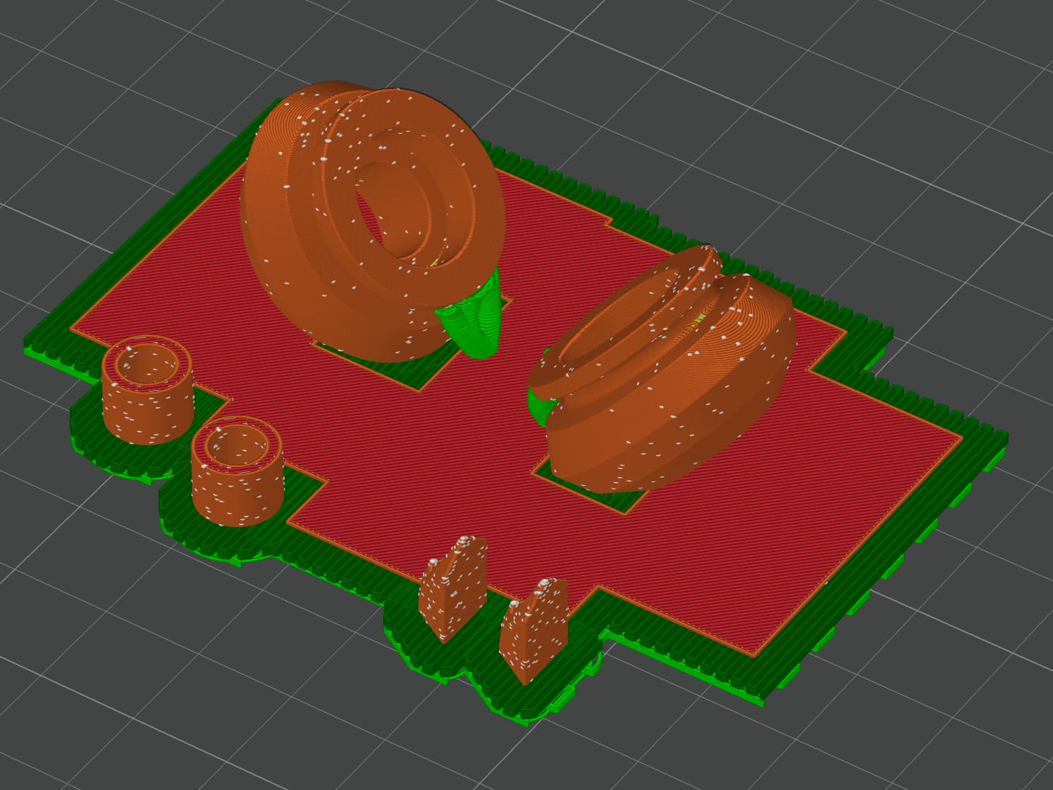

Before I saw your reply, I had prepared a plate with the Bambu / Voron cube, but before I hit print I decided to add one of my cutterhead parts, and just “paint the heck out of it” with supports, just to see what would happen. I’m thinking much better support may solve 85% of the problem.
I’ll probably still fiddle with flow and extrusion as you suggest, but based on the cube, and other tests, I don’t think those are way off. Here is my cube and a part from last night’s test print…
On vibes alone I would decrease nozzle temp by at least 5C, and really dive into the preview panel to inspect wtf the supports are doing and where they are making contact, and maybe select a different support archetype. For this object I would select Normal, adjust the spacing of the interface to 0, and maybe try to keep the top Z gap and XY gap a little smaller than default, just so it can print cleaner with the ultra low layer height. may be hard to remove :slight_smile:
I dont know what the models objective is but Im guessing that the ragged ring-shaped side wants to be flat, and you might consider giving up the robustness of a tilted part for the precision certainty of a flat plane. or flip it so that the other surface gets crappy.

I’m revisiting this issue, after pausing it for a few days…
I am printing a different part, same ABS spool, dry and with the 0.4mm nozzle, I am seeing the culprit start to emerge and thought maybe I can use this to ask and solve the prior issue.
Much like I saw in the test swatches above, I am starting to see some “curling” occur on a thin edge that is sort of hanging out in space. In the right side of the attached photo, you can see the edge starting to curl up. Could this be avoided with support or ??
Photo and slice shown, both at layer 60, and the complete model on the build plate (4 copies).
Ideas? Feedback?
