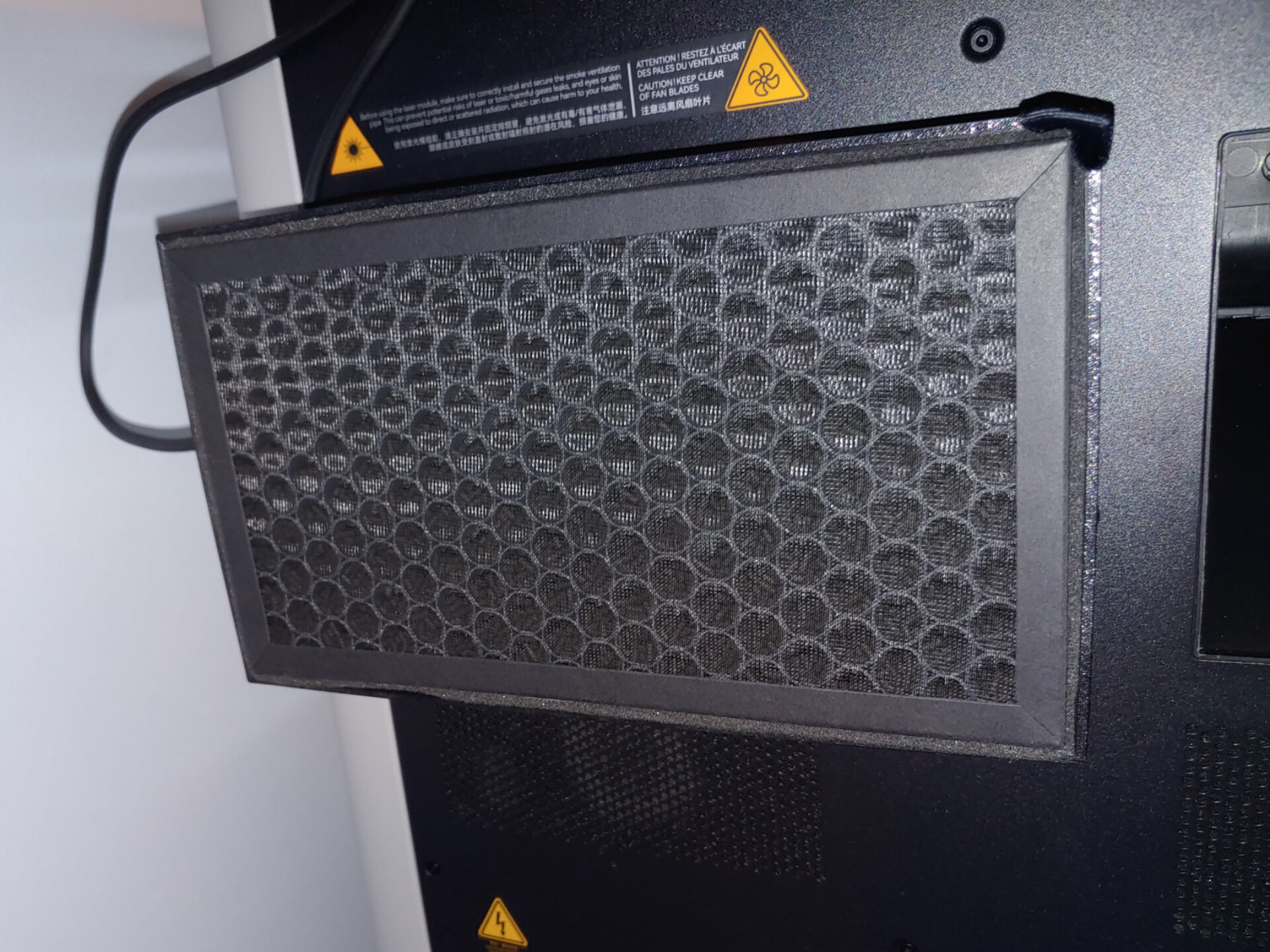

Ah nice. I made a poop chute that you can close, a recirculating filter and a exhaust filter, as I am often in the same room when it prints and my family members are often in here too. You can check out this discussion if you are interested, other people made things for filtration too: H2D Air Filtration Upgrade
Alveo3D goes one thought ahead, the cleaned hot air gets pushed up to the poop shoot back into the printer, this reduces energy costs and stabilze the printing environment for technical filaments. For PLA or PETG its needed to open a side flap - it combines filtering and cooling. This is a complete closed system for the backside of the Bambu. This is smart engineering we Europeans love :blush:
Been printing with smoke purifier connected at min speed. Chamber temp always between 31-33c.

Min is not loud, 100% is loud unless you close the room door.
