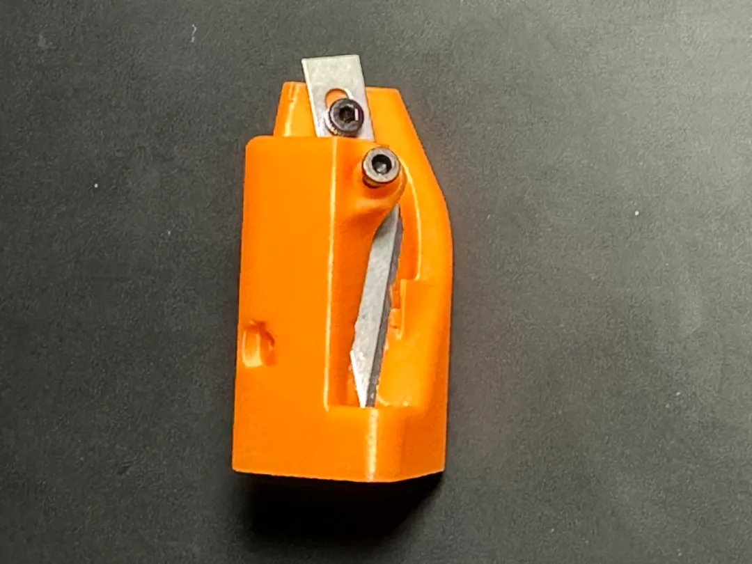

I keep forgetting that the solution, at least to a Scenario 1, already exists and is the use of an automatic filament cutter positioned at each spool in the AMS. So, that would require 1 for an AMS-HT and 4 for an AMS Pro 2.
This will fix it permanently
https://makerworld.com/en/models/957400-ams-saver-snag-cutter-v2-0?from=search#profileId-2437367
The end of the filament has always come loose from the black tape for me, which is what is supposed to happen. Apparently Bambu had a batch of spools where the tape was on too tight or something, but it has now been corrected. The filament should come loose from the tape at the end, leaving the tape on the roll.
Instead of cancelling your print completely, why didn’t you just cut the last bit of filament just before the tape, and then let the print continue? The printer would then have used up the end, and continued on the next spool…….
TL;DR. Agreed. Or, using an automatic filament cutter would have been even better.

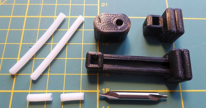

What was the inside diameter of the tubing you used? The project doesn’t specify, but I assume a minimum of 2.5mm would be preferred.
Also, and I don’t know whether it would have helped in your case, but you can chamfer the end of a PTFE tube to make feeding into it easier. A couple different jigs to make doing that easier and/or more precise:
I only know about this because some of the old-school Prusa hotends required it.
Well, anyway, I have 4 cutting blades arriving tomorrow, so I’ll likely assemble the four units then and if no issues either install them into the AMS 2 Pro then or else the next day. A number of the comments on the makerworld page have indicated encountering problems. If it fails, then hopefully there exists some other model that will work.

I used pieces of Capricorn PTFE tube, that I had leftover from my CR6, but they have a 1.9mm inside diameter. They are very smooth though as they are designed for Bowden. I could retry them with the standard Bambulab tubes, that are 2.5mm inside. Not sure if I still have them or that I trashed them.
They are a hassle to use though. Given the one failure I had ever since, I might accept it as it is.

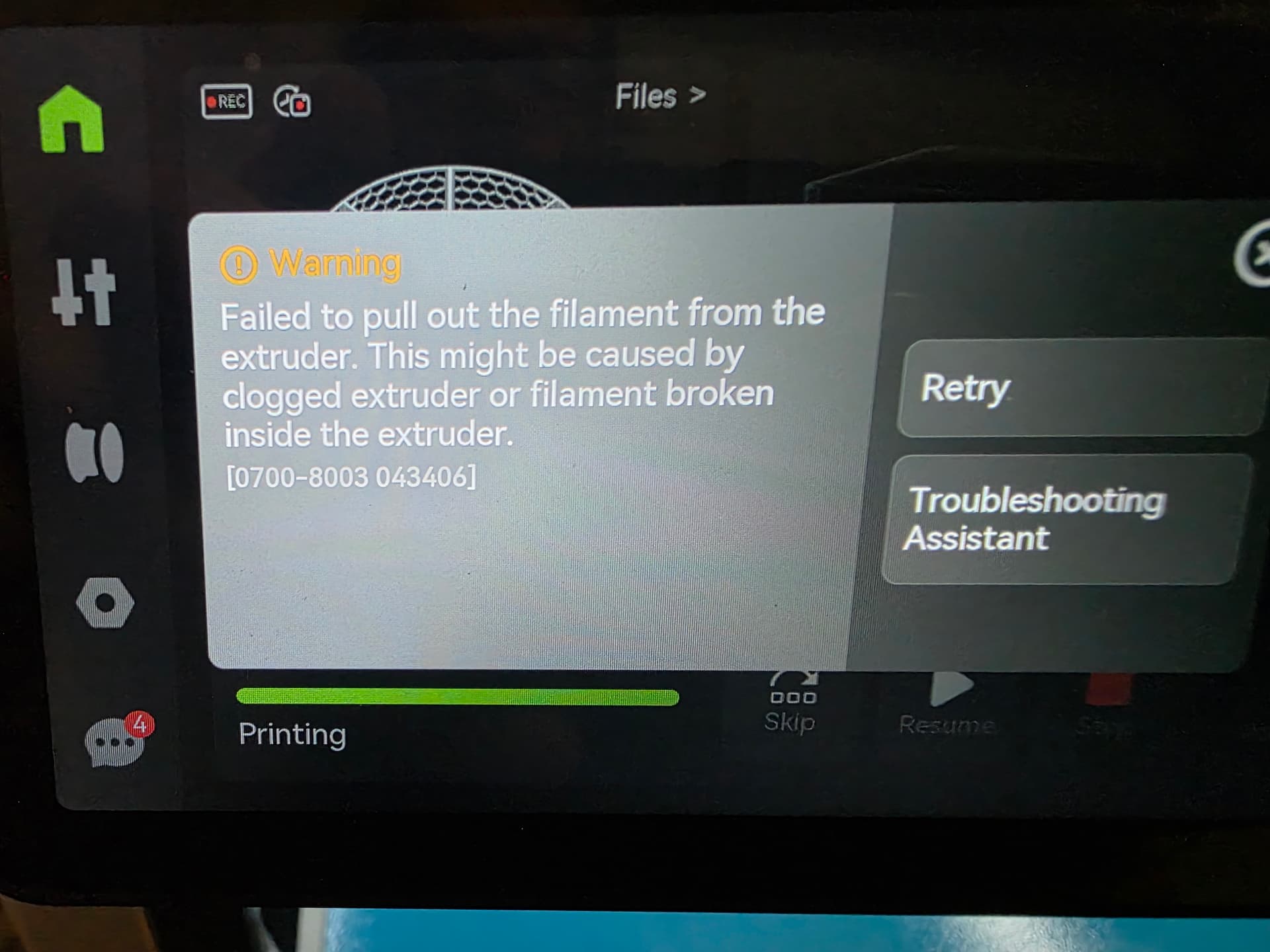

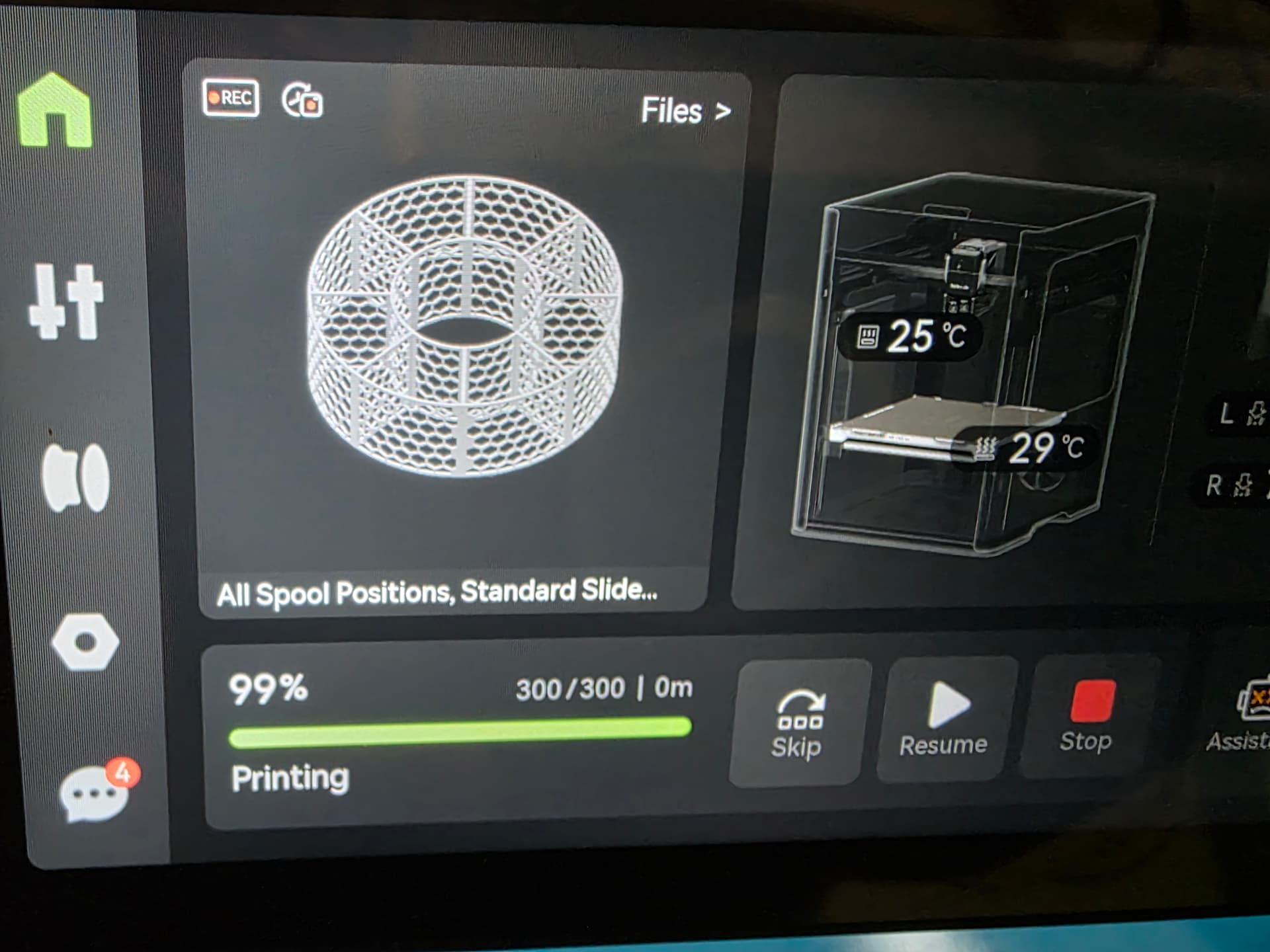

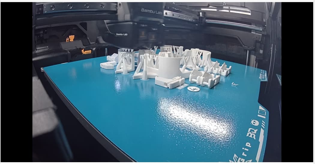

A variant of this scenario finally happened. 1. The end of the print was reached, 2. the end of the filament had detached from the spool (preventing future rewind), but 3. there was still unused filament remaining in the feedpath:
Therefore, throwing an error because it could not rewind the filament at the end of the print, as is its habbit:
I resolved it by “cancelling” the print (which was effectively done already, except for the final tidying up at the end). Then I de-mounted the PTFE tube from the exterior buffer port, pulled out the leftover filament that the machine was helpless to remove, re-connected the PTFE tube, and “Hey, Presto” back to a normal state.
Bottom Line: a bit of a hassle, but this particular scenario was no big deal to resolve.
