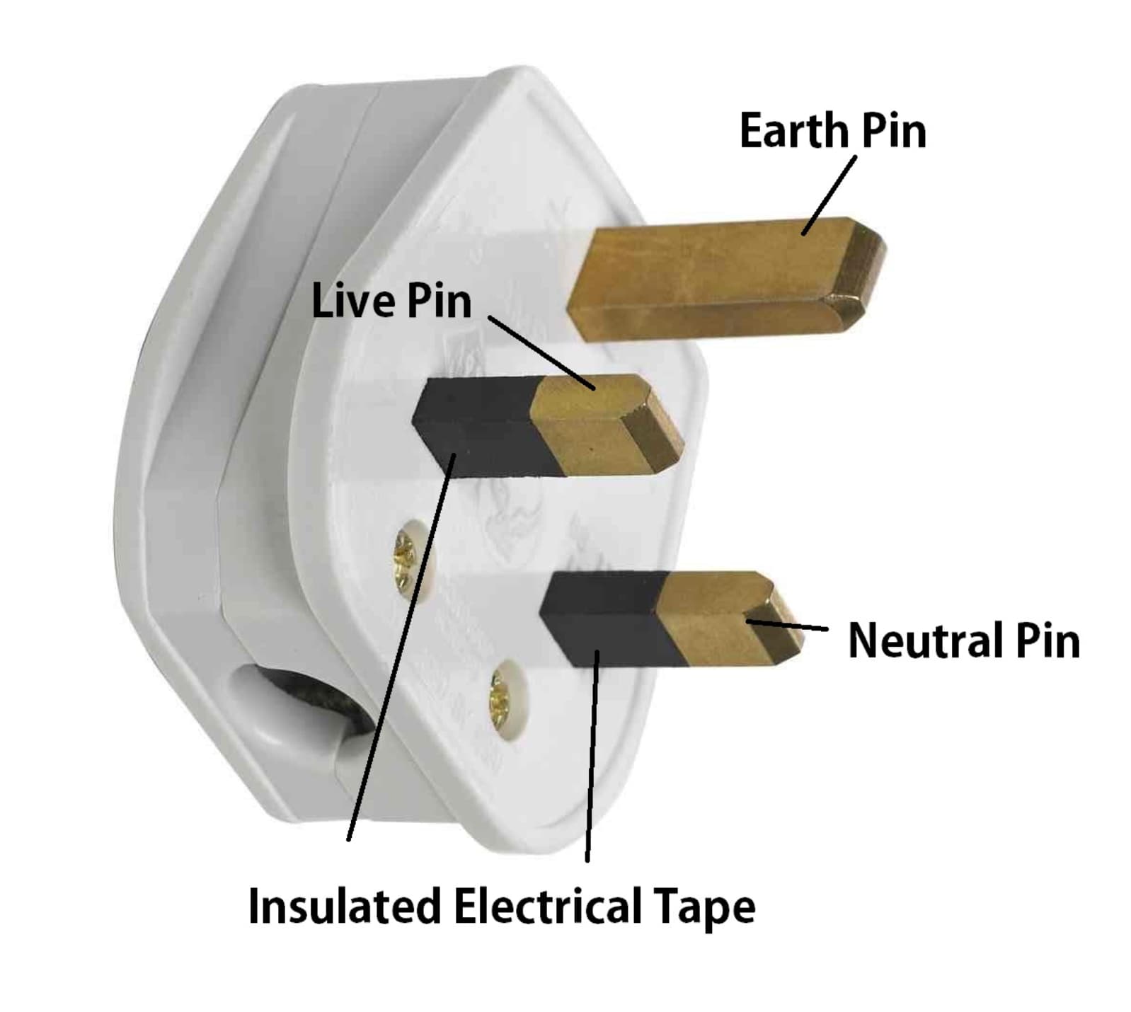

Maybe you can check if live pin and earth pin are switched in the extension lead. Then it would be best to change that in the plug.
Thank you all. I’ve changed to a different socket and extension lead. Things seem better. I was using a longer wound one so maybe the resistance was too high through that. I’m running an AMS2 pro and original AMS with it. If I get another AMS 2 pro then I know I’ll need an extra power supply for it
