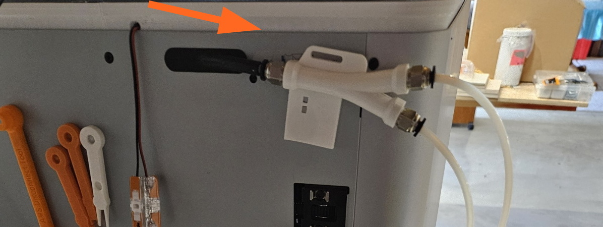

Yes i was thinking about a slim y splitter as well to reduce fiddling with ptfe tubes. Something like this:
I’m confused. is a splitter needed inside, or can be one used outside? see this one (splitter, ed johnson, printables) - i added 18mm magnets to hold it on the case.
can such a spllitter be used on te H2D, or does one have to be inside the case itself? and, for the other person’s post about adding a third ptfe line , for the TPU, don’t you have to still manually hook/unhook it each time, the right nozzle does not have two ptfe inputs, does it?

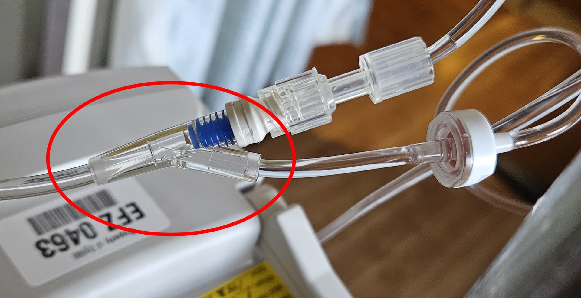

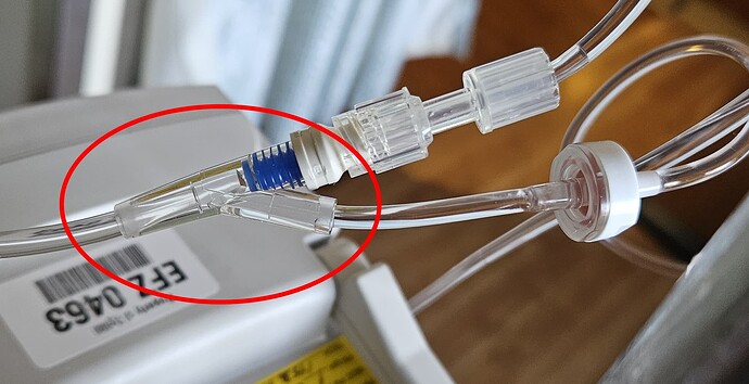

OK, here is a related solution. Medical IV tubing Y-splitter. We need something like this. It is molded; we need bambu to provide a “Y” piece of PTFE, and the splitter would be at the inside back of the unit, with one piece of the “Y” going from the filalemt buffer, and other upper end of hte “Y” going from the TPU inlet, and the combined piece going from that “Y” to the hot end. This type of flexible material (probably clear TPU itself) would help lessen or eliminate any banging, or motion of the tube, as it would be near the back inlets of the filaments. I know people are printing splitters, but a molded all-in-one piece with 2-ptfe-to-one-ptfe, of appropriate length, would help mitigate all the designing we’re trying to do,
How to send this to Bambu to at least look at, as something of a solution? This then makes it similar to what I do with the X1C, while my splitter for that is on the actual back of the unit. Then, at least I could probably do the 95A filament TPU (or at least try)

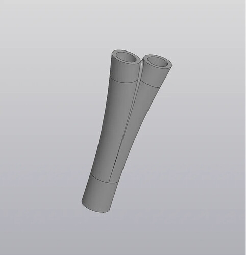

I printed the Y splitter from TPU for AMS to make it somewhat softer than PLA/ABS. When my H2D arrives will see if it works well.
where will you insert it? at back end, to incorporate the FILAMENT BUFFER input, and the TPU input, or further up toward the nozzle? I’m interested to see how it does. if you could, use this thread, i’ll keep a link to it on my desktop
Towards the nozzle, will post a photo after it arrives and how it worked out.

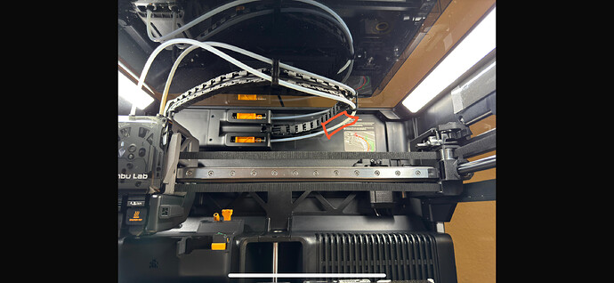

Anyone tried to put a y splitter where the red box is? The toolhead is on the left side. So I think it could work in terms of movement.
