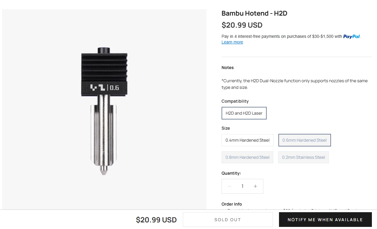

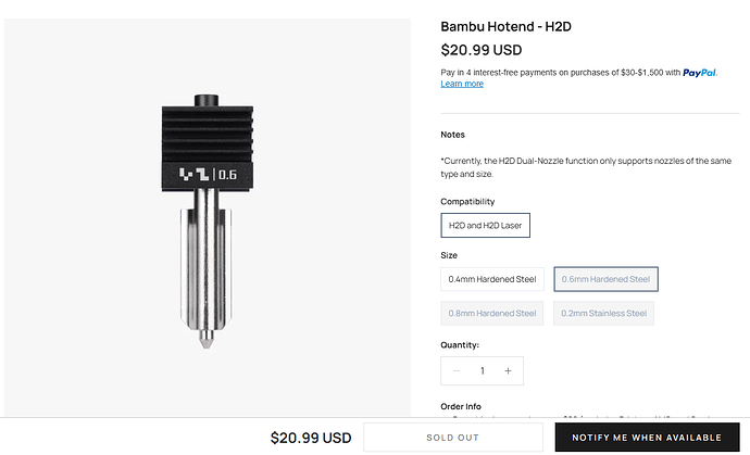

Given how, at least at present, the bambulab store is so very often sold out of nozzles with no projected re-stocked date:
it would be nice to know if there were an alternate source for a reliable and equally good or better nozzle, preferably with prime shipping!
Meanwhile, since the 0.4mm nozzles are presently available, I ordered extras just to have them on hand should the need arise. I ordered mine on June 1 and received them on June 5, so not bad, but definitely long enough that you would not want to have to wait that long for a replacement if you ran out of nozzles but still had an urgent need to complete a print.

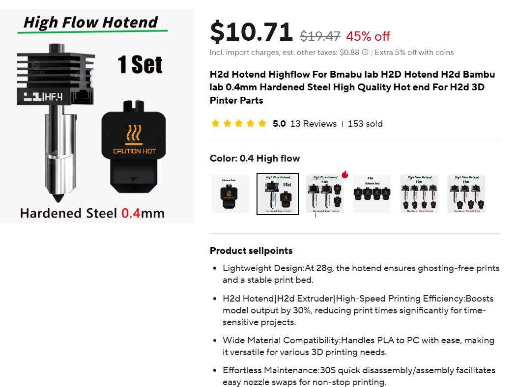

@maxim3D To fully memorialize your experience, Is this the one you tried from AliExpress?
Judging from appearances alone, it looks like there may be several different designs up for sale on Aliexpress. Maybe they’re all junk, as in your experience, or maybe someone reading this thread can report on one that they found acceptable. We’re all better informed if we pool our knowledge and experiences. :innocent:
Hopefully @user_3925814278 will report back on his experience too once he’s had a chance to try his.
Also, it’s still early days. Maybe the knockoffs will improve over time.
Yes they’re all junk. The CHT structure isn’t that easy to replicate.

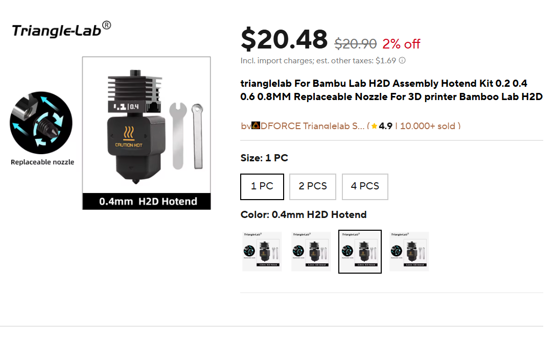

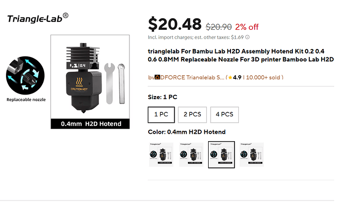

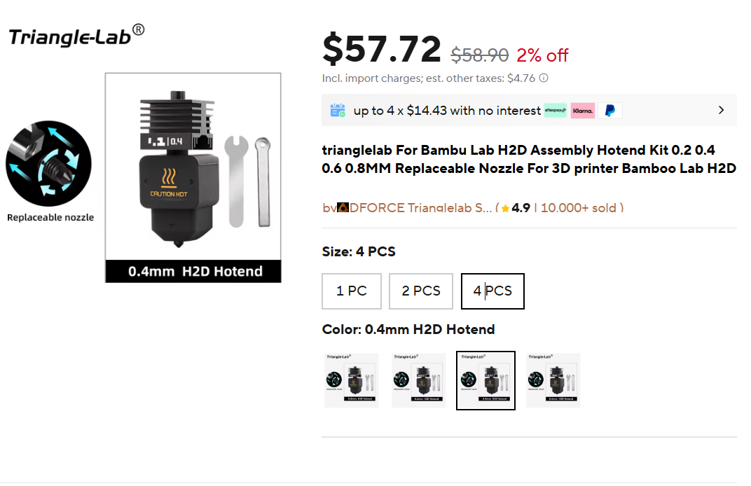

@user_3905127299 also mentioned triangle lab. It seems that Triangle Lab does make regular flow knockoff’s:

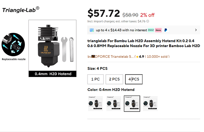

but the price is nearly the same as Bambulab store. However, in quantity of 4, there is perhaps some meaningful cost savings:
And the other nice thing is that they have p.2mm, 0.6mm, and 0.8mm hotends in stock.
In terms of cost, I’m not finding the Triangle Lab pricing very compelling. However, maybe that price will improve with time after they ramp their production capacity and are better able to meet demand. At least int he past, Triangle Lab had a decent reputation, generally speaking.

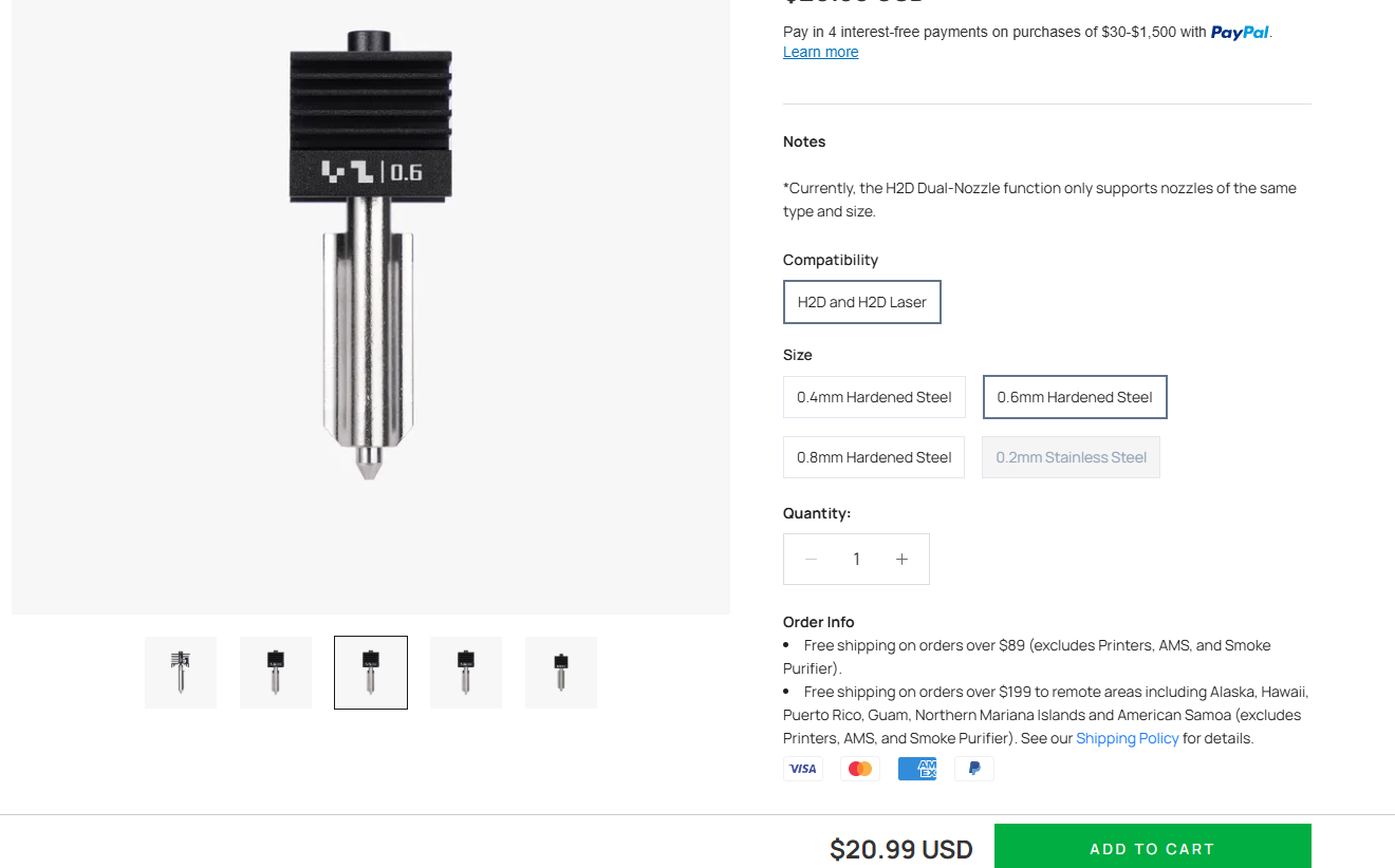

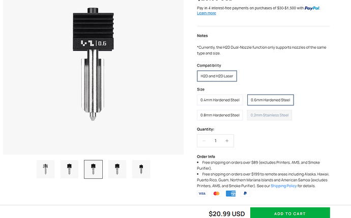

Update: Perhaps it’s moot, as Bambulab finally has the 0.6mm and 0.8mm H2D hotends back in stock now.
Regarding HF nozzles, I’ve only ever seen Bambulab offer 0.4mm. At least so far, I’ve never seen other HF nozzle diameters be in stock.
