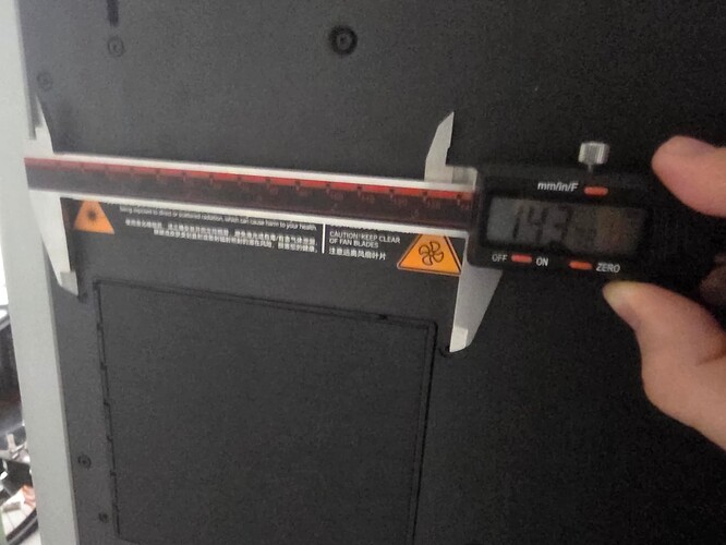

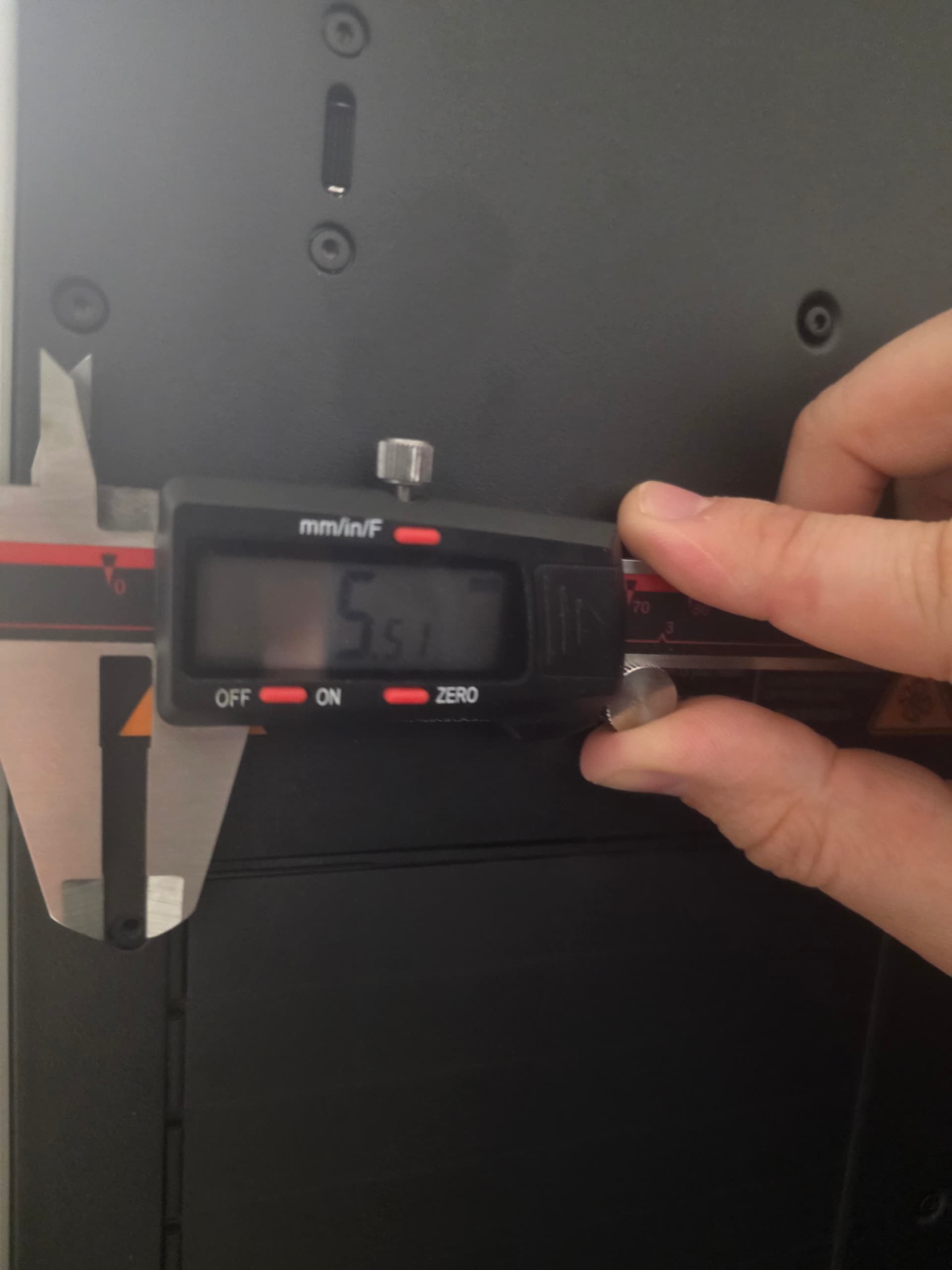

This is the adapter for the rear of the H2D. I’ll use dryer duct (4ā€ / 100mm) and a proper exterior building outlet. Also, I see other vent grilles on the rear. Are these intakes for the power supply or filter exhaust ports? I can design a manifolding system if this is the case. What I really need is the machine casing / hole dimensions. Do you know if they exist from Bambu or a reliable set of them here?
edit - I can also use an in-line axial fan if it helps extraction.
This is the exhaust.
There are a lot of models on maker world you can rip the dimensions off as well… better then me fumbling a caliper.
Thanks for this. I appreciate the effort of sending me the measurements. I will suggest to Bambu to put factory dimensions available for the many users who want to mod easily. I could ā€˜borrow’ a design from makerworld, but lots I’ve seem are - erm - basic. Not criticising really, but it’ll be better if I made something with my experience. I’ll share my machine pieces with the community, I was going to machine a billet of aluminium but this is overkill for this application - I will stick with a 3D print for this duct. Thanks for the help. :+1:
