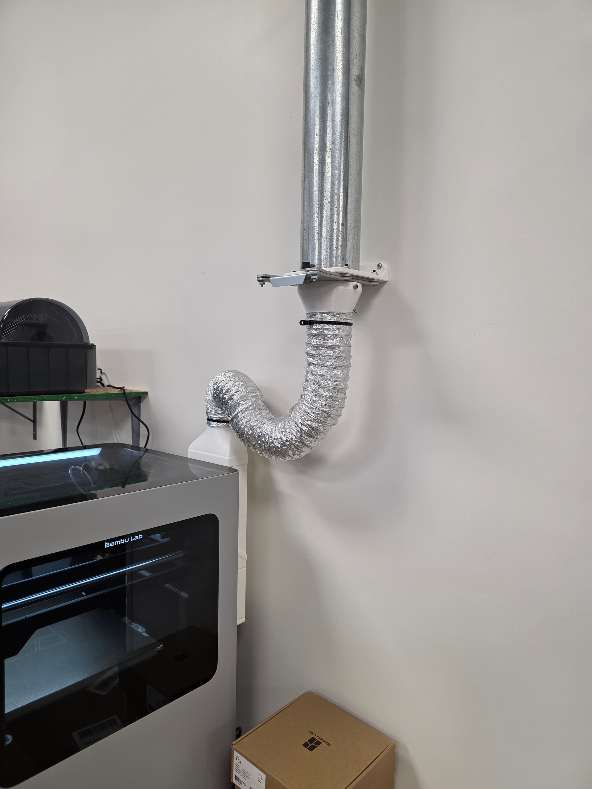

We already have an exhaust fan setup that runs 24/7 in the machine shop where the printer is so I’m going to tie into that with regular cheap round duct. I also designed a gate valve that’s 4in on one side and 3 on the other along with a wall mount to mount to 4in duct pipe.
That’ll all be wall mounted and then a 3in flex hose will go from the gate valve to the printer duct. Then I can control airflow with the gate valve, just enough so that it exhausts the fumes but not so much that it causes a draft or interferes with the heated chamber.

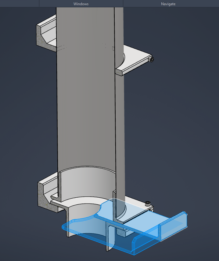

Sorry for the blurry picture, but I figured I’d chime in because I did this. I modified the official H2D Smoke Ventilation Pipe Quick-release Assembly to:
  • Fit a 150mm duct for a window-mounted exhaust system I bought off Amazon
  • Add holes for constant negative pressure ventilation without forcibly trying to suck air out of the H2D chamber
I used M3 x 18 screws.
The duct goes from the adapter to an inline fan on the window that’s always on low. I “tuned” it by holding a tissue to the holes on the side of the adapter and lowering the fan to just above where the tissue would fall, as I don’t want to constantly vent my heat outside either.
I’ve been using this system for about a month now and the ASA printing smells are noticeably lower, and none of my prints have been affected (I’ve printed some of the same tall/large PETG and ASA prints before/after the system).
In addition to that, I also printed custom shims to increase the fit for my exhaust system in the window.

My setup has been working perfectly. O went with an off-the-shelf 4” gate valve and just made a 4”-3” adapter for it. It’s plumbed into the shop’s exhaust and I leave the gate valve cracked open about 1/4” or so. This is enough to pull the fumes without causing chamber heater issues and works perfectly.
I printed two of the H2D vent flaps from this FPF video: https://www.youtube.com/watch?v=jj7Mv1iiFNc
And printed this H2D vent, I used the straight up 80mm version: H2D Ultrathin External Upward Exhaust Duct - Free 3D Print Model - MakerWorld
