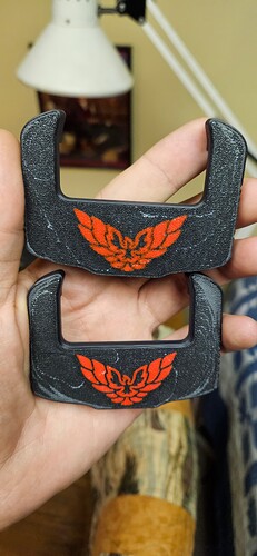

Hello, my new H2D is having an issue printing the red but only for the items on the rear of the plate. The front rows print beautifully.

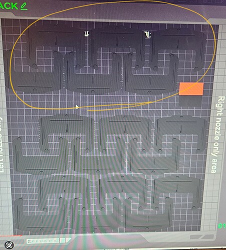

The circled ones print like the bad one. Anyone know?

Your “good” ones seem to have underextrussion/Z-offset issues. The bad ones, seem like they have the opposizte z-offset issue, or not enough purge.
Check your first layer while printing. do the lines fuse together as its printed (the front ones) or do they look like just lines next to each other?
Try to watch the printer as it lays it down, everything has a meaning, follow its steps and youll know why it happens.
