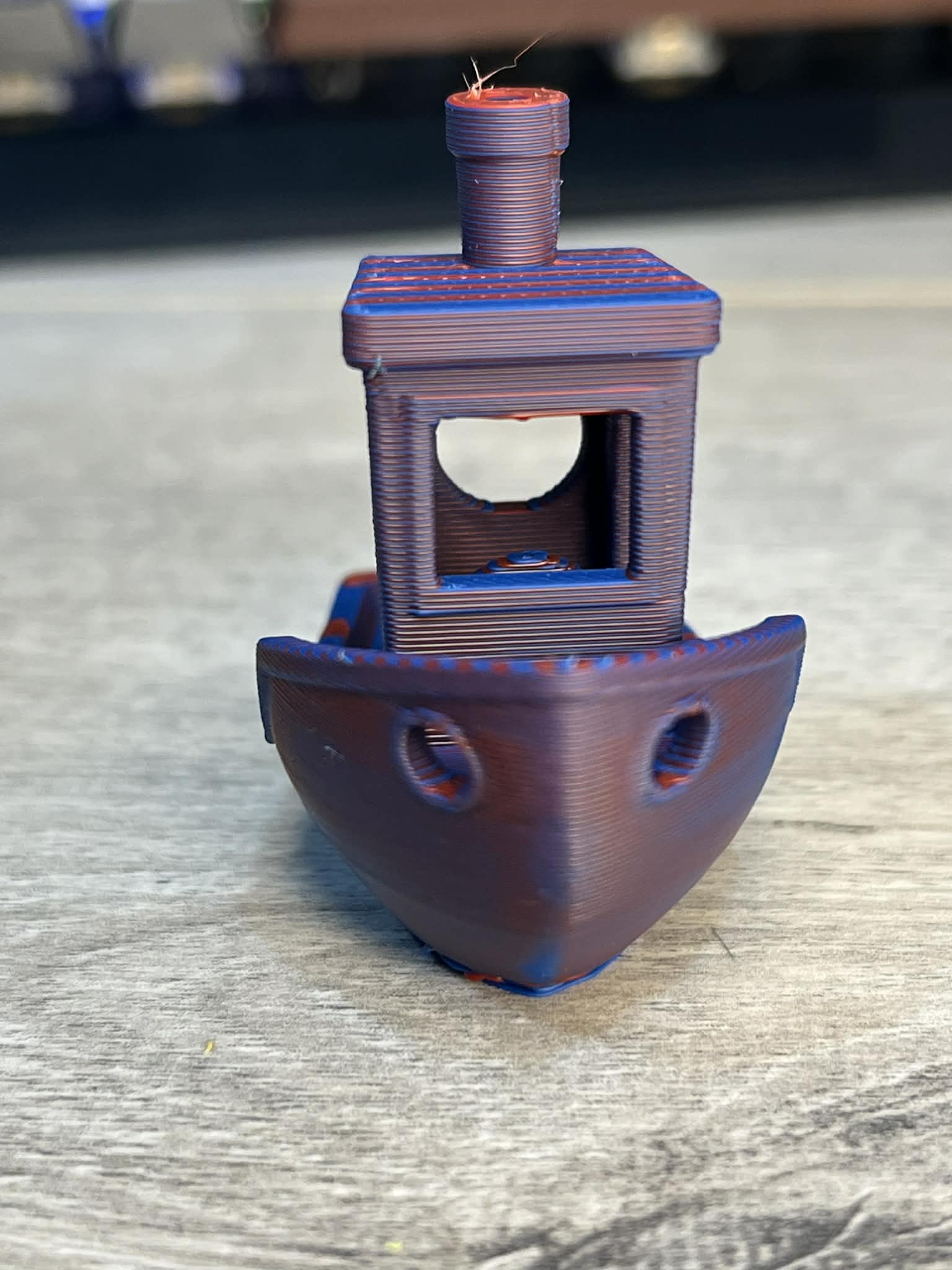

Here are some photos from my first attempts with trans red and regular gray petg, and blue/red abs.
on the red/blue ignore the first layer, the trans red petg from the previous run decided to jam the extruder and i had to slap it back to reality.
unfortunately for now im unable to capture the effect with the light that i described above as the only available strong led is the phones flashlight with which I shoot the photos. It needs to be behind the model.
Now doing blue and orange abs
As a person who likes to draw in colour i understand light and angles are everything
The effect will be much better if you lower your layer height to something like .08
