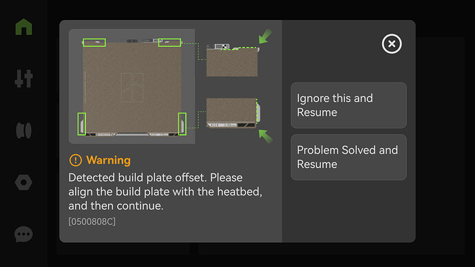

  • Added build plate position detection function
This feature detects whether the build plate is correctly aligned during print preparation stage by identifying features like heatbed limit blocks using the live view camera and toolhead camera. It prevents issues such as build plate interference, bed leveling failure, and printing beyond the edge of the build plate. The feature requires Bambu Studio version V2.2.0.68 or above.

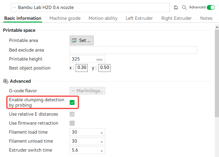

  • Added nozzle clumping detection (by probing)
This feature work in conjunction with nozzle clumping detection by nozzle camera, covers a wider range of printing scenarios. During the 4th, 11th, and 20th layers of printing, it detects nozzle clumping using the extrusion force sensor.
When performing the detection, the toolhead moves outside the heated bed, executes a downward probe touch, and then resumes printing. Any nozzle oozing during this process is absorbed by the prime tower to prevent print defects, for models with an existing prime tower, it will be reused.
For models without a prime tower (e.g., single-color models), a small prime tower is automatically created. This feature requires Bambu Studio version V2.2.0.68 and can be disabled in the print settings as below:

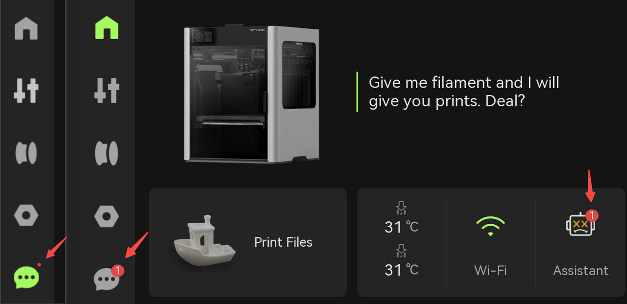

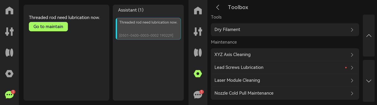

  • Added maintenance reminders for XY axis cleaning and lead screw lubrication
When the XY-axis and lead screws reach their maintenance interval, an HMS notification will be triggered. Component usage duration is calculated from initial activation. After updating to this version, certain components may generate reminders – simply follow the prompts. For detailed cleaning and maintenance guidelines, please refer to this wiki: H2D Regular cleaning and maintenance recommendations | Bambu Lab Wiki.

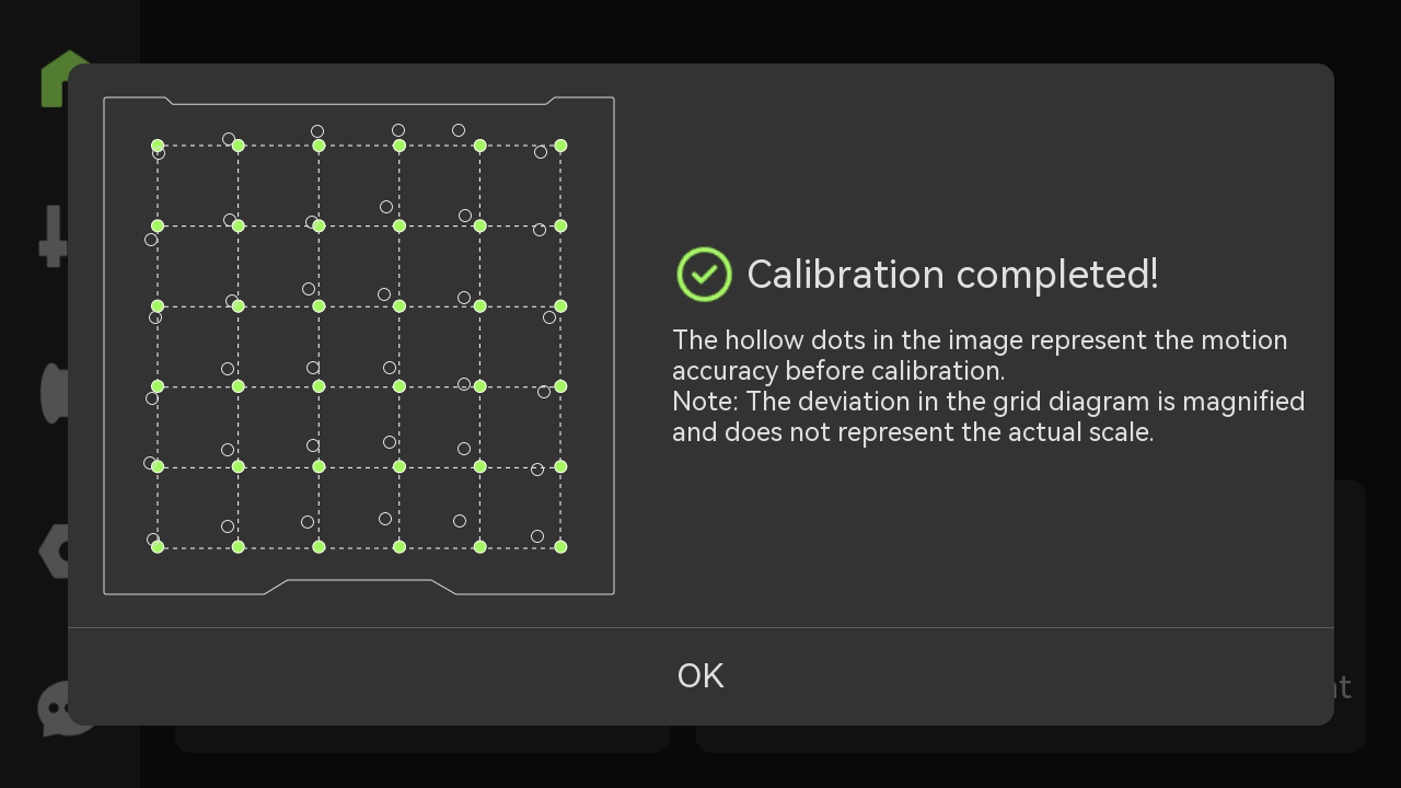

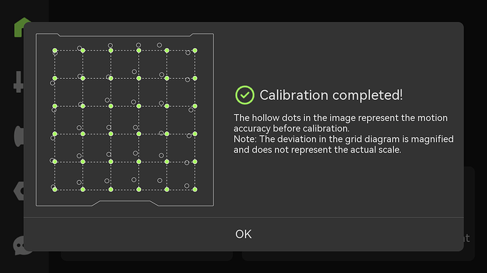

  • Optimized the result display of motion accuracy calibration function.
