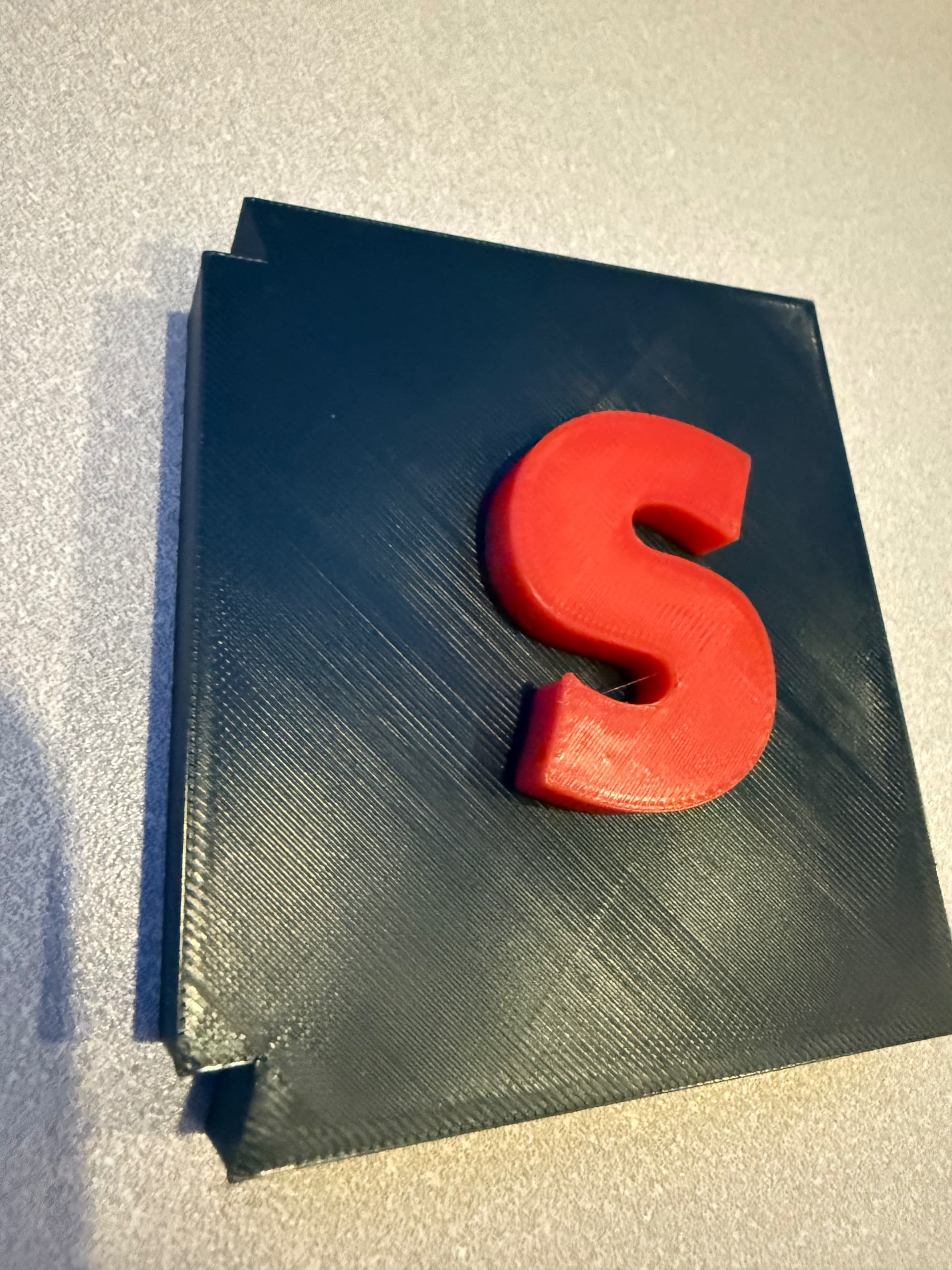

I recently got a H2D. It has been a great printer so far. Now I am getting odd rough corners on just one side of the printer. I have re-calibrated, tried cleaning and swapped filaments. Nothing fixed the issue. its on a 1/2" thick rectangle.
It is odd because I do not think it is a leveling issue because the first many layers are PERFECT. But when it starts to make the top layer it started becoming rough. Looking at the bottom I can see what appears to be a “pulling” up maybe? Attaching photos.
BOTTOM:
TOP
EDGES

Looks like warping. I guess its a fairly big part (close to bed size) and you mentioned a thickness of 1/2”.
This is a recipe for warping even with PLA.
Are all images of the same part? The infill in the 1st photo shows a different infill type, or is all the same?
Can you show a good side image of one of the corners, so the layer lines can be seen?
You can try to use mickey mouse ears or a brim with zero distance to keep it on the plate.
Other scenarios are to change the part an break the large surfaces so shrinkage has less influence on the top and bottom surfaces.

I guess the rim on the top is part of the design, but the irregular shape of it doesn’t look good.
You might want to try to disable the auxiliary and exhaust fan after the printing has started. Cooling on the H2 series is sometimes a bit too strong.
The size and shape of the part is also an issue.

Thanks so much for the replies, and on a holiday! That is a nice video. I am doing about 275mm x 150mm x 12.7mm (thick) rectangles but then adding text on top layer that is 6.35mm tall. So back to top of text is 3/4". While I was able to get them to print well before, I see adding some additional steps may help. In the video he appears to cut out large circles from inside the model that are then printed over for the top layer. I did not think you could do it that large. I was under the impression anything over 1.5mm or so would cause top layer issues. I can test with that and adding the bunny ears. Also with more testing I was able to easily replicate the issue of the top X layers starting to bend outward. It was the variable hight layers for some reason. Taking that away I get pretty flat sides, but the top looks much worse in terms of smoothness. Adding it back gives me smooth top but worse walls. Ugh… this has been a process. Have about 100 test print parts and still going.

Ok, so after more testing, playing with fan speeds and travel speeds as well as adding brims and internal cutouts on my plate I was able to get good top layer that stayed flat on bed. BUT the top layers still looks like it was “pressed” or “squished”. This is due to the layer height variable where I go from .2 to 0.08 .
Adding a shot of the setting. Is this a known issue? or is there a way to reduce it? I tried adaptive, smoothing, and manual. All created it in some form.
Why have you enabled variable layer height on this part. You can just keep the standard 0.2mm. I see no reason on the geometry you are showing, to use variable layer height.
Because of the top layer quality. If it use .08 on top it is nice a clean when I use .2 I see lots of lines on the top surface.

Looking at the image below, it feels like you need to perform a flow calibration.
Also the weird diagonal line perpendicular to the layer direction, needs some analysis in the slicer also.

It should not require a 0.08mm layer to get a good top surface.
I still believe some tuning should resolve this.
ok, if you think so, Ill go back to creating basic cube in Bambu Studio, with default pla settings and try again. Any ideas on particular settings to pay attention to?
Going with default generic PLA settings on a rectangle created within bambu using primitives with aux fan off and a brim does create a decent rectangle that is flat on bottom but has the eh, not so great top.
I could try 0.1 layer height for starters on entire model, but that seems to be a waste when I really only care about the top few.
turning off aux fan did seem to help with the top layer “waves” so I will keep that off.
I’ll keep a brim around entire model
and slow down the print speeds.
You could try a top surface calibration model to fine tune flow. Calibration Cards + Storage | Ironing & Flow Ratio - Free 3D Print Model - MakerWorld
Additionally, a smaller top surface line width may help, .3 top surface line width on a .4 nozzle is about as small as I would go.
