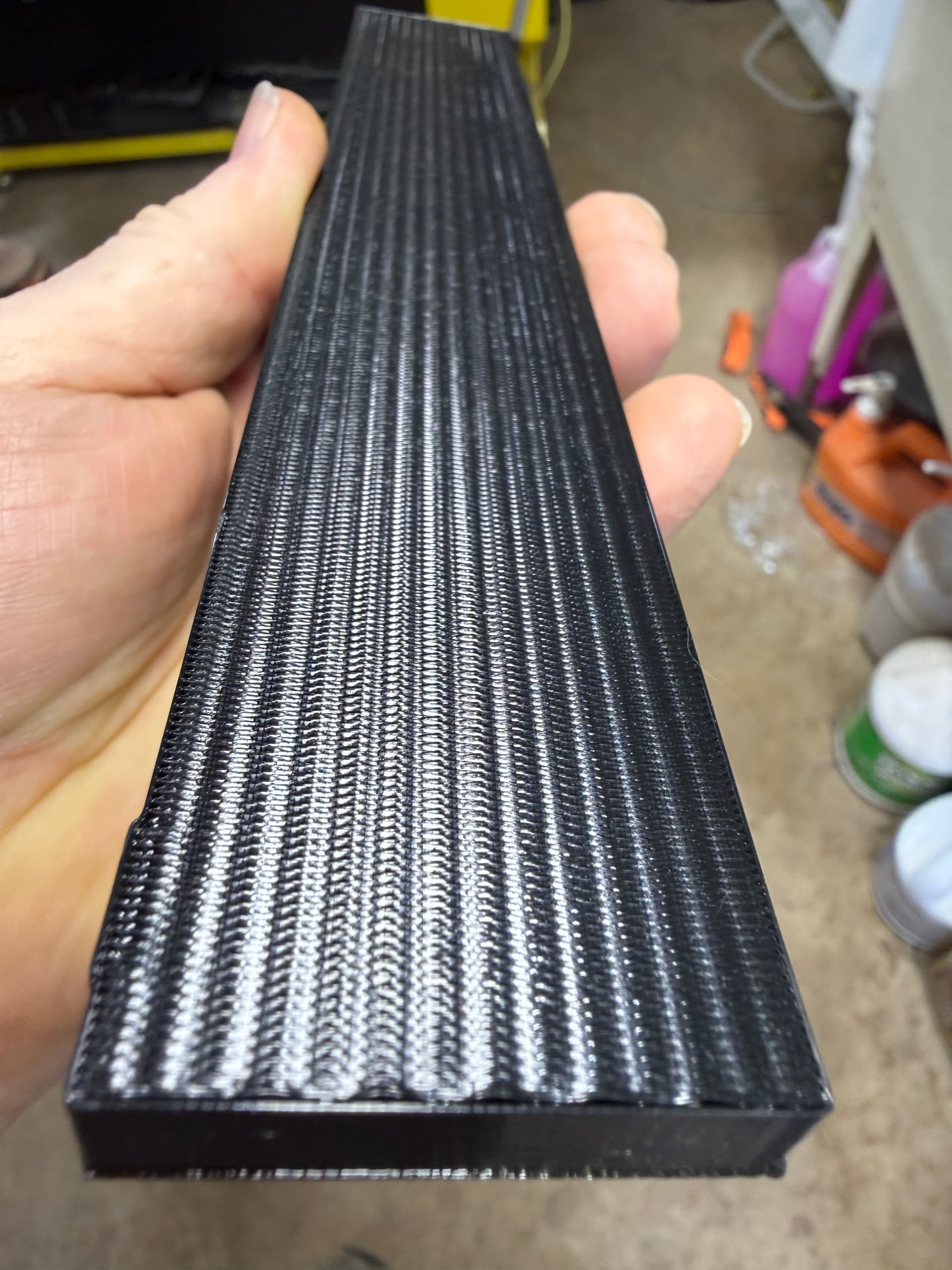

PETG works great as support with PLA, Clean breaks, but as I discovered yesterday, if you make the support as part of the design and have it so that it rests on top of PLA, it wont stick and will make a mess. You also have to go through the layers to make sure there is an actual raft created and not just branches supporting the PLA or you will get a rough surface. A flat interface makes a nice smooth surface.
An example is a cabinet I make that has 170mm wide drawer openings that are 20 mm deep, if I use generic support settings then it creates branches, then the PLA is layered on those and it leaves rough bumps. If I change the support settings, depending on model, and slice and review eventually I will find a combination that creates 2-3 layers of PETG, then the PLA is laid on that.

Heres a support I have as scrap from an item I make. The item is assembled and not here or I would show the inside of it. it used 26grams of PETG to support the entire structure and pops right out, it is printed inside the piece.
