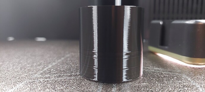

H2D Interesting behaviour / Bug? Layer Artefacts from Heatbed switching
Youtube Video

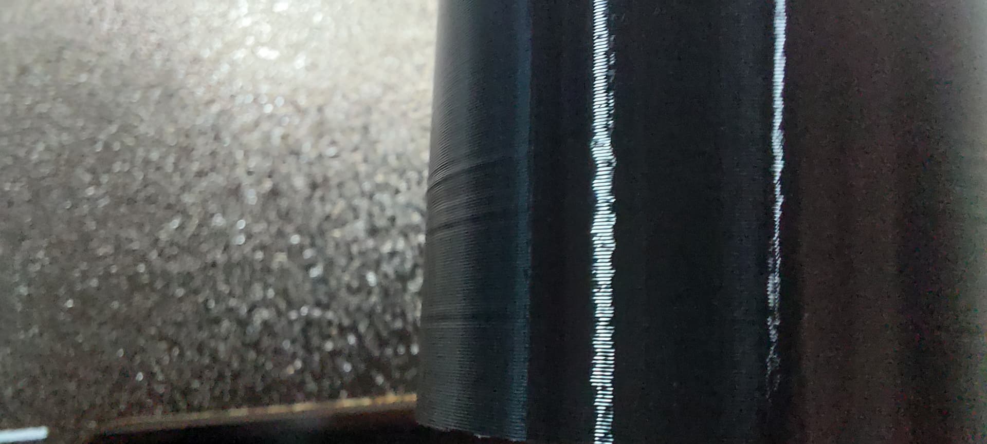

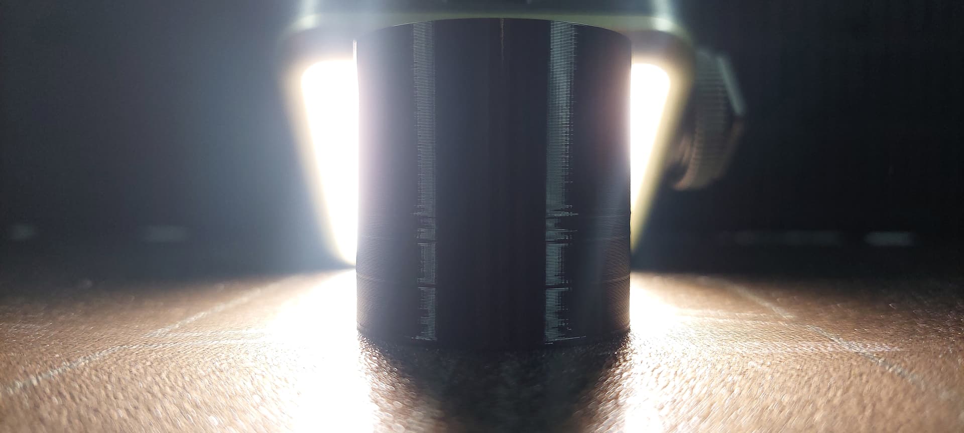

When i turn off the buildplate the printer changes the extrusion rate ? Or what ? Underpowered ? Maybe a Voltage problem ? I have constant extruder overload errors and going forth and back with customer support gained nothing but wikipedia links and “we cant do something sorry its planned for the future but we cant tell you more” kind of answers. I kindly requested to turn off the extruder overload function or atleast give me a checkbox for " Yes im shure what im doing please dont stop my print for some kind of firmware threshold " But maybe this is more a Supply Voltage or Current problem maybe on the toolhead or MC ? How can the Heatbed when its already on temperature influence anything about how the printer extrudes that what im trying to understand, anyone else seen this on theyr machine ? I already made very shure the extruder does not get overloaded even tryed topfeeding without PTFE resistance ect. extruder and channels are as clean as they can be machine is maybe 50 hours in.
I did not test if the heatbed cycling on and off during the print to keep the bed temperature stable cause any artefacts, i just saw this right now but maybe this also causes artefacts ? I have to test further … maybe someone want to jump on to this and test that on theyr machine just a first layer, it was PETG on 255° and 70° bed.
To me imho the heatbed off extrusion looked way better than with the heatbed on i dont know if it comes over that way in the video.

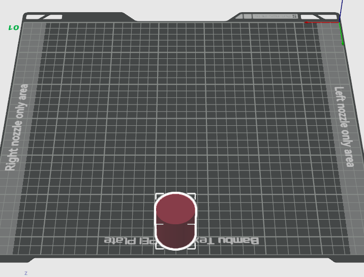

Maybe you can run one for me, could you create a cylinder primative, 3x (or whatever) it in height, print it in vase mode, then when it gets up an inch or so do your bed power toggle? Your current demo is a little hard to repro and is mixing in issues like the actual bed temperature (I know, very unlikely, that would be like instantaneous heating, but still) and z change due to heating.
And does it only happen with the left nozzle or both?
Youre right, i came up with a 3mf with custom gcode that turns the bed off and on in different way also heat to 100° ( wont reach ) and turn down to 70° to see the cooling cycle at the end there is a big section 0° vs 70° at the end. For now i only tested left nozzle, gonna test right nozzle now.
For those who wonder, who would turn off or on the heating.
Its sometimes better to exagregate ( right word ? ) something to see big errors to find where small errors lie, if its that hard visually it def. would cause smaller artefacts while the bed is cycling 69-70-72-68 ect. since i think this transistor controlled bed heating has some fluctuations that cause other errors in the machine atleast what i would guess when this happens on all machines hey, im out of ideas and fine with that guess my lemon will remain lemon then.
Cylinder.3mf (37,0 KB)
I have 2 other P1S printing on the same circuit, they show no visible artefacts while i turn on and off the bed on the H2D, i also concluded maybe its the circuit voltage being run down by the bed …

In detail, the errors look like its a different height ( squish ? ) or simply the extruder making thinner lines or thicker lines depending of if you set it to 0 or 70 i would rule out x/y motions imho maybe even Z because i cant wrap my head around why the steppers should step at fluctuations but hey im not that deep knowledgewise
So temporary conclusion for me is the power fluctuation from the heatbed is high enough to actually cause defects, i think this will remain as i dont see either me or bambu fixing this in any form of future and also i dont really test if the cycling causes defects i just wanted to make shure its not only my machine for my sanity.

extruder rate variation
hotend temperature variation (seems unlikely, effect is almost instant)
bed changing z position (seems unlikely, would produce a pulse, not a band)
x/y speed change

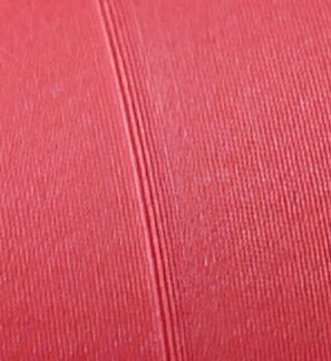

Here’s a chart of your bed temperature changes so you can match up the lines with a micrometer
mm # C
0.8 5 0
1.6 10 70
2.4 15 0
3.2 20 70
4 25 0
6.4 40 70
8 50 0
11.2 70 70
12.8 80 100
15.2 95 70
19.2 120 0
(note I didn’t adjust for your initial layer height of .2, but the error is small)

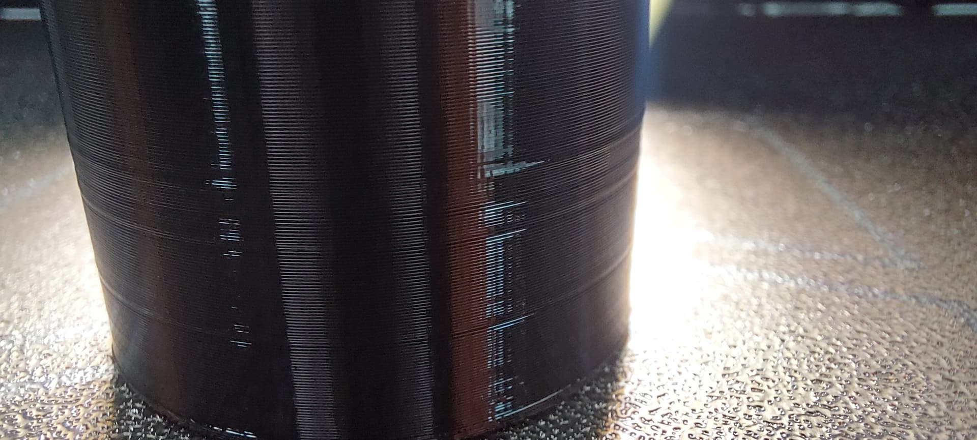

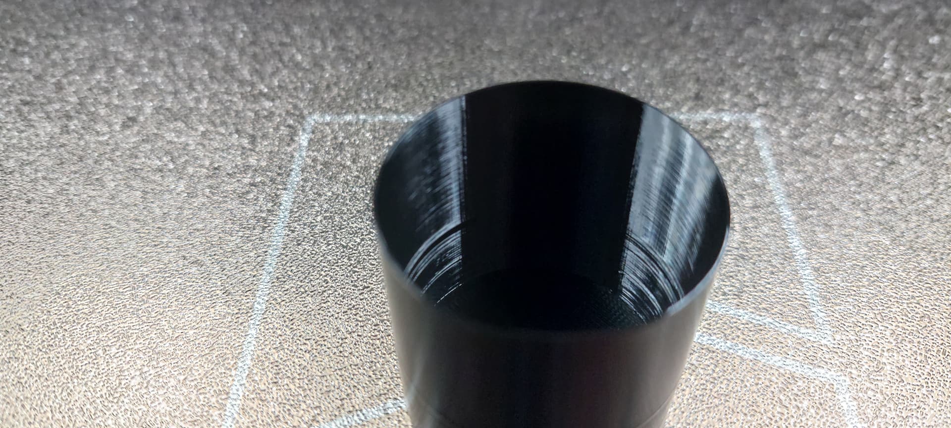

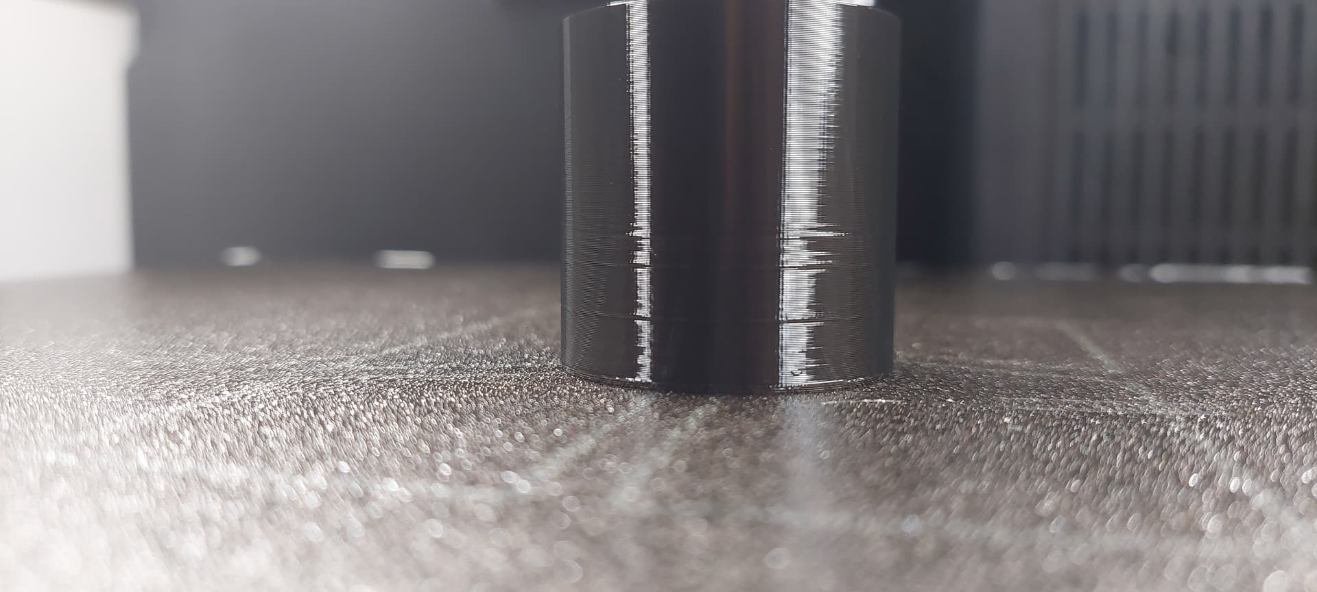

Ran a simpler test, 0 at 1/3 up and 55 at 2/3s. Layer heigh of .8 seems to exaggerate the effect at least in this test. No surface change I can see going from 55>0 (about 20 mins in) but a discontinuity going from 0>55 at 30mins in. It appears the layers are spread out, not squished, so the opposite of what I’d expect from thermal expansion in the bed pushing it up.
Layer time is about 5.5 seconds.
Towards the right is up, left side is 0 and right is 55.
I’ll need to take it into the lab Monday for a closer look at the topography, but looking at it with my microscope at home those big layers are single, unsquished layers and they are sunk down in the surface slightly, not bulging out. Right after (maybe 10 layers) there does seem to be an opposite bulge out.
Could this be the plate unevenly heating and flexing down in the center?
I’ll move the object to an edge and retry.
I moved it here and the pattern is fainter, maybe 2 or 3 lines, and it appears to be in the opposite direction (squish), and the 55>0 transition also has faint line, also just a line or two but it is in the stretch direction. Both lines aren’t very strong, but they are quite sharp.
So this is suggesting something more mechanical. Note in the 55>0 direction the plate cools quite slowly, maybe 1/3C per second, what is magical about 55>53 that makes a sharp feature?
