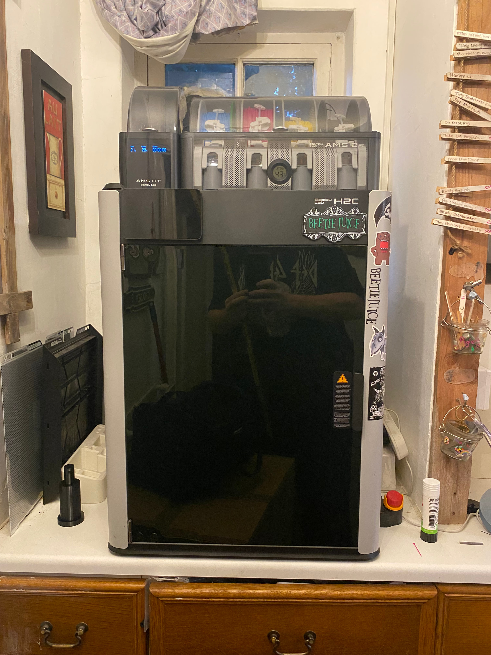

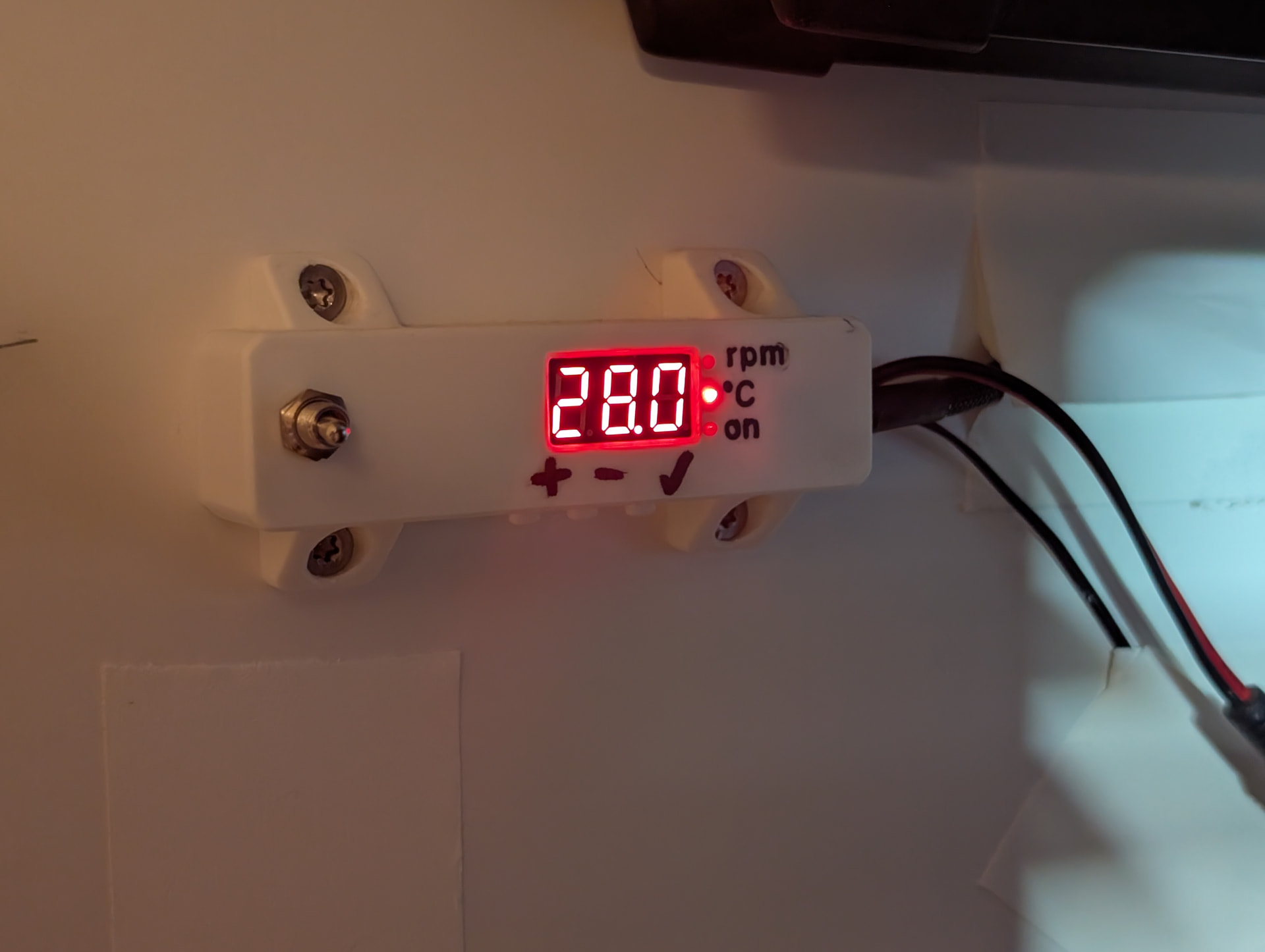

I have an X2D in an IKEA PAX cabinet that is 1m wide and 60cm deep. For the X2D that is just deep enough in my opinion. It needs some space at the back for ventilation and I really need a few cm in front for putting down tools, filament rolls, and such stuff. I’m also drying filament in an AMS HT in the same compartment. For ventilation, I made a cutout in the rear, put on a 120mm silent fan with a temperature controller. Behind the cabinet there are maybe 3cm gap to the wall. So far that was sufficient for me even when drying PC at 85°C or printing it.

Here are some pictures of my setup. The printer also sits on 90kg kitchen rails with the board strengthened with aluminium extrusion at the bottom. I usually print with doors closed, that has a huge impact on noise. I only pull it out for changing filament in the lower AMS2 and for maintenance.
If the depth of the unit is a concern I would say that the X2D is not going to give you much relief because of the components on the backside of the X2D printer and the need to keep the PTFE tubes from bending at small radii. I have 63cm from the back wall to the front edge X2D display.

Please allow for air cooling gaps when you size your printer cabinet, or throw a fan in there.
Oh, and another thing, you should consider: the printer produces some poop at the back, so you want to direct that somewhere. Most common are slides to a bucket on the side of the printer. You can also cut a hole in the drawer and put a bucket under it. But you don’t want it to accumulate freely behind the printer.
I think you will struggle to fit and use the H2D on that space especially if you need to allow room for the kettle lead into the rear and allow suitable room for ventilation of the fans as well as poop shoot, thats before any fitting of AMS or side spools. I’ve managed to fit mine on a 600mm deep shelf but only just and thats with using the slimmest addons at the rear as well as minimising tube length without causing sharp bends, here are some pics of my H2C lazer install if that helps. You may save some space on the right without the emergency power button, but personally with the space avalable in your drawings the X2D would be the sensible option in my opinion.

What kind of brackets did you use so your X2D can roll out?
Thanks :blush:
For the printer, I used heavy duty kitchen rails. Exactly Blum Movento 70kg. For the board, I used the existing Ikea Pax shelf, shortened it and reinforced it with aluminium square extrusion bars.
The most expensive part were the rails for the upper AMS drawer. Usually rails are not at all specified for horizontal forces. Due to the lever, horizontal forces are higher than the vertical forces. I found some special server rack rails by Accuride that are at least specified for 25%.
