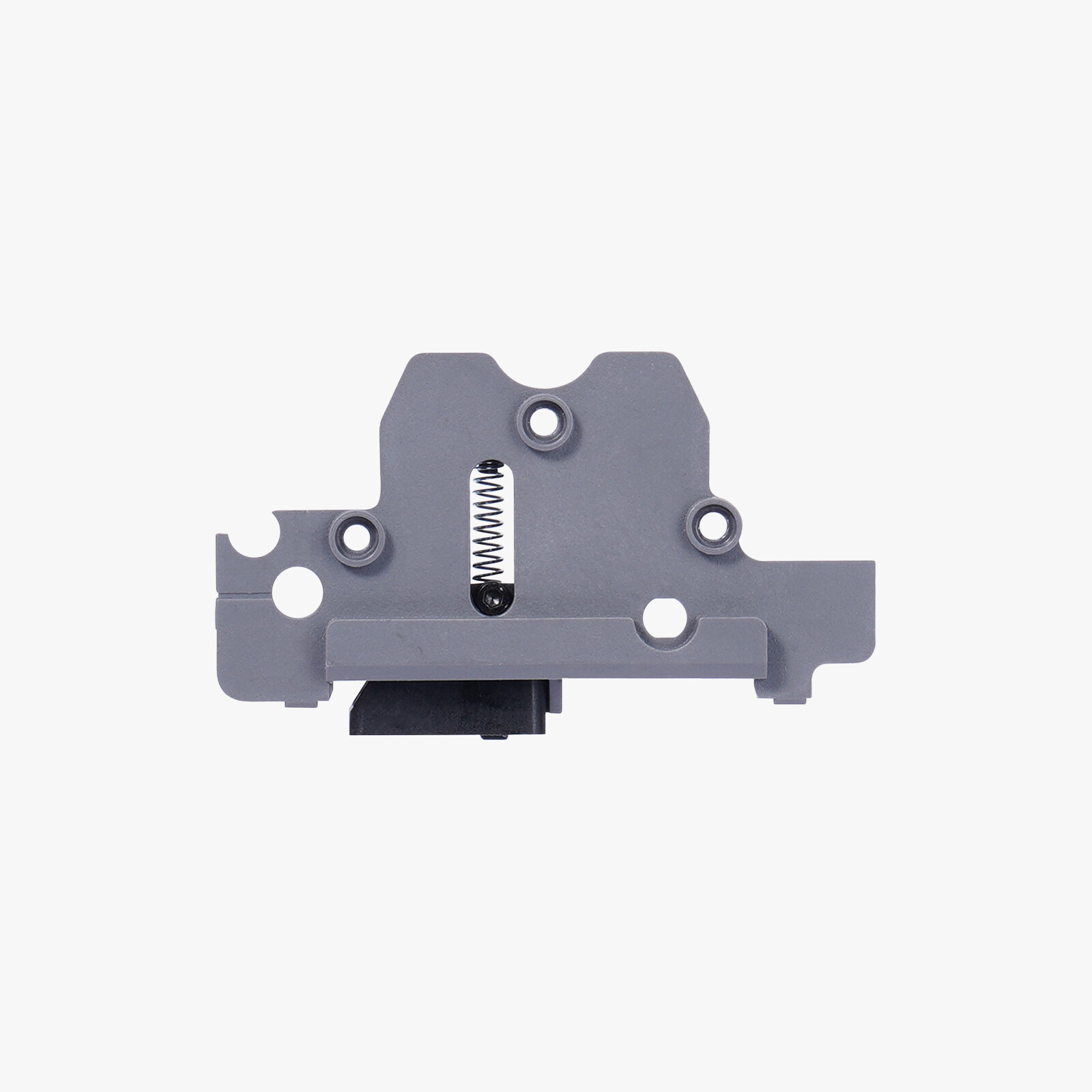

The left hotend isn’t heating up at all now; I submitted a ticket to support and the wiki page they recommended doesn’t exist. A secondary symptom is that the blocker can’t move smoothly and raises errors when I try to print with only the right side. If I poke the left hotend a bit and hit retry, the blocker moves fine and the print moves on.

I would check this item and clean the sliding bar for the left nozzle, sounds like it can be dirty.
Thanks! I’ll put that on my checklist.
