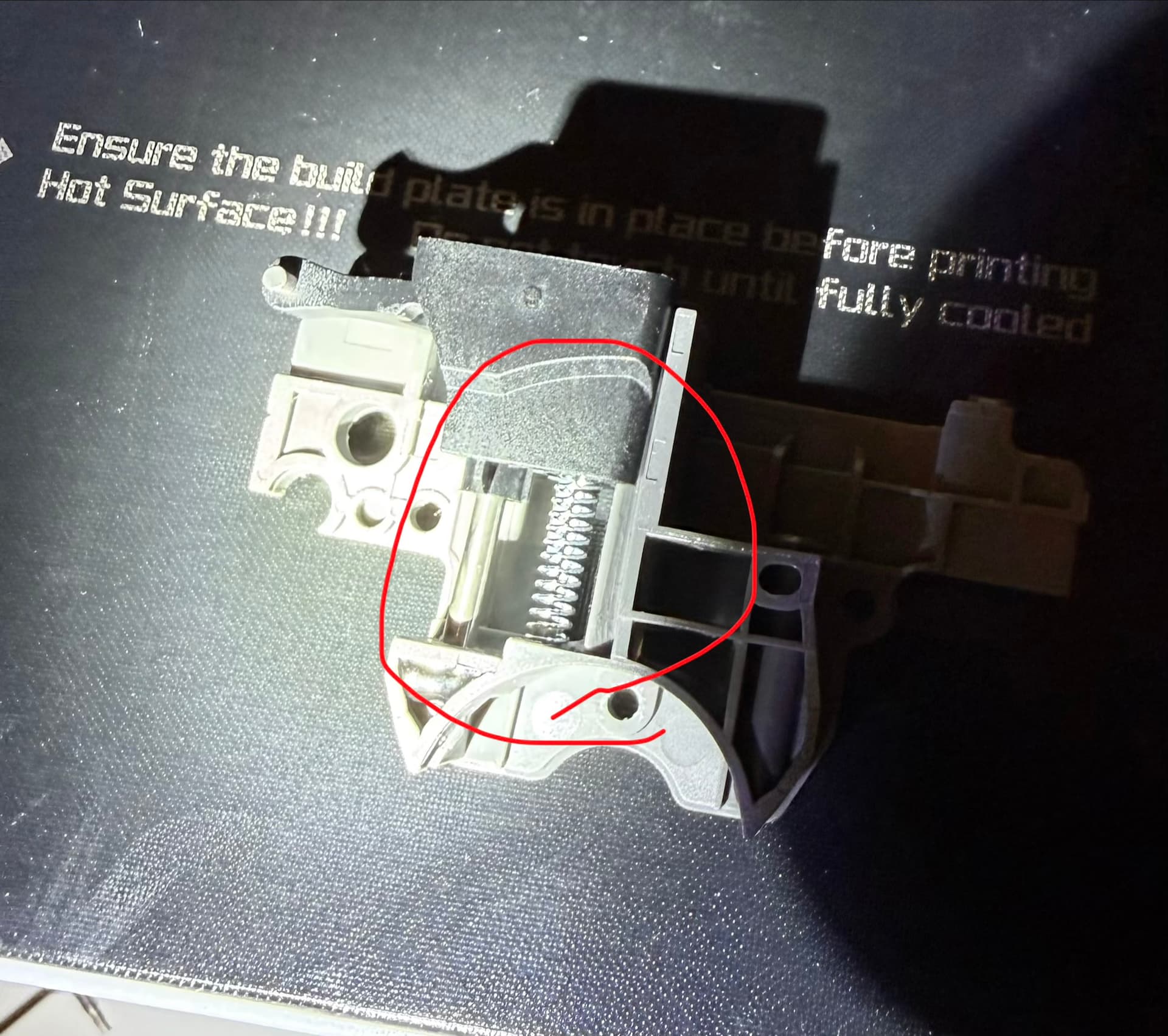

I started with two Prusa printers, and the H2D is now my first printer from Bambulab. Today I was prompted to perform my first maintenance, so I went through the manual step by step (H2D Regular cleaning and maintenance recommendations | Bambu Lab Wiki).
When I reached Step 6 (Clean the toolhead), I done my work very carefully, since it was my first time doing this kind of cleaning.
  • Removed the right and left nozzle
  • Removed the front nozzle assembly and filament guide
  • Cleaned and lubricated everything

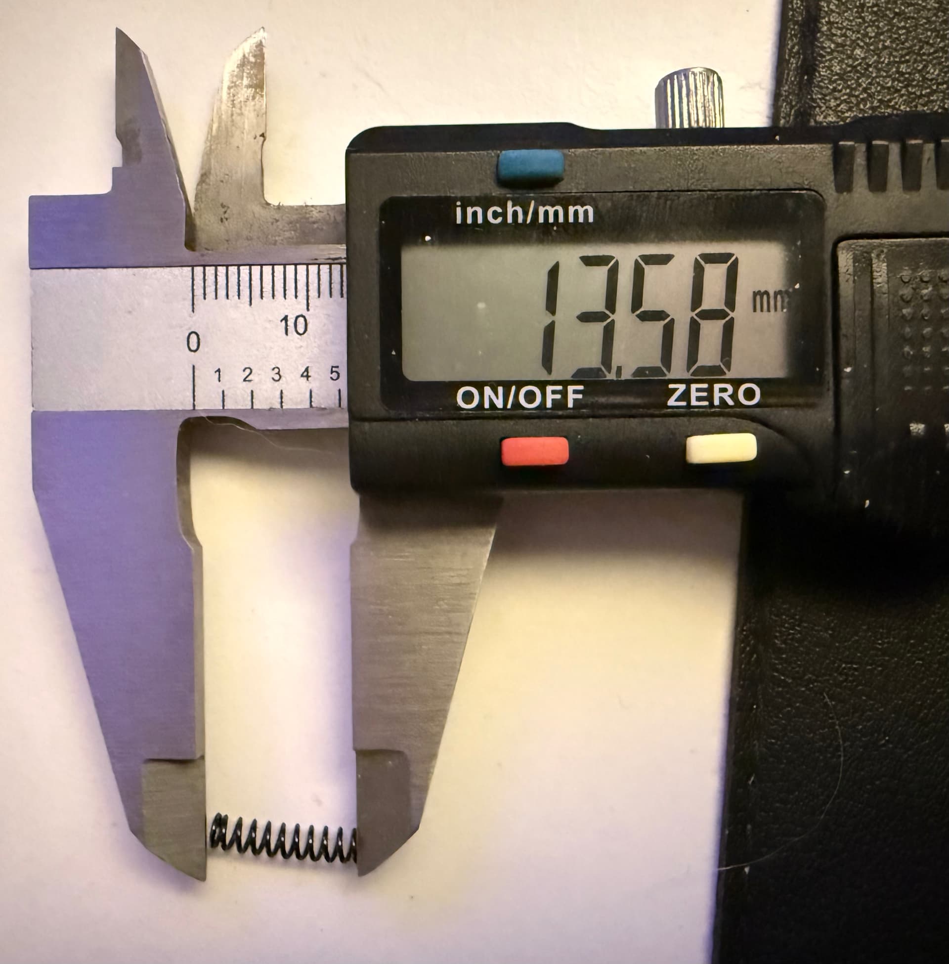

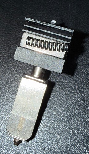

After putting everything back together and trying to reinstall the nozzle, it wouldn’t fit. After a couple of seconds of confusion, I noticed that a spring was stuck to the magnet on the back of the nozzle.
But I never removed a spring.

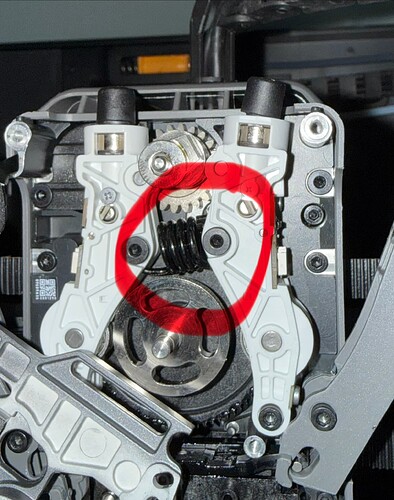

I immediately checked whether the spring on the filament guide was still in place — and it was.
I then reread the entire manual, looked at the pictures, and watched YouTube videos showing a complete teardown of the toolhead. Nothing. This spring was nowhere to be seen.
So now I’m hoping you can help. Do you know where this spring belongs?
Here are a few photos I took — maybe they will help.
Thanks in advance. :slightly_smiling_face:

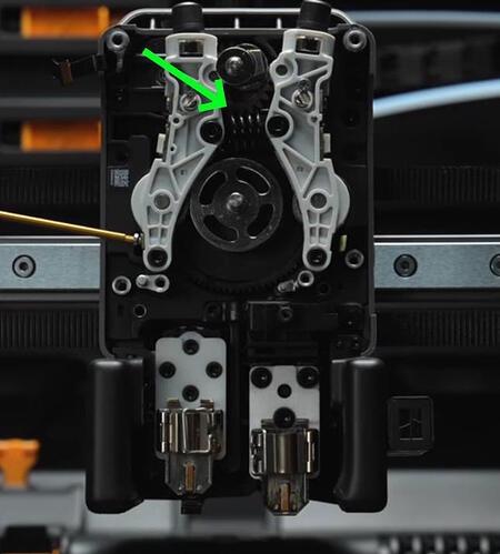

It looks kind of like the spring you can see at 7:35 in the video.
Thank you for your reply, but unfortunately that’s not the spring.
I have that one, as you can see in one of my photos (the one with the red circle).
I guess it is this one.
No, that’s not the spring. The spring you showed me is much larger and thicker than the one I showed you. The spring is still where it should be. Too bad. Thx

It could simply be an extra spring left in the machine (from a tool) on the production line but by experience it could also be one of YOUR spring that got there :slight_smile:

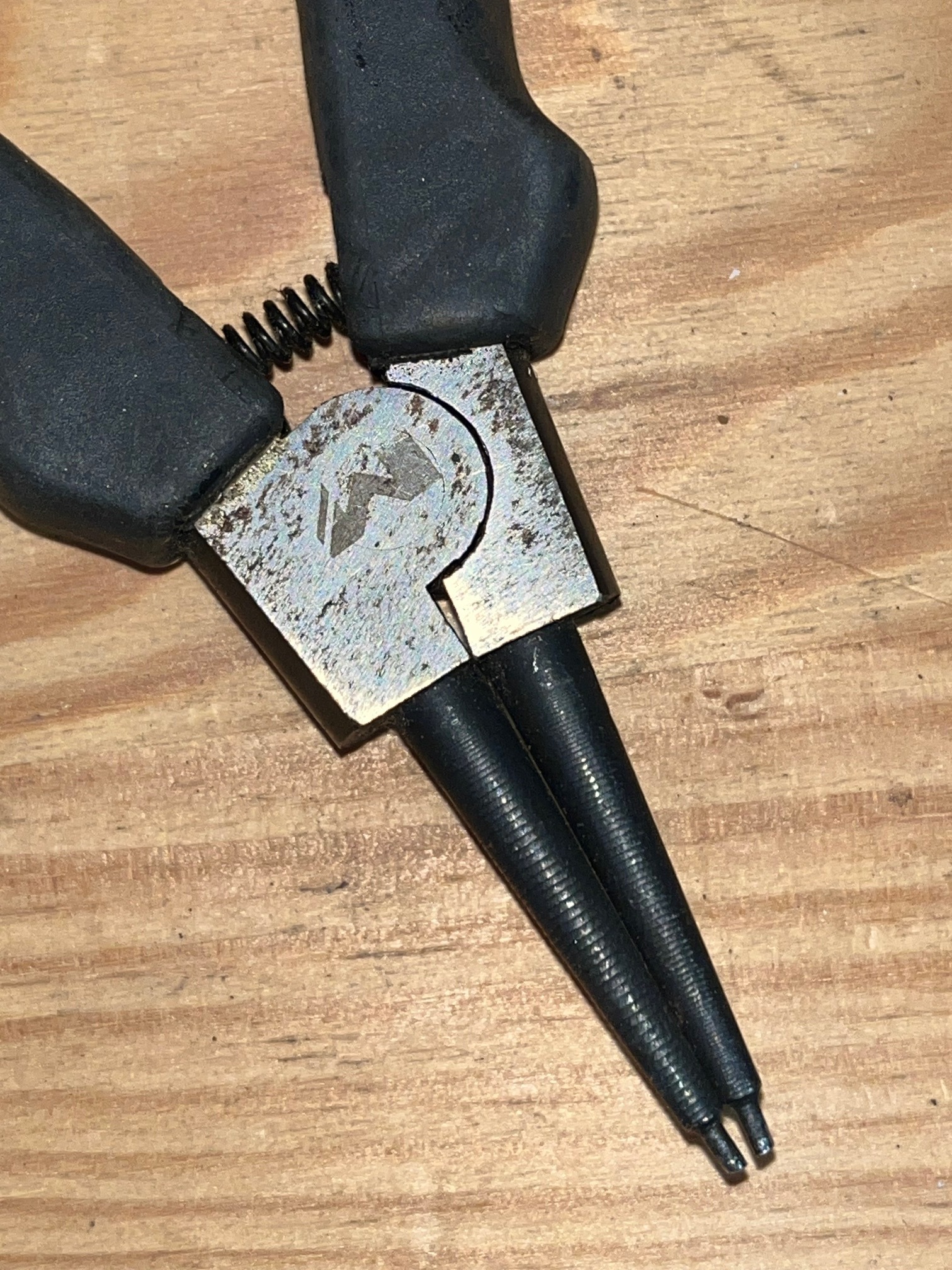

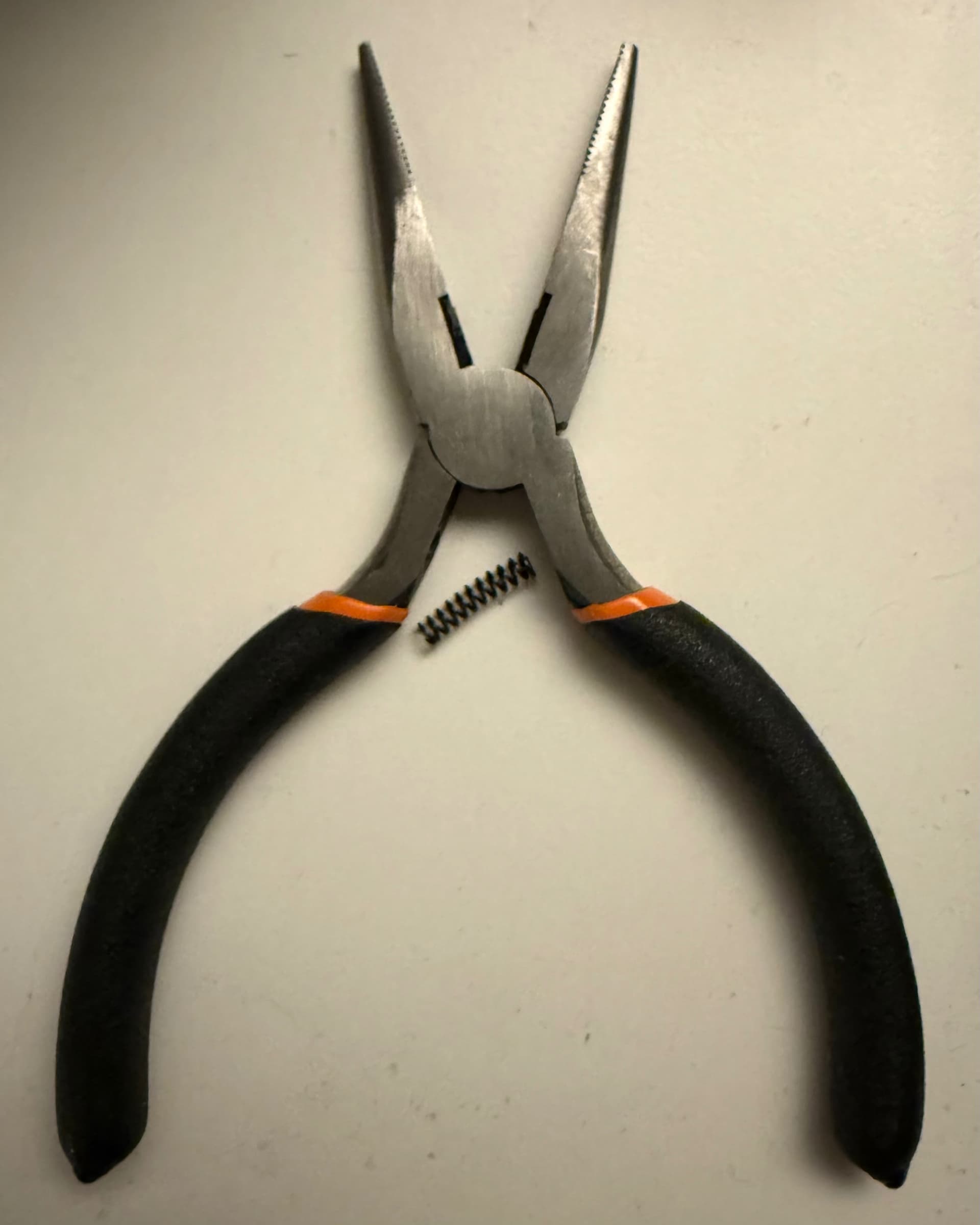

Given the slight curve of the spring, it looks a lot like the return spring of a pair of pliers, aren’t you missing one (or BL may be missing one :slight_smile: )?
Oh no — that’s the solution, and I really didn’t expect that at all.
The problem turned out to be the spring from my small pliers. Thank you very much, @philch.
I’ve been sending everyone on a wild goose chase, and in the end it was something so trivial — it simply never crossed my mind.
A big thank you to everyone who helped think this through with me!
But I were pretty close, that the spring didn’t belong to the printer :joy:
Yes, you were very close :slight_smile:
By the way, here are the pliers that started it all.
