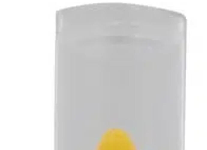

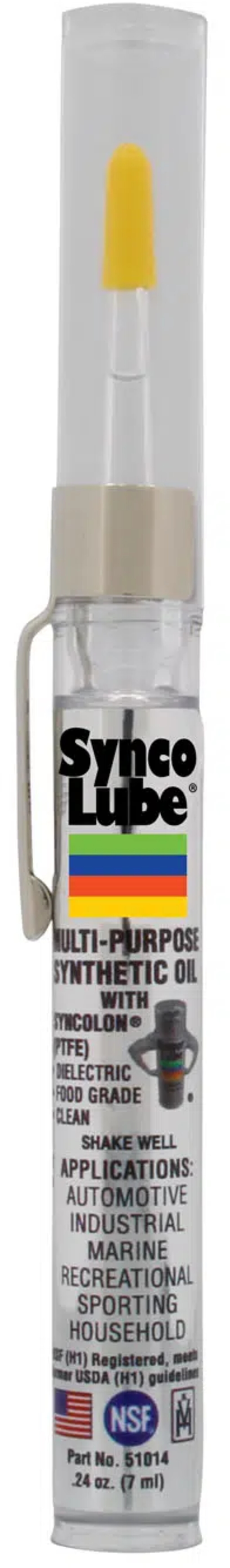

Hi everyone, I was doing maintenance on linear bearings and polished rods as H2D requested, and I’ve been thinking for a while about replacing both the oil and grease with something better, namely these:
Has anyone used them? Can you recommend them?

For oil and grease, I use Super Lube products.
Super Lube 51004, Synthetic Oil, High Viscosity, 4 oz Bottle, Translucent White (Packaging May Vary): Fishing Equipment: Amazon.com: Industrial & Scientific
Amazon.com: Super Lube-21030 Synthetic Multi-Purpose Grease, 3 Oz. : Super Lube: Industrial & Scientific
Also, buy a similar bottle to this for whatever oil you choose. This was a game-changer vs all the printed options. I can oil the tiniest places from any angle or orientation with these.
Amazon.com: Hicet 2 Bottles -1 OZ Size Bottles with Stainless Needle tip for All Your Gun Oils : Sports & Outdoors
I use both oil and grease from Super Lube and have never used any other brand.
Maybe consider Super Lube 52004 instead of 51004?
…according to Reddit threads it’s better than 51004…
Just ordered 52004 (along with 21030) to test it out myself.
