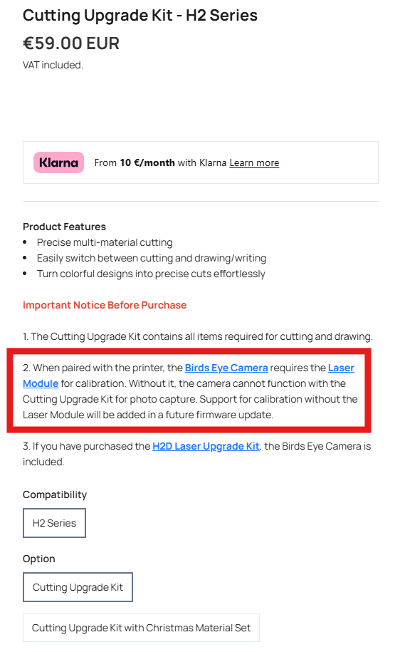

I think the biggest issue, at least in my opinion, is that BL states on the cutting module upgrade page that the BE camera is required, when in fact it is not.
Yeah I have an H2D and was interested in the cutting module, but I held off because Bambu’s site states that they are coming out with a firmware to make it and the birdseye camera work. The wording on the site makes it seem that you need both cutter, birdseye camera, and firmware, but I guess that’s not the case. Good to know!
Hey @JupiCroco where did you see or states that BL is coming out with a firmware to make the birdeye camera work?
I too and hoping this is the case and would like to see some progress that is the case!
It’s on the Cutting Upgrade Kit product page. I’m surprised it has taken them over 4 months now to add this feature. All this time I’ve not used the cutting module because I don’t find it easy to use without having a preview.

It should be available in the next major firmware update, which is expected to come early next year.
