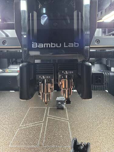

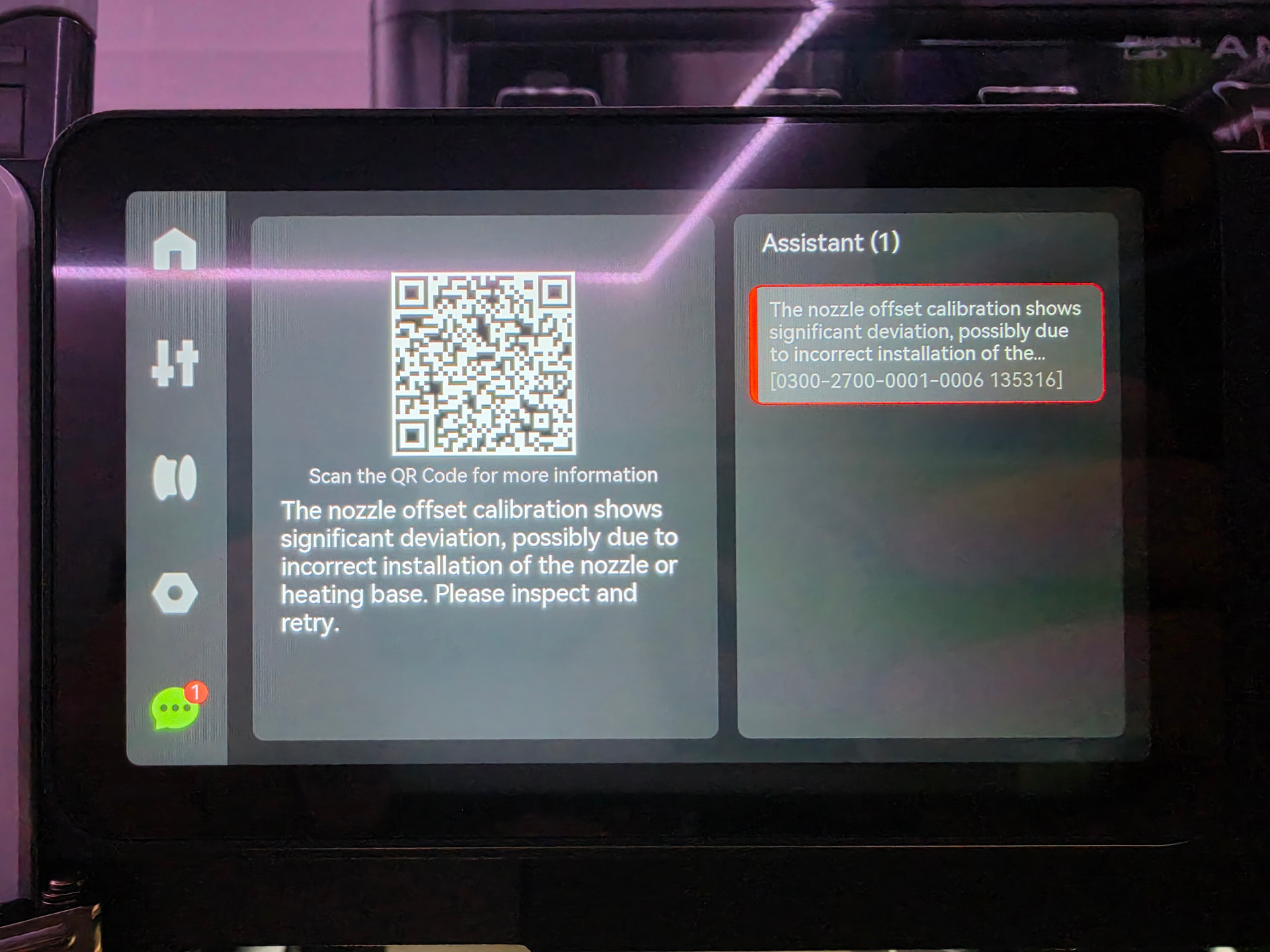

My left nozzle was having temperature malfunctions and, go figure, it was 2 weeks past warranty. They cannot help me but tell me I need to buy a new leftend assembly and install it. I get it, I follow it to a T, and go to calibrate the printer. Now it is failing the nozzle offset calibration due to a deviation between nozzles. I followed every instruction on the wiki for a fix, reinstall twice, and tried every tip I could find on the internet, and nada. Anyone else have this issue and come up with a fix? Nothing looks wrong at all. Nozzles swap, go up and down no problem, heat up correctly. I truly am at a loss and don’t want a $3k paper weight

It was working. Did a vision encoding calibration, and then a full calibration and it is failing the nozzle offset part again

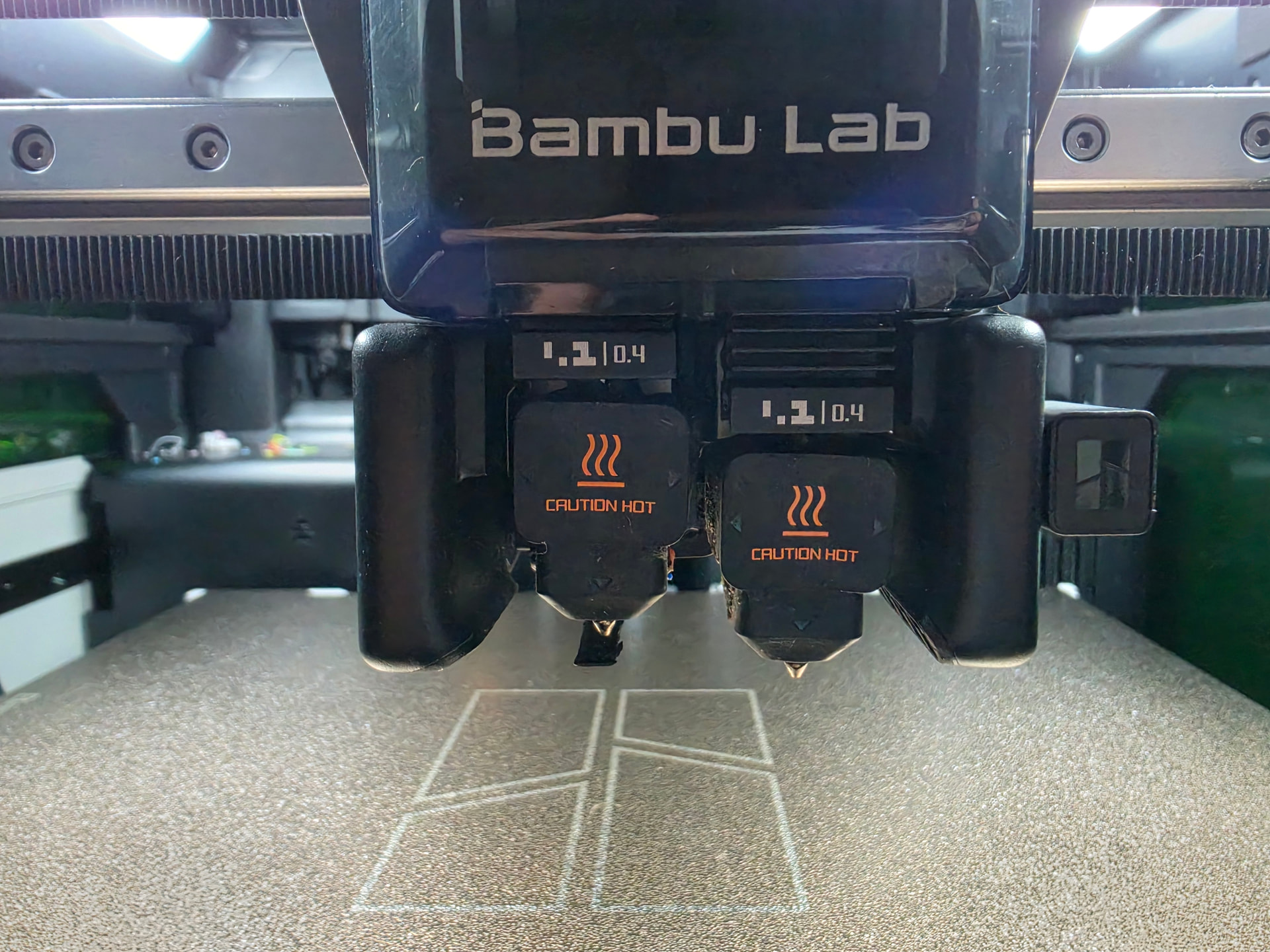

Detailed pictures and hours on the machine
it says 2943 hours but I just leave it on when not in use. Nozzles are fully seated. Filament can be extruded out of both of them

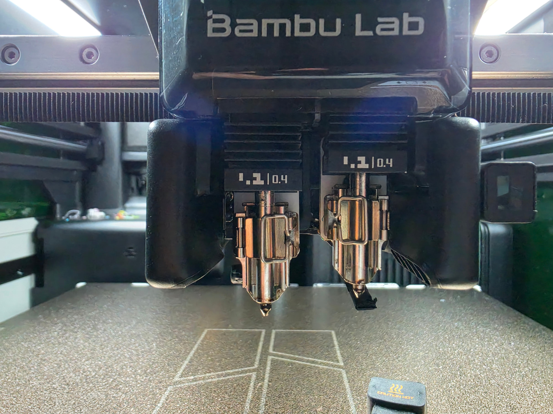

Left nozzle looks to be bent? Can you try a different nozzle.
Did you take pictures while you changed stuff? More pictures, at least some without the left nozzle installed.

you installed something bad. check it asap to avoid damages… if you remove the hot end you should see if there’s a deviation
