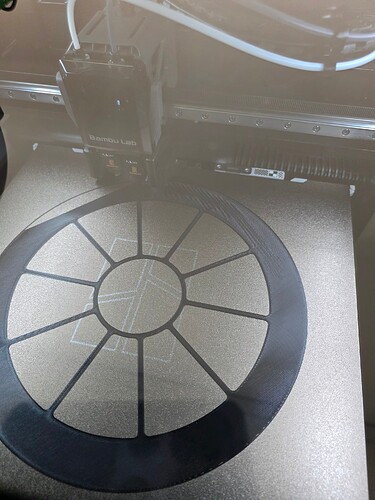

So I did my first almost-full-plate print of some simple dual color plates. The bed leveling seemed to take longer than usual and I noticed that after it purges and does the leveling there’s some oozing that results in a small blob on the nozzle.
However I figure that would make the nozzle too far away, not too close. It’s both nozzles as well. The first layer was getting more and more squished the closer to the back of the bed, resulting in less than perfect print results where the two colors meet.
The parts toward the middle and front of the bed came out flawless. Any ideas? Material is ABS

Update - still doing it. You can see the telltale wrinkles in the first layer at the top

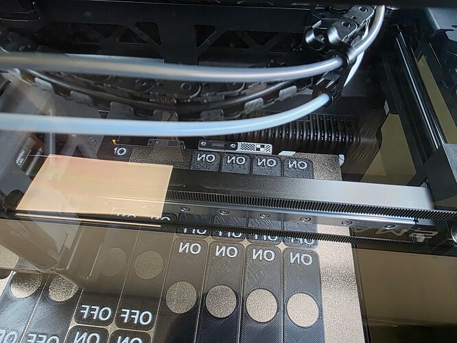

I’m having the same issue … Less than 50 hours of print, observed that the rear side of the plate is having the nozzle too close to bed.
