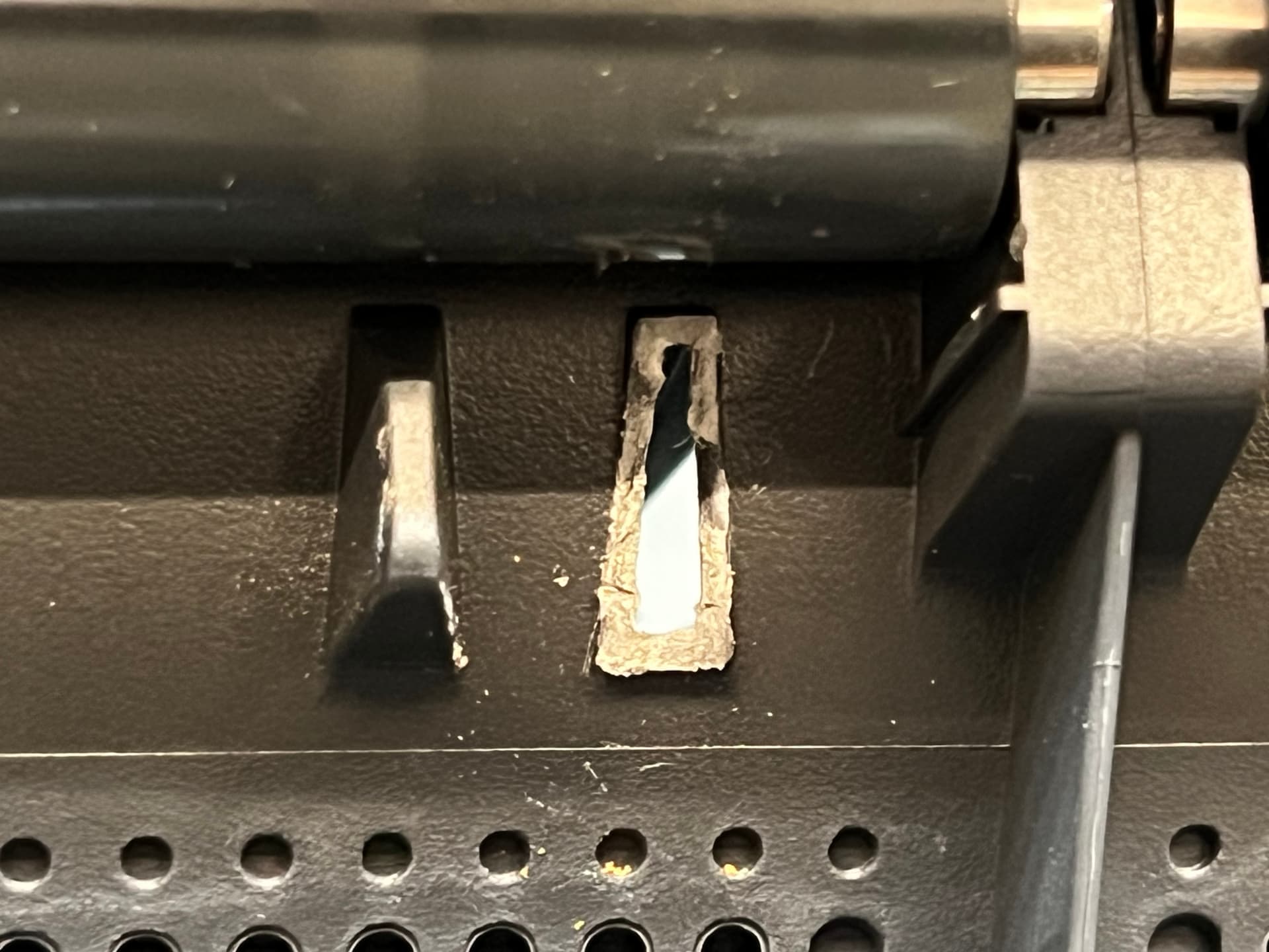

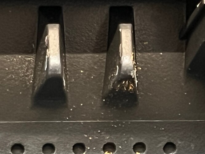

I have found that on slot 3, in the back there are two spool guides, the right guide was creating a lot of dust, grinding away at the spool. I cut the guide out. Next point of contact when the AMS reports motor overload, appears to be the spool rubbing the side of the slot. I have mounted a bearing so the spool rubs the bearing. Big reduction in rolling friction after those two changes.

In my opinion it does not take much added friction for the printer to warn motor overload. I only note little things like the spool guide rubbing. After I cut the spool guide as show above, I have complete two 5 hour prints, whereas before it warned motor overload 3 to 5 times a 4 hour print.
Spool side roller bearing mod
