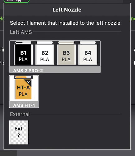

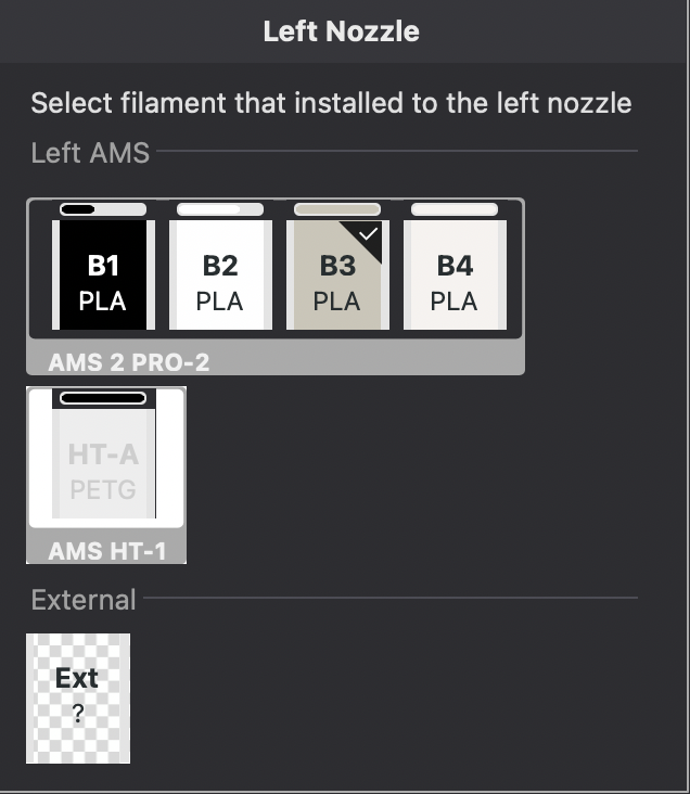

I’m trying to run PETG-HF for the first time on my H2D with dual AMS Pros + an AMS-HT feeding the left nozzle through a 4-in-1 splitter. AMS-HT is online and shows up normally, but the PETG-HF filament is greyed out in Bambu Studio when I’m about to send it to the printer.
Swapped the filament in the AMS-HT to regular Bambu PLA, and it immediately became selectable. So the hardware, mapping, and AMS chain are all working — only PETG-HF won’t let me print. Looking for insight into why PETG-HF is flagged as unavailable on a hardened-steel left nozzle.
All parts in the printer are stock, OEM nozzle - hardened steel 0.4 standard.
Please check the filament assigned to the model you are trying to print is PETG, my guess is it’s PLA, which is why you can only select those.
I’d second that, it sounds like the print profile is set to PLA, so when you come to print it will only let you select PLA, graying out the other filaments.
In the prepare tab, change the filament in the middle left section to PETG, you probably need to sync the printer settings back to studio app, or perhaps you just opened someone else’s project file, from maker world for example. It contains there profile settings, likely they saved it with PLA as the print choice.
Thank you both! You were right - and I am new to PETG, so I didn’t know that.
