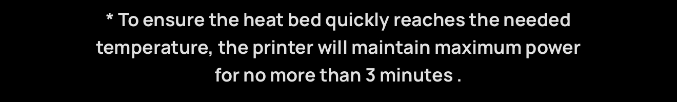

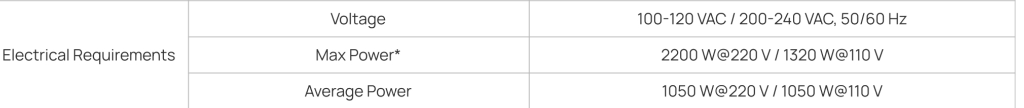

The 1320w rating is the maximum power rating, so it is in fact overshooting. The average power rating is 1050w.
The asterisk represents this statement.
The maximum power draw of the unit should not be exceeding 1320w.

According to Bambu Lab’s official specifications, the H2D is rated for a maximum power draw of 1320 W at 110 V, with an average power consumption of 1050 W. This maximum value refers to the intended upper limit of sustained power usage, not an absolute ceiling that the device can never momentarily exceed.
In engineering terms, published “max power” ratings typically represent the design envelope for continuous operation, not transient startup conditions. During warm-up, especially when the heatbed, hotend, and chamber all begin heating simultaneously, it’s entirely normal for the system to draw a higher peak for a short period — e.g., 1600–1650 W for 30–90 seconds. That does not contradict the spec; it reflects normal dynamic load behavior and is accounted for in PSU design.
So the specification is not inaccurate — it simply reflects the manufacturer’s guaranteed continuous operating limit, not a transient limit. Short-term peaks are expected in systems with resistive loads, and virtually all manufacturers handle this the same way.
However, on 120 V systems, such peaks can approach the practical limits of a standard 15 A circuit. While the breaker supports up to 1800 W, NEC guidelines recommend not exceeding 1440 W for continuous use. A brief spike to 1650 W leaves minimal margin and may trip the breaker, especially if other devices are on the same circuit. In those environments, power planning becomes more important — but this is a limitation of the electrical infrastructure, not a flaw in Bambu Lab’s specification.
The 1650w we are seeing is sustained for the bed heating. Even without heating anything else. It’s not just a peak. It is this wattage for the entire bed heating process.
Maximum means maximum. It should not exceed this value under any normal circumstances.

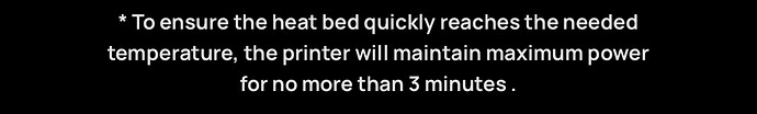

The asterisk photo I posted seems pretty cut and dry to me. “The printer will maintain maximum power” (1320w according to the spec sheet). It’s maintaining 1650w, not the 1320w it says it should be maintaining.
It’s not a flaw in their specifications, I agree, but it is a flaw in whatever operation they use to heat the bed and what tells it how much power to draw.

I totally agree with this. I don’t think you’re understanding that the 1650w we are seeing is the actual maximum sustained power draw under normal, full operation. The machine is sustaining 1650w for the entire bed heating process. Not the 1320w that is spec’d. It is not just a momentary peak and then drops back down.
I firmly believe they did intend to do this, but missed the mark somehow. None of their other printers exceed the maximum power rating, why would it be considered normal for this one?

So what you’re saying is that your machine only draws and maintains 1320w to quickly reach temp? The spec note refers to the max power draw during bed heating as 1320w.
No, that’s not what I’m saying. I’m saying that brief periods of higher power draw during heating — even above the listed system max — are common and expected for resistive loads, especially when only one subsystem (like the bed) is active.

If you’re right and this is normal, then Bambu needs to change their power requirements specs to reflect the actual max power draw. It is very misleading. I haven’t once seen 1320 watts in any scenario, so I’m wondering where they even got that figure. I’ve seen 200-300, 850-900, 1400-1500, and 1650. But never 1320 or anywhere close to it.
I believe you about wattage draw exceeding spec during initial spikes, but I don’t believe that the bed heating is a “spike”. It is a normal working condition that can last up to 3 minutes, which should align with the maximum power draw spec since it is a normal working condition.
