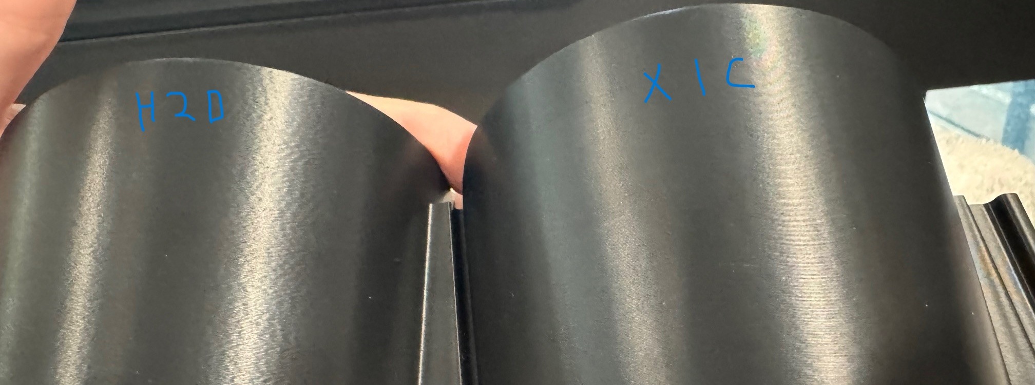

I am primarily printing Bambu ABS and have been troubleshooting various things with my H2D to get it as dialed in as my X1C and have yet to be able to produce results with as good of quality.
Over the course of the last 3 months, I have done nothing with my H2D except make unusable prints and/or troubleshooting prints without arriving at a resolution.

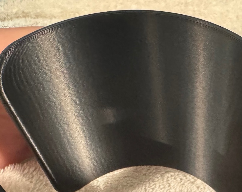

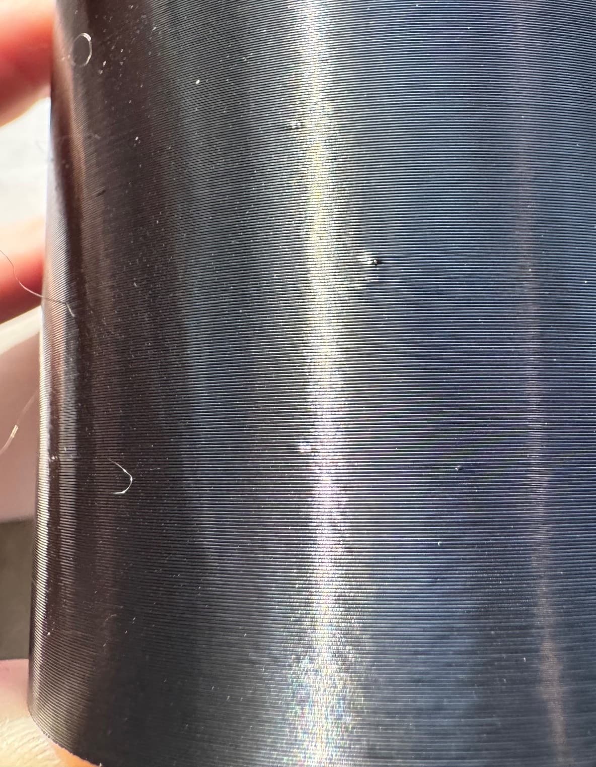

In particular, I have noticed excessive surface undulations or ringing in the X, Y, as well as some pock marks in the parts which I do not have with my X1C. In addition, the surface shininess is either shinier or more matte than the X1C, depending on the layer height.
The pock marks seem random, but the ringing is fairly consistent unless dropping to very low speeds.
I can take the same spool from the H2D and put it into the X1C and get better prints.

The blobs on the outer wall indicate that you are running too hot. You could increase the volume velocity or lower the temperature.
