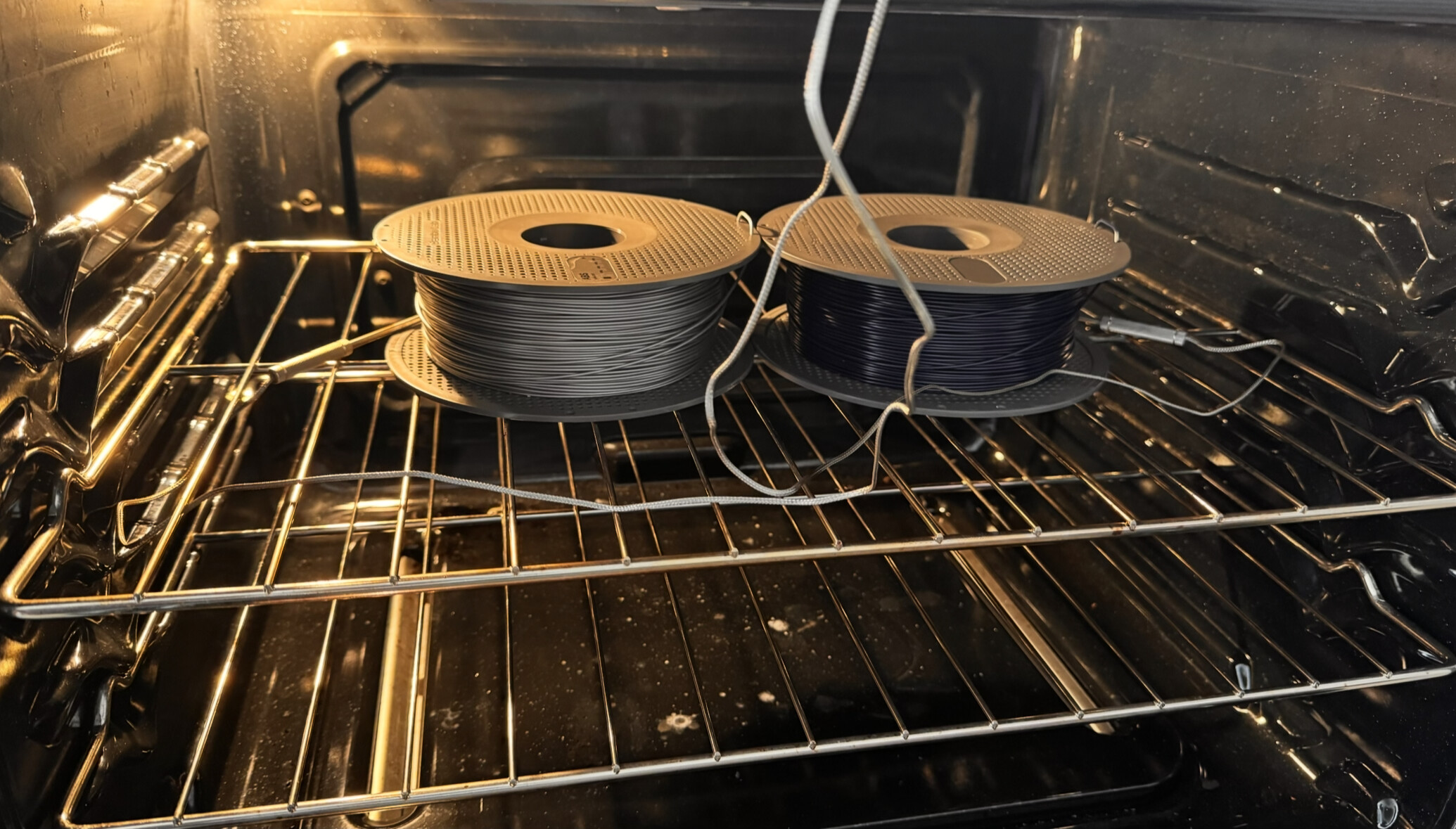

Watch it close, though. Some have had their spools get too warm and ruin filament. Some stoves don’t regulate so well.
But looks like you are.

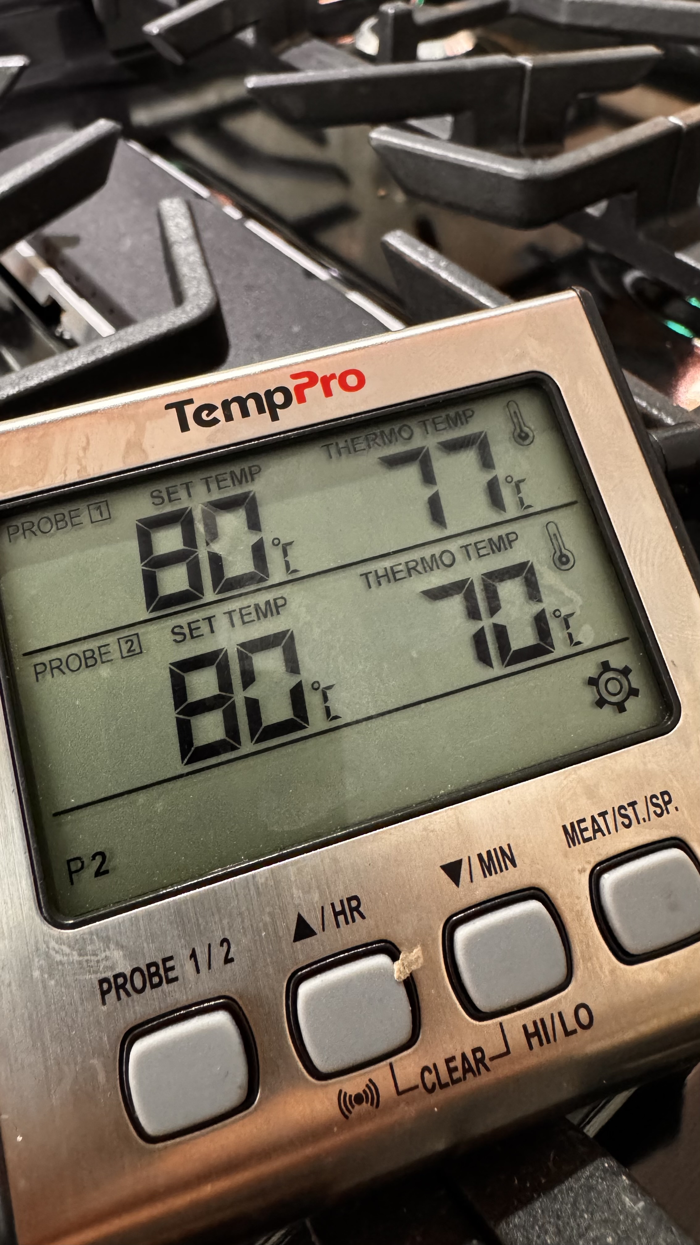

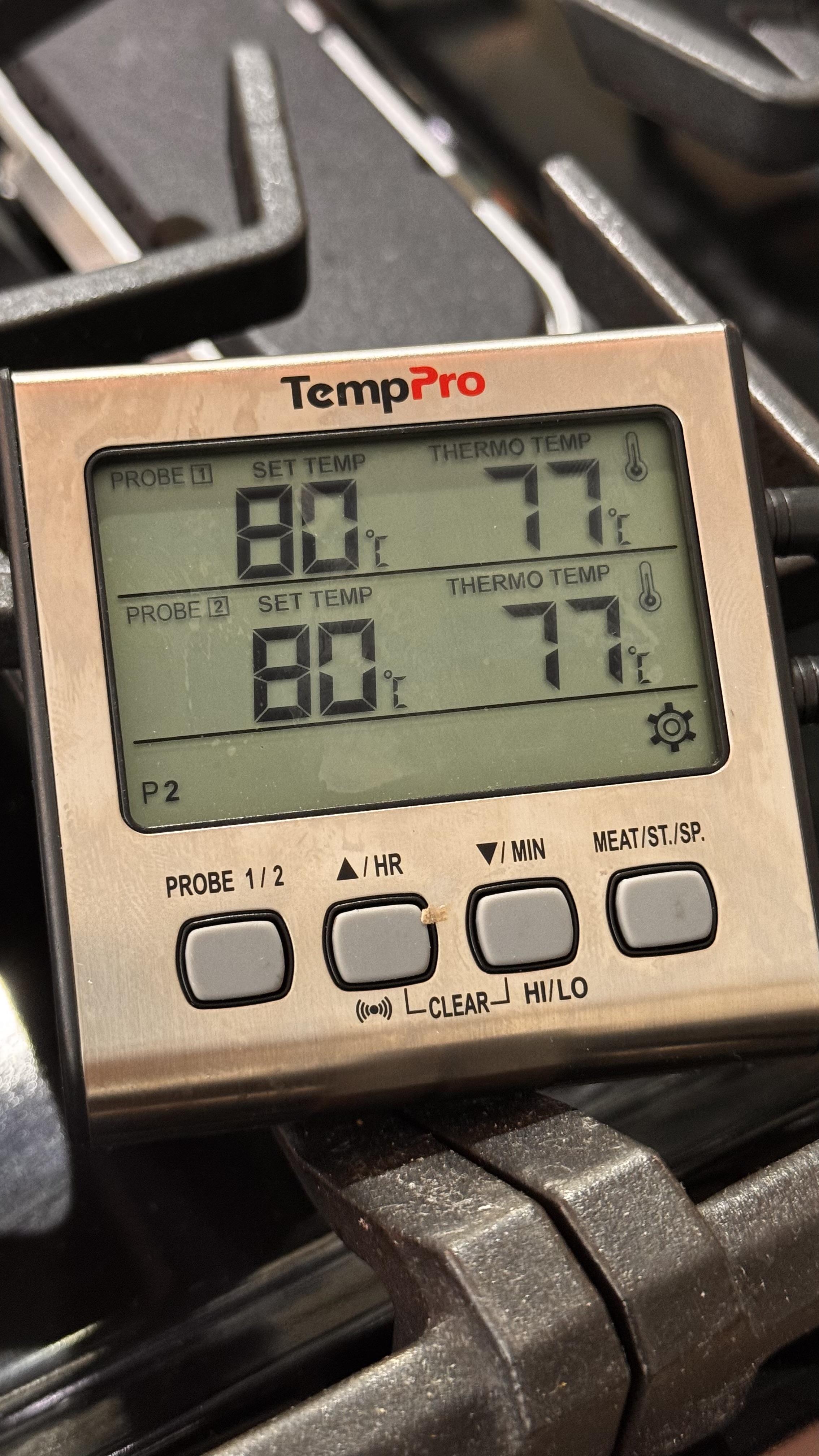

Fortunately, I have a “keep warm” mode on this gas stove. And to be even safer, who would trust the set temp anyway? I put two temperature probes in there (one on each spool) and have the Temp Pro unit set to alarm me if the temp reaches 80.
I’m shooting for what, 75°?
The Bambu wiki says 90-100C for a bed temp if drying ABS in the printer but filamenthub says 70-80C for a drying temperature for regular filament dryers.
I have no experience with drying ABS though. All drying at lower temperature will do is take longer. I’d be tempted to stay below 75C but don’t know your time constraints.
Living on the edge. What’s the worst that can happen? It’s just two spools and some filament. 77°. I’ll give it 6 hours.
One thing is that looks like it might be a gas range. If true, the flame will be increasing the humidity while the heat is decreasing it.
Great for baking. Not as great for drying filament. That humidity will limit how much water you’ll be able to remove that way. And you don’t want to stink up your oven either.
Anyway, just a heads-up that a gas stove isn’t the best option for filament drying because of the water from combustion. But it should produce a change. And that’s all you really need to see how to fix it.

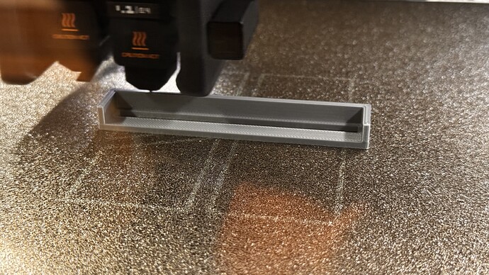

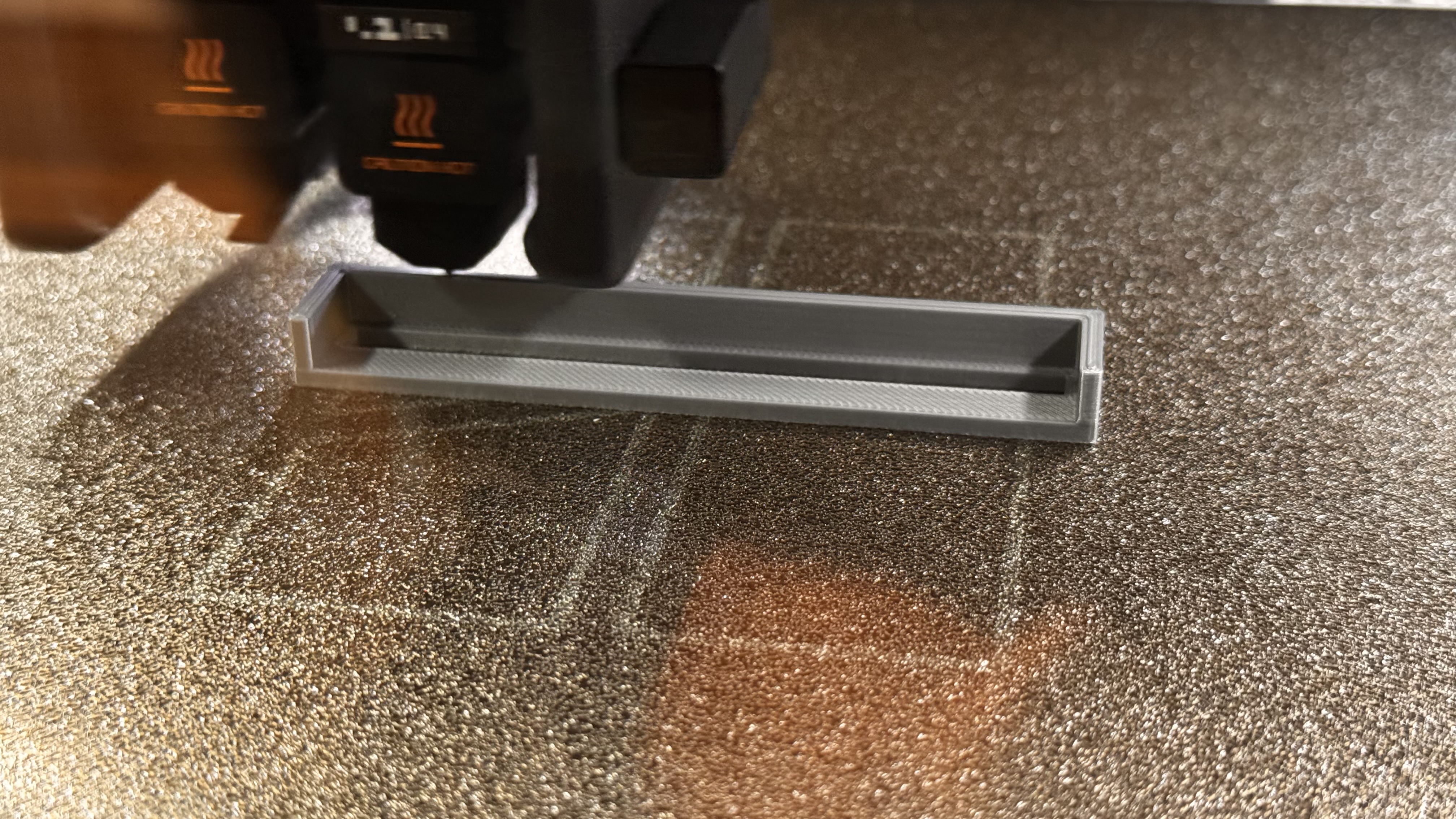

Here is the update: Fresh opened ABS was “wet” and while the X1C didn’t show the defects like the H2D, the layer adhesion was garbage for both.
I dried the filament in my oven for 5 hours and the result was the H2D printed that same ABS glass smooth. Here is the test print showing the result.

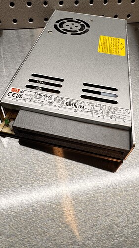

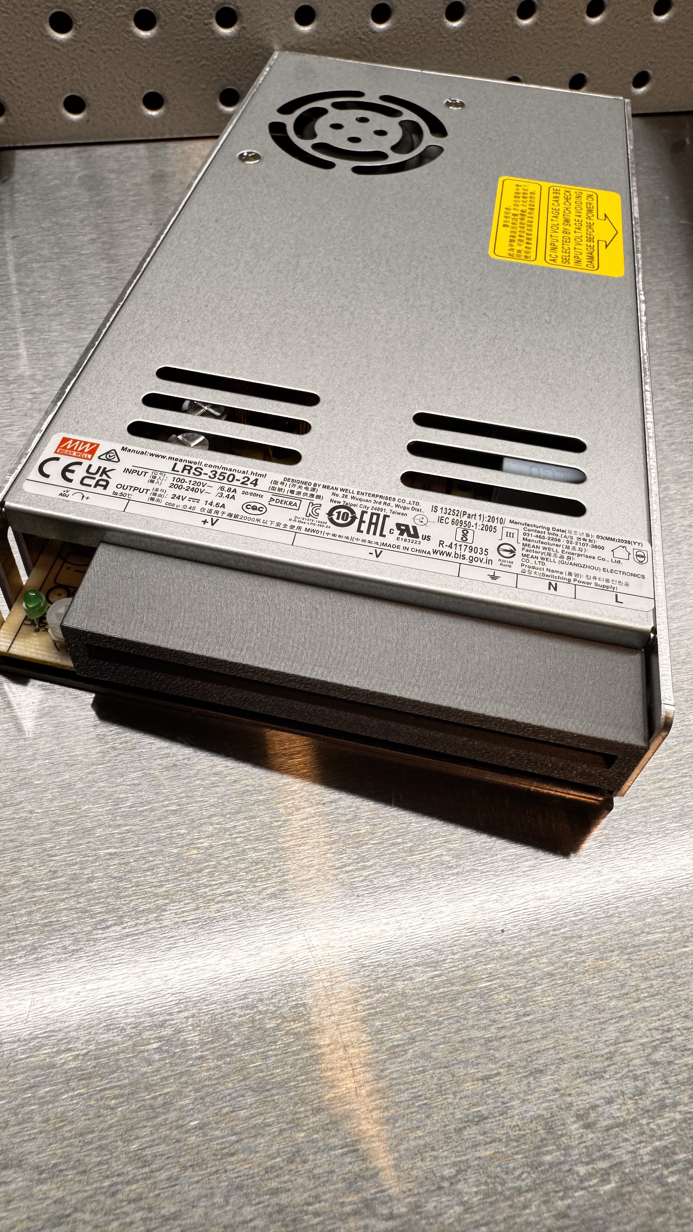

I made this small cover for this Mean Well LRS-350-24 that I use to power both of my AMS 2 Pros.
