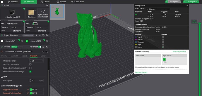

I tried to verify the case in which I want to use an expensive material for my model and a cheap material for ALL the support. The idea is to use a cheap material for the entire support and not just as a separation layer, in order to have as little waste as possible of expensive material.
I used a design cat as a test model (if needed, I’ll post a project) and I initially simulated 2 “normal” conditions:
CONDITION 1 - The cat printed with expensive material / supports printed with expensive material / no prime tower (not needed as it’s the only material)
CONDITION 2 - The cat printed with expensive material / supports printed with cheap material / prime tower active
The result between these two simulations was not comforting: due to the prime tower, the amount of expensive material used overall is excessive, equal to 50% of the expensive material used for the cat.
This is also due to the ratio between the measures of the prime tower (too big by default) and my model. I then tried to reduce the size of the prime tower, reduce the flush coefficients but there is some parameter that is currently uncontrollable that forces me to have that amount of material in the tower in any case. At the moment, therefore, if I want to use the tower and print a medium model, I have to accept the fact that 30% of the material used will be for the tower. BUT in reality it was not the focus of the test, the idea is to use the two nozzles to their full potential, without prime towers and not having to change filament:
CONDITION 3 – Cat printed with expensive material / supports with cheap material / no prime tower
Clearly it is the ideal solution to avoid waste and reduce times, but how will the printer behave in reality? Will it clean the nozzle from the poop that could possibly form on the hot nozzle while waiting? It has a dedicated camera with AI, why would it fail?
The simulations of weights and material times were obviously much better than the previous two and so I tried to launch the print…

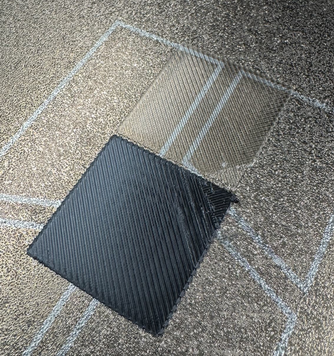

I think the simplest repro is to create two flat shapes side-by-side with two different filaments, one on each nozzle, and then disable the prime tower. Watch the first layer of each print. Both will purge and wipe, but one will fail to extrude plastic at first, the other seems fine.
This is what the minimum repro looks like. Two cubes, resized to only twice the layer height of a 0.6mm nozzle (two layers of a 0.15mm profile = 0.3mm tall). One printing in black PETG on the first nozzle, transparent PETG on the second nozzle. The black prints the first layer without issues, the first layer of the transparent cube misses the corner. The second layer of transparent prints fine (because it’s a continuation of the first layer without a swap), but the second layer of black misses a corner after the swap.
I can see how the behavior makes sense if the pressure is backed off after the purge, and between nozzle swaps… but it does seem that without the prime tower, there isn’t enough of an attempt to do anything about that with default options. First layer of black is fine because the lead line at the front of the plate will effectively normalize the pressure.
So in conclusion, I don’t think it’s wrong as such, but it could be better and perhaps there are options that I can noodle to improve this edge case. If you are printing something with supports or infill, then priming into those might solve this too… my particular reason for disabling the prime tower doesn’t really allow for that (transparent, thin film, solid prints).
Well, below is my solution, but your mileage may vary and use only at your own risk. From what I can tell, there is 2mm of pressure missing post nozzle swap. There are no good options to resolve this based on my diffs of gcode produced from various tweaks and the machine material change retraction settings don’t fix it either. What did work was to modify the filament start gcode (for all filaments used) to insert the missing pressure. Since this isn’t required for the very first filament after the lead line, I also inserted a retraction to cancel it out at the end of the machine start gcode… the two fragments look like this:

Tested a few materials, and in my situation at least, there is always 2mm of missing pressure post swap (on 0.6mm nozzles at least). There is no attempt to resolve this from what I can tell, besides printing the prime tower - but even that misses 2mm worth of plastic printing so my prime towers are pretty spotty without this change too. This change didn’t lead to more blobs or issues so far, it just closed the gap of missing plastic between material changes. I’m doing a six color print now to really stress test this.
Edit/Update: The sweet spot does vary by material, some of the high flow materials require a little less by the looks of it… but I think if you want to put the time in to calibrate, this can avoid a prime tower under certain conditions. At least, it works for this awkward project. Ideally, it seems like it would be nice to be able to purge into two towers that are in the unshared space to the sides of the plate. Losing the overlapped space to a large prime tower is unfortunate.
