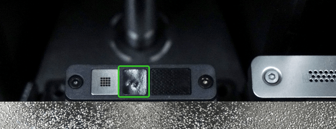

I’ve been performing the recommended maintenance, and from the front everything looked fine:
However, a look from underneath the printhead revealed a horror show:
It does look like a horror show, mate.
It looks like there’s a chance it could set itself on fire.
I would let Bambu know to see how dangerous it could be.
it looks pretty gnarly but if you put the sock on, heat that nozzle to operating temp for 2-3 mins, take the sock off, put your glove on, and wipe it down itll be gone in an instant. The A1 nozzles get similar.
I dont think its a fire risk - you can look up combustion temp of all the material you plan on putting thru the hotend - but its certainly not ideal
I don’t see a fire risk either, as nothing will ever get hotter than the hotend. The bigger issue is how to clean all that gunk off the wiring, which looks to be rather fragile. I can’t just heat up the gunk and try to pull it off without risking breaking the wire. Maybe I just need to order replacements and go with “all new” again, or at least have it already on hand as a backup in case I do end up breaking it during the cleanup.
By the way, something I learned just now is that the sensor in the photo is an Eddy Sensor, aka the Nozzle Wrap Detection Sensor, whose job is to detect if molten filament has wrapped around or oozed onto the nozzle — a common issue that can cause stringing, blobs, or clogs. I had previously thought that was checked for optically using the camera, but no, this does the business. The other nozzle also has one. This eddy sensor is different from the one used to calibrate nozzle height, which is located in the back:
I’m surprised Bambulab doesn’t advertise the existence of the Nozzle Wrap Detection Sensor, because it’s a highly important and valuable feature (well, at least to me) that I’m not aware of any other printers having:
From the looks of it, it might only be the right hand heating assembly that needs replacement (before it becomes too gunked up to make even that difficult):
I have probably close to 2000 hours on this printer, so if that gets me back to “good as new”, I’m OK with that. Hopefully it’s not a difficult swap.

I had this happen to mine because of an incorrectly installed waste chute. Bambu supplied a new heater assembly under warranty
@GeoffS Can you say anything more. e.g. how would I know whether mine was also incorrectly installed? Except on one occasion, I haven’t noticed the waste chute clog up. Was that the primary symptom, or was it something else?
