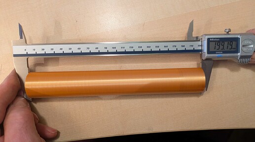

About 10 days ago we found that our H2D prints significantly oversized parts in the Z direction. A 190 mm PLA part measured 193 mm. The issue is reproducible, and caliper measurements show the bed moves ~0.15 mm too far per 10 mm.
We know that after delivery in May 2025, Z dimensions were slightly undersized (199.2 mm for a 200 mm part).
We checked the belts and downgraded the firmware. With firmware 01.01.00.00, parts return to 199.2 mm. All newer firmware versions produce oversized parts.

I contacted BL on 11.02.26 and they asked for pictures, which I attached here now as well.
BL didn’t reply since I provided pics on 12.02. - hopefully only because of Chinese New Year.
With the new firmware we manually moved the bed 7x 10mm and the caliper showed 71mm. The same movement is very accurate with the old firmware.
Therefore the identical test project resulted in 199.2mm vs. 203mm with old vs. new firmware.

A Ø30×100 mm test part resulted in Ø30.03×101.4 mm.
A caliper test of the heatbed movement again showed 71 mm for a commanded 70 mm movement (vs 69.7mm with the old firmware).
This indicates that the deviation is still present and scales linearly (our 200 mm height results in approximately 203 mm).

EDIT: I am running this test now to see if I can replicate..
Category Details
Untouched File Ø30x200 H2D Nozzle 0,4mm 3MF.3mf
Untouched Profile Generic PLA High Speed
Hardware Setup 0.4mm Right Nozzle AMS HT-B
Applied Material Bambu Lab PLA Matte Scarlet Red
Build Plate High Temp / Smooth Plate
Estimated Duration 2h 10m
Filament Weight 79.00 g
Firmware Version 01.03.00.00 H2D
Timelapse On / Off
Auto Bed Leveling On / Off
Flow Dynamics Calibration Auto / On / Off
Nozzle Offset Calibration Auto / On / Off
Result
~1,0 mm deviation
sidenotes
  • measurements were taken when object was removed from the printer
  • my most accurate measuring instrument at hand is limited to 15cm max.

Thanks for your testprint.
Seems like your printer is in the “normal” range of printing slightly too small, like ours with the old firmware.

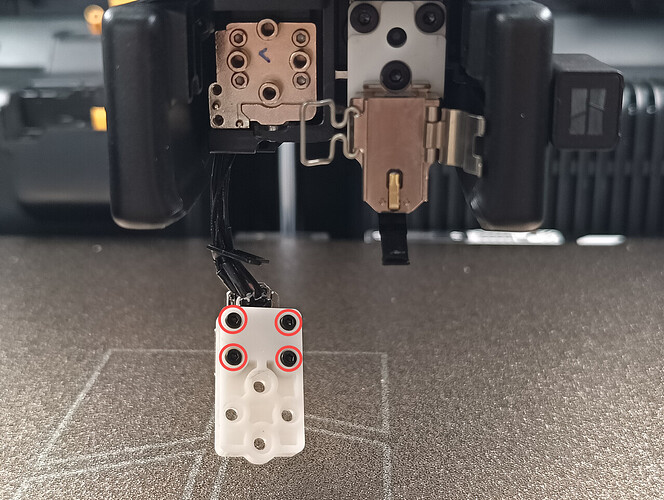

While browsing the forums this came to mind, even though it’s not explaining the massive offset:
Titan - The Screws of Rear
@Milosh_Keat
I don’t believe this is the root of our issue. We are not experiencing any nozzle scraping, and the problem appears to be a firmware-related linear deviation of printed parts or bed movement.
