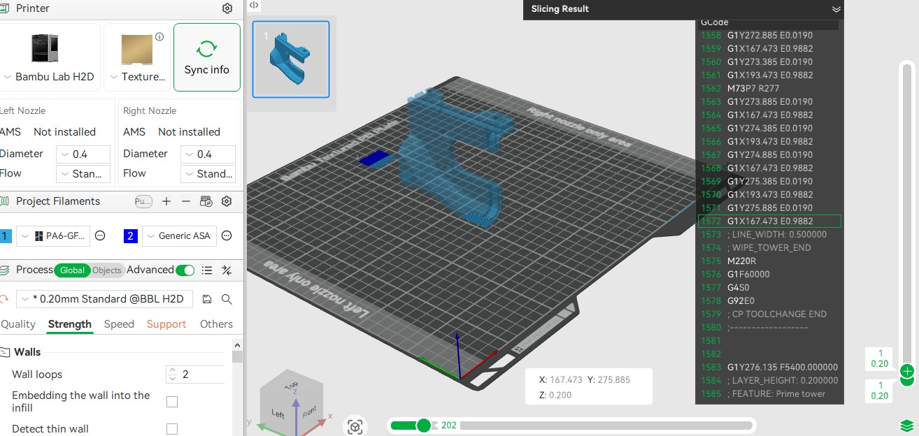

Just in case this pic helps verify settings. Thanks.
Bambu support said they saw no problems and told me to update the H2D firmware, they don’t seem to have an answer. After updating still the same problem along with an error now saying extruder motor overloaded. Filament is extruding without any problems. Here are a couple of pics of the gcode where it messes up, does it look correct? Also, during the start up where it cleans the nozzle etc it doesn’t seem to do anything with the left nozzle.
Still no help from Bamboo, they had me slice and run PLA and PLA, PA6 and PLA, still no change. I did notice what appears to be a problem though. Just before the first nozzle change happens I see the other nozzle start to heat up, at this point it should make the change but continues printing with the first nozzle, however, that nozzle starts cooling ( thinking it is using the other nozzle ) and causes a clog and extruder overload error. Has anyone else encountered anything even similar to this that could point me in the right direction, I’m at my wits end with this thing.
