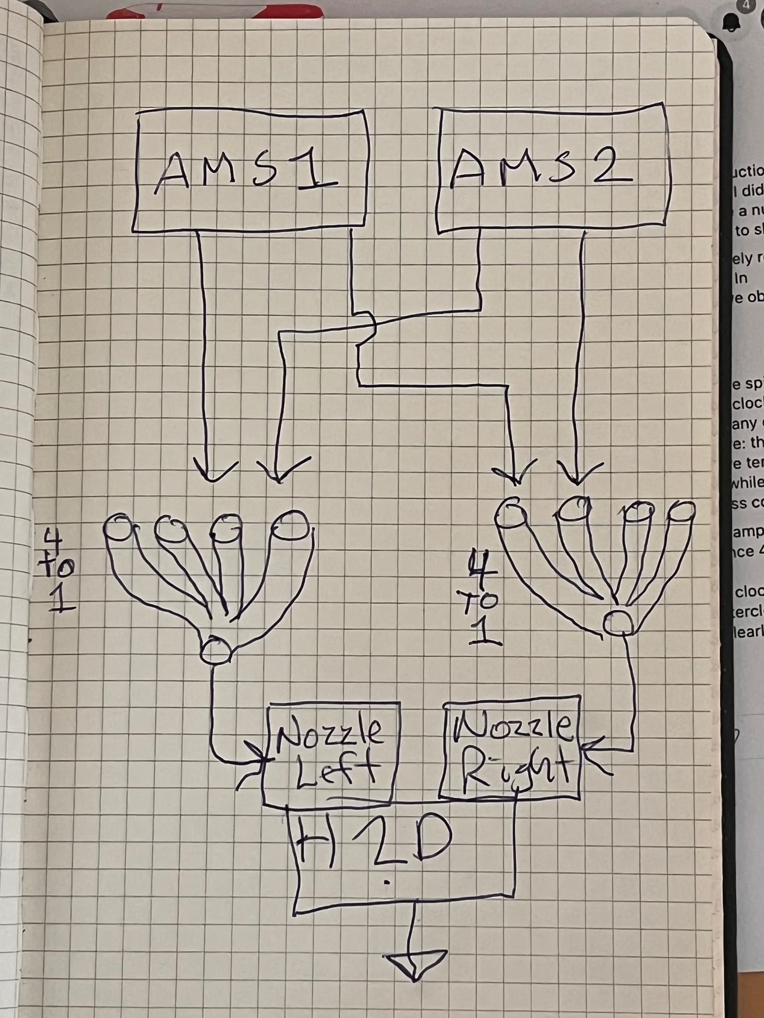

Seems like it would be fairly straightforward. Hope this makes sense.
the challenge is how do you route the filament inside the AMS. The current design is a simple 4in 1out with assisting motors. But if you want it to be able to choose which outlet it goes to, then that would require a moving part that can move the internal tubes to the correct outlet. This can be a highly risky thing to do because the filaments are good at breaching any gap in the filament path.
Bambu Lab has the patent on a 2 port AMS but I guess they haven’t worked out all the engineering issues with it.
Based on the original patent that bambu filed, I dont think they were trying to have one ams feed both nozzles, but rather one ams be able to feed either nozzle. A switching 4 to 1 unit that could choose between the 2 outputs/nozzles but couldnt feed both at the same time. My guess was that a finance guy ran the numbers and figured out it would sell less ams units.
