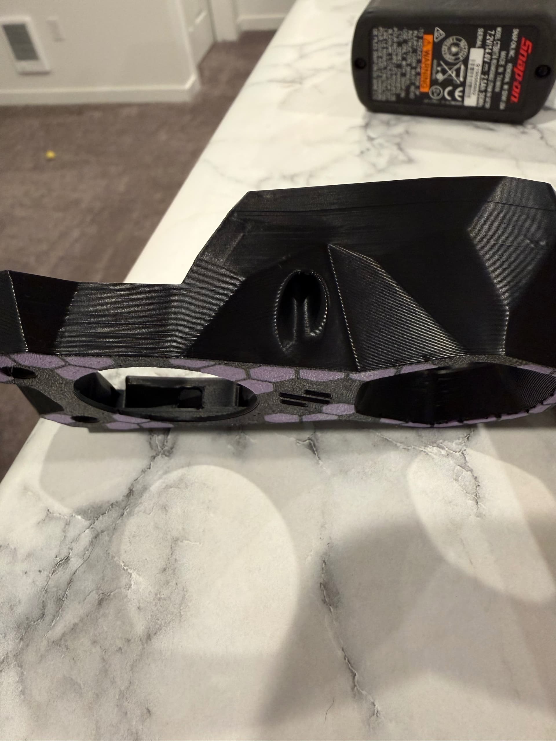

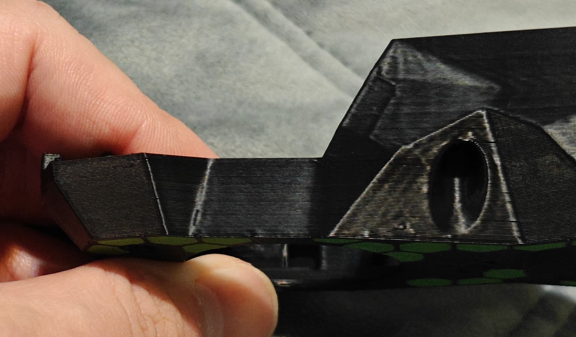

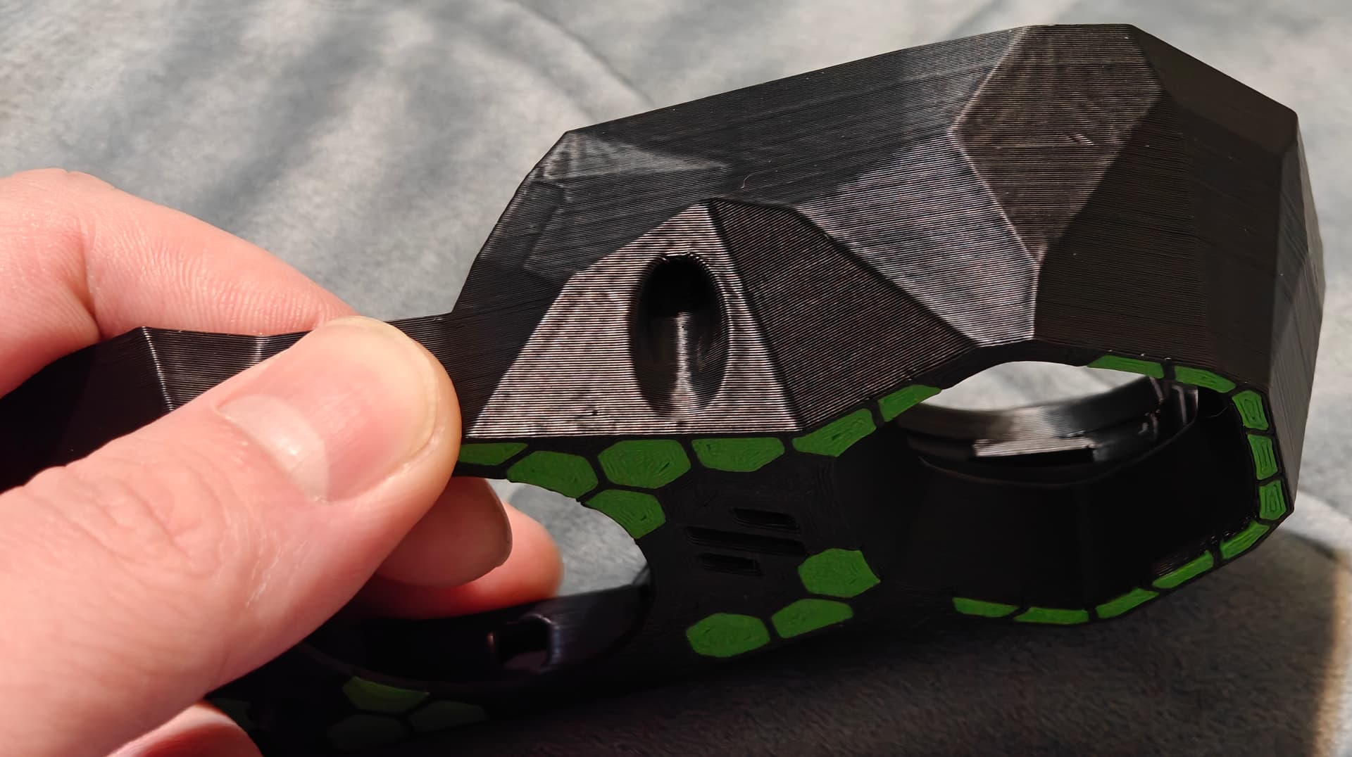

Can you show some pictures of the issues?
I am working on trying to get some pictures right now. Seems that pictures are masking most of the issue but let me see if I can get some uploaded here soon.

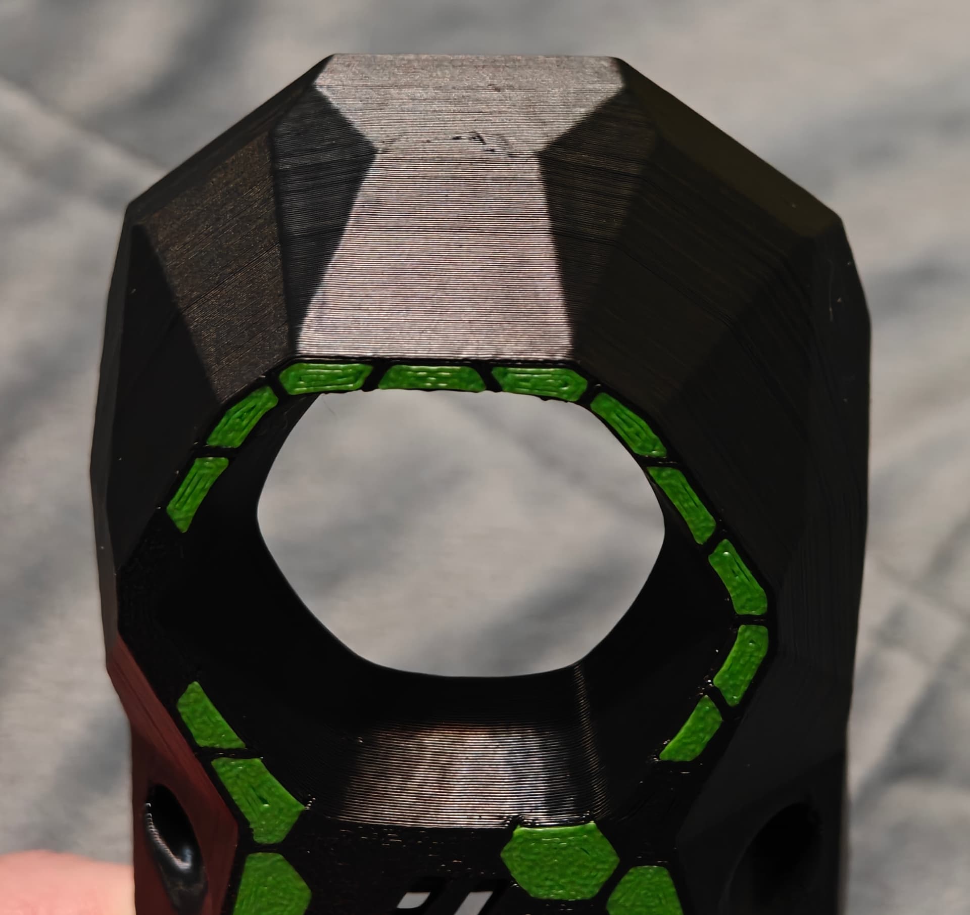

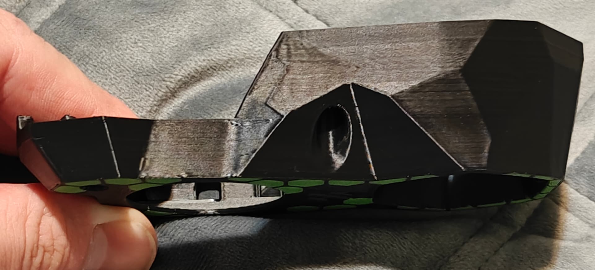

The above pictures are the default Bambu 0.2 Print profile only thing changed was the wall count and top bottom layer count. Fan was set to 65% and if you pay close attention there is still signs of the ABS overheating based on the areas that look “melted”
The pictures look better than in actual person.

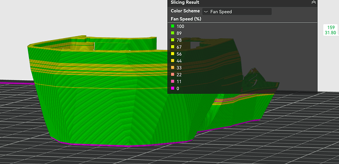

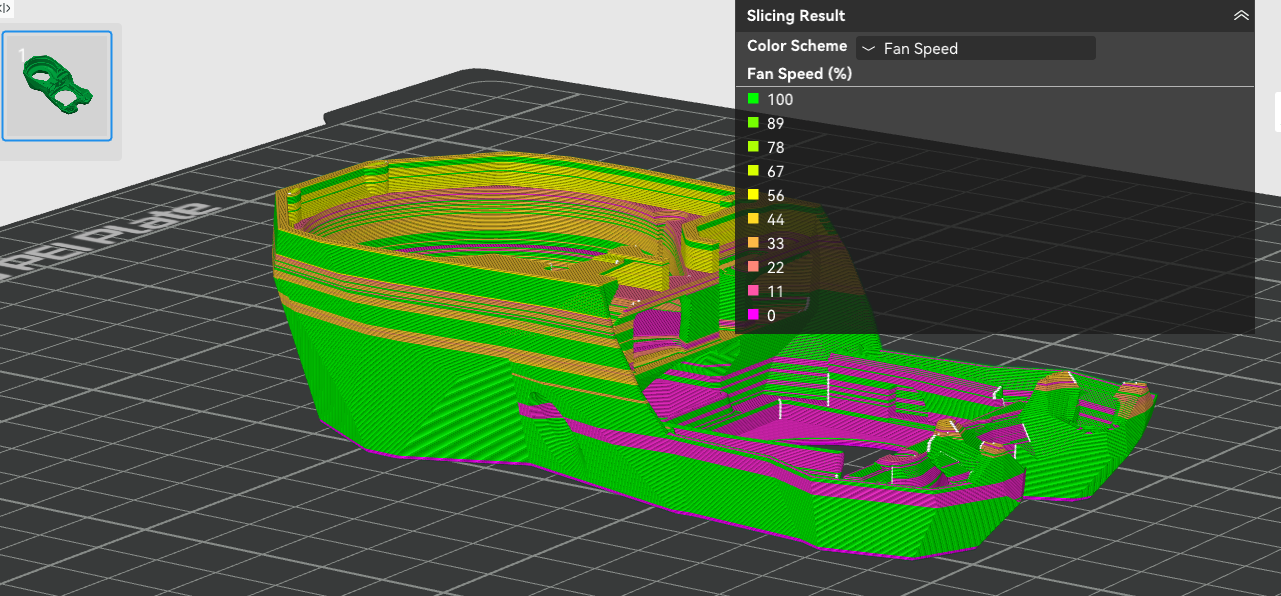

You guy are saying you are using the default bambu profile for ABS but the default profile varies the fan speed too much for ABS. It’s generally known you really want to run a consistent fan speed with ABS.
This is what the default Bambu ABS profile looks like with the part I am printing. This from everything I have learned is generally not advised.

Yeah, looks quite odd that! Almost grainy in places. Have you tested it on another part by any chance? Just to rule out the part itself.
I mean this part is a Part directly pulled from the Voron Github and I have printed this part on other printers without issues.

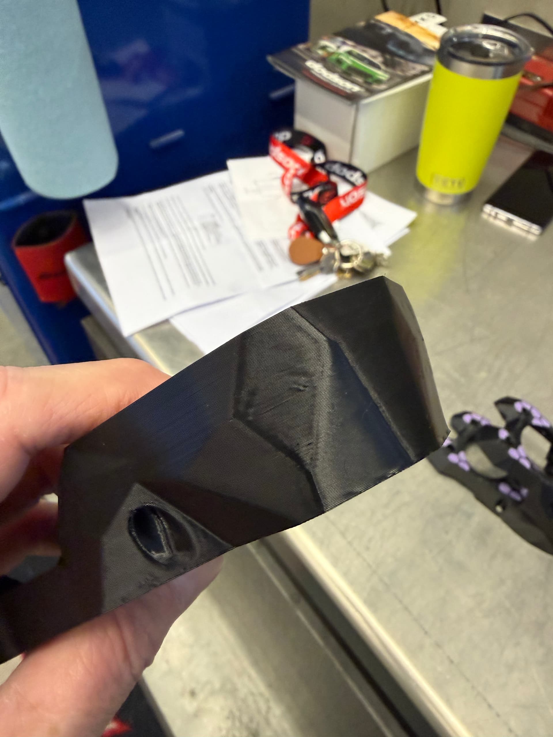

The part looks worse in person the pictures really do seem to mask the issues but you can clearly see where it just seems to be too hot.
I did print a poop chute out of this same ABS that does show some weird outer wall issues so Maybe I can post that up when I can grab a picture of it.
The part shows all the sign’s of ABS overheating to me and that was with the fan speed at 65% the whole print.

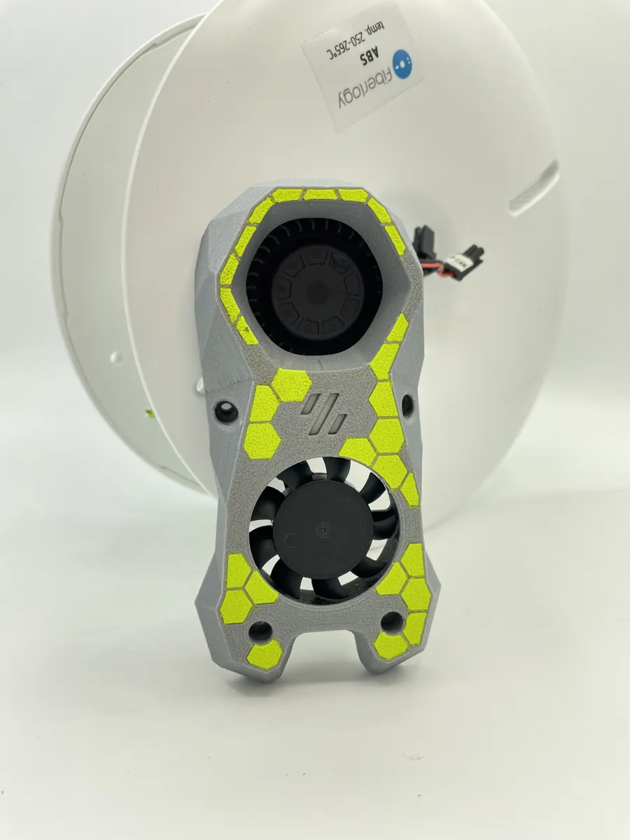

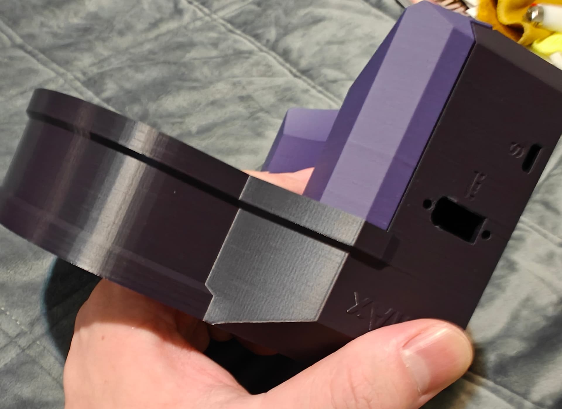

Here are some examples of my post profile adjustment and calibration prints, the dark purple is polymaker ABS and the lighter purple is Fusion ASA, the polymaker was printed at 265-270c with the temperature and aux fan settings being the only thing I changed in the profile + the calibrations I mentioned above (aux fan cause I have a aux fan filter mod installed and nobody wants ABS fumes).
In short If you want zero effort high quality prints using the Bambu profile without any changes what so ever, you are going to have to run Bambu filament, otherwise print a temp tower and do a few flow rate and pressure advance calibration cycles instead of asking why profiles made for a different brand of filament don’t work optimally.

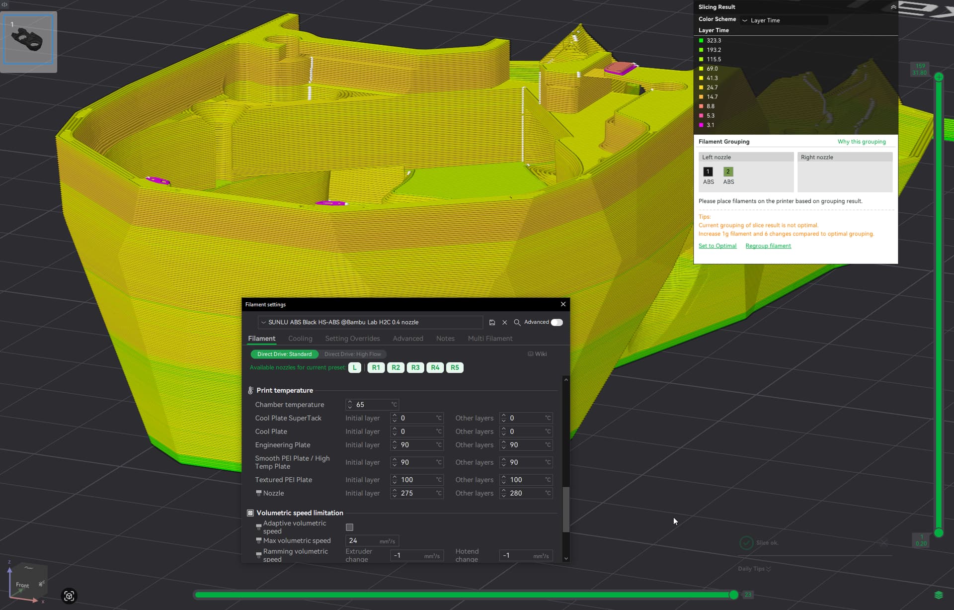

I think you are didn’t quite understand me, I was previously not using the bambu abs filament profile, I was using my own filament profile based on how I know the Sunlu ABS behaves.
I did a flow rate calculation and was within 1% of the flow rate that I get on my voron. 0.0932
I fully understand layer times, the short layer time on this part was 12 seconds, 65% fan speed and 270c on the nozzle which is exactly where this Sunlu ABS has always worked best for me.

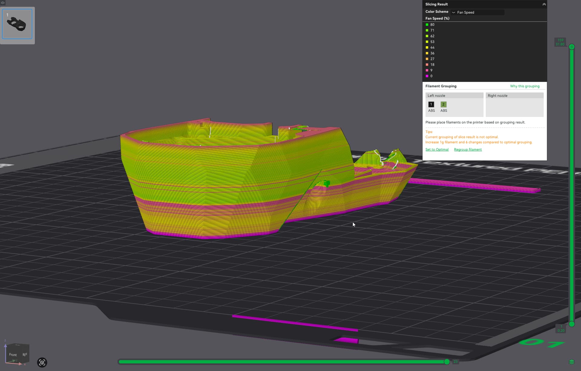

I sent another print this morning with the default bambu profile as a test with my verified flow ratio of 0.0932 and left everything else default in the filament profile. For this part that will run 100% fan speed for the majority of the part as shown in my screenshot I posted above.
FYI the sliced layer time on this part for the majority of the print is well over 12 seconds but it wants to run the fan at 100% most of the print. This also kinda confirms that the default standard print profile is too fast for this size of part and the layer time involved. Kinda weird though since the layer time is over 12 seconds. So to me I am either gonna have to make my own print profile with either way less speed, more layer time or less overall flow to slow this thing down.

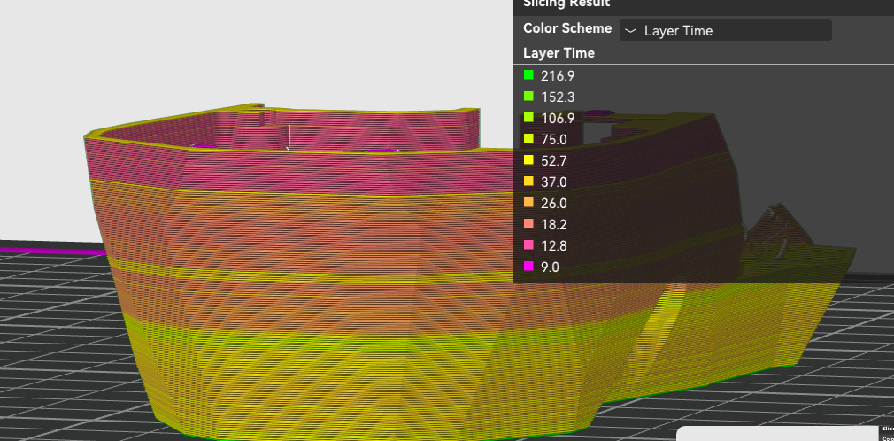

Tonight I am going to increase the min layer time to 18 seconds or maybe 20 and test again.

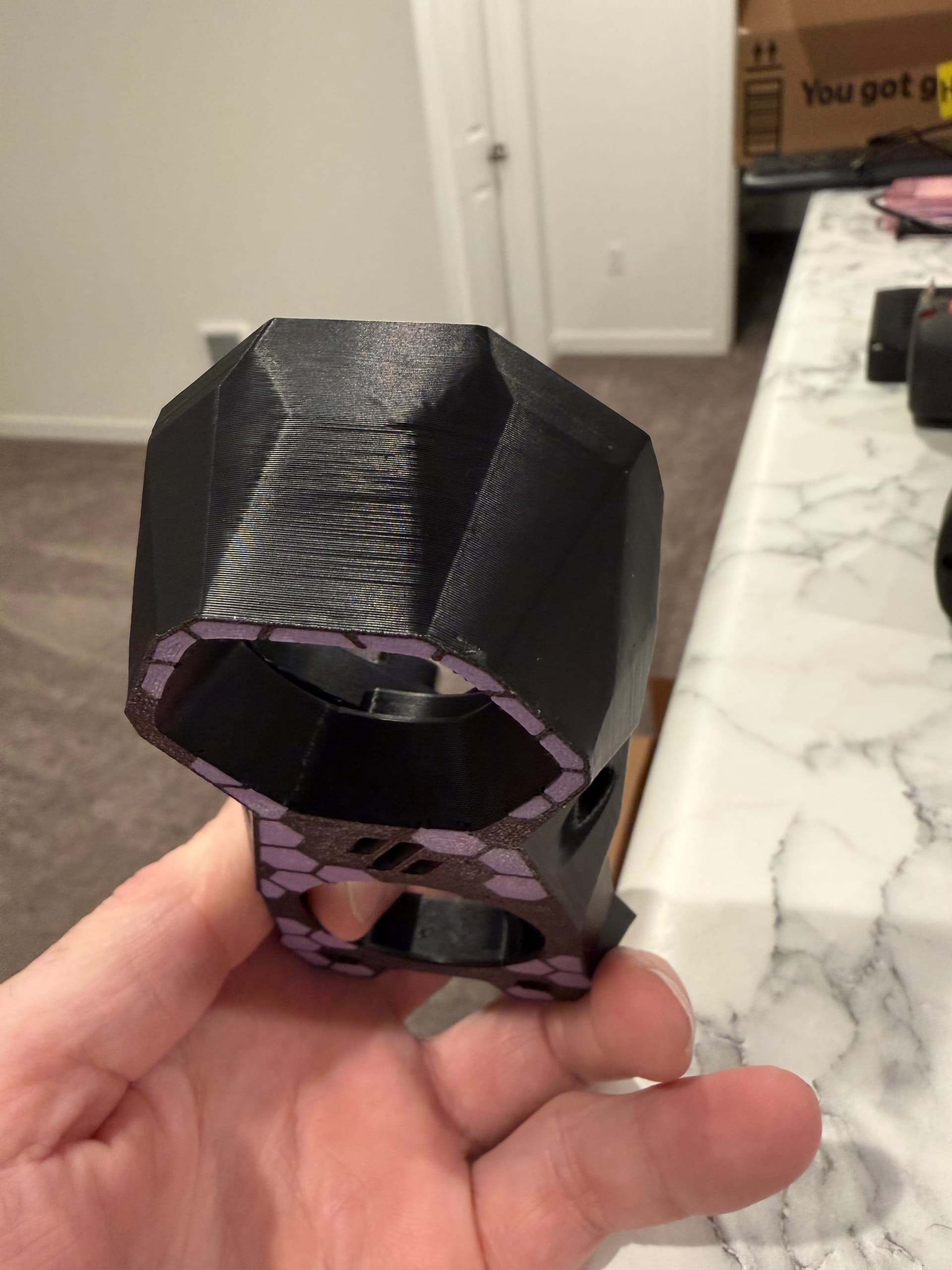

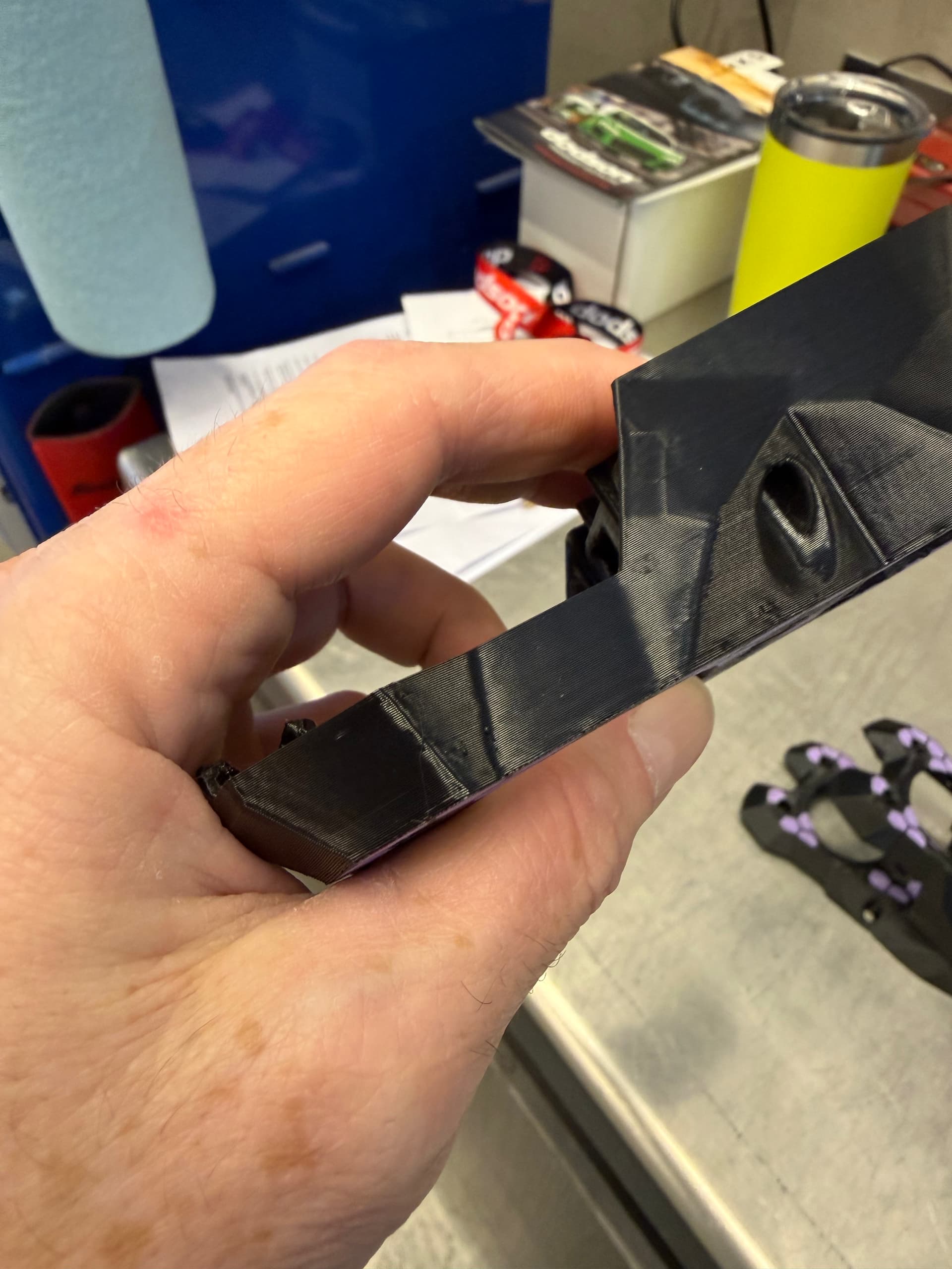

well the test print just finished, looks like the posts you read about the H2S having a weak part cooling fan may be right as my print doesn’t have the soft edges yours does even though I printed this one at 280c, though I’m sure the longer layer times helps too.
I took some pics from similar angles to the ones you posted but angled to try and highlight the layer lines so you can compare.
I’d definitely need to run this guy at 265-270 and slow things down a bit to get it looking perfect, that or print it out of ABS-GF :rofl: .
On your H2S I’m gonna guess its gonna take maxing out the part cooling fan and slowing things down to avoid the heat issues on smaller parts.
Thank you for testing this out, it does look a bit better and does not suffer from lack of cooling that I can see.

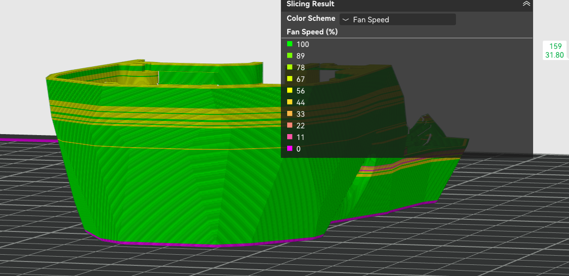

You have an H2C correct? What fan speed was most of that ran at?
I am running a test part right now with all speeds set to 200mm/s and layer time set to 18 seconds to see what the result is.
Theres a screenshot of my fan speeds, its a lot more varied than your pic so its looking like the H2S’ part cooling fan just isn’t strong enough for max speed prints and yes I have a H2C.
Perfect, Confirms my theory and now I know this machine is just gonna need quite a bit more part cooling than expected.
