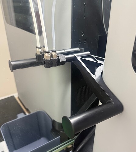

I print a lot of 95A and 90A always from external spool, through the TPU inlet, through a 4 to 1 PTFE tube adapter with a tube that is always connected. Unless you are doing a multi day print and/or live in super humid enviorment, there really is no need to print from dryer.

do you have an stil for that splitter mount?
