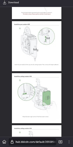

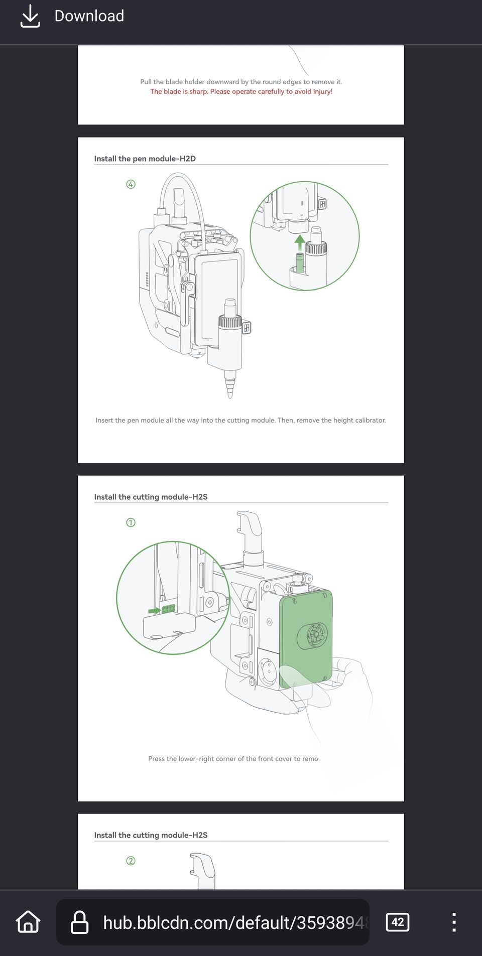

H2S confirmed by cutter manual
This was posted on Reddit a hours ago. Cutting manual has directions for the H2D and a H2S. It’s the same printer as the leak photo. Does the S stand for single? Could be.

It’s not exactly the same as last leak, hope the first leak is more correct or there’s several variants coming. Specifically what I liked on the first leak was that it had dual filament feeds just like the H2D, even with single nozzle that would reduce time for color change alot since it’s basically just cut and purge and then prepare next color while printing.
While I somewhat, I think it makes more sense from both a cost and complexity (and weight) perspective to eliminate the dual extruder setup and just have it prep the filament to the dual buffer in the back. You still eliminate the (usually) longest part of the path (from the ams to the inside of the machine) this way.
I find it hard to believe they would keep the dual extruder in the H2S merely because of what I mentioned above, specifically cost. If you need/want faster multi material swapping, that is why the h2d exists.
