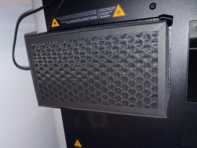

I have an internal filter I designed that I run as well. You want to be real careful about restricting the airflow on the exhaust as it can cause problems like heat creep etc, thats why I did not put a HEPA in my design and just use the external HEPA IKEA. The one I designed has honeycomb structure to ensure good airflow and will not restrict it.

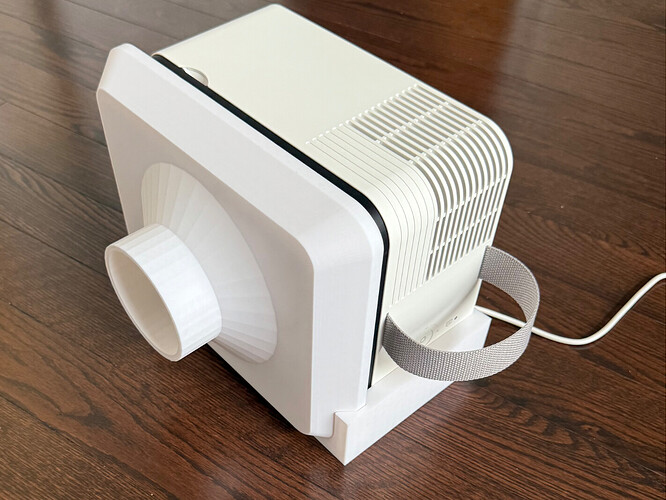

Would be great if there would be a cheaper solution of the xTool SafetyPro AP2 running indoors.
I also have a hose adapter for the IKEA purifier to turn in into a cheap smoke purifier. You can print multiple IKEA HEPA frames to stack them to make it filter better. It wont be as good as the XTool most likely but it will be a lot cheaper.
