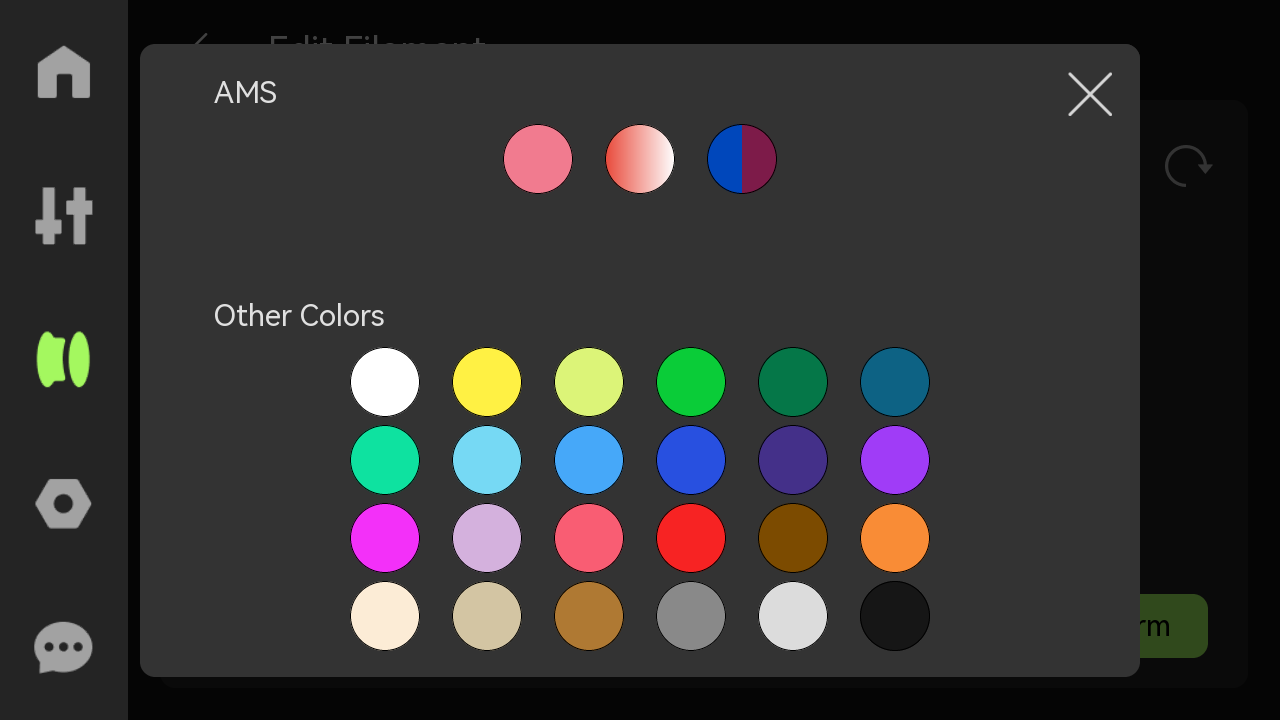

  1. Added support for selecting AMS-detected filament colors when manually editing filament colors, including multicolor filaments.

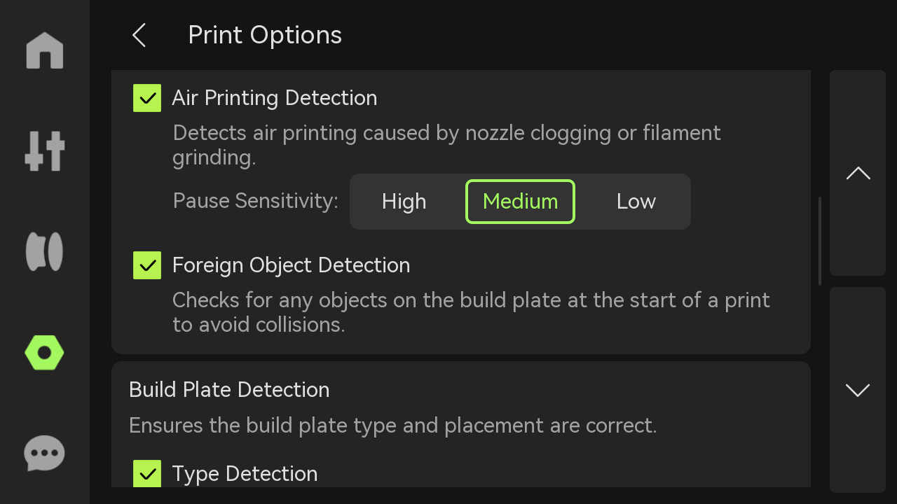

  1. Added a toggle for Foreign Object Detection.

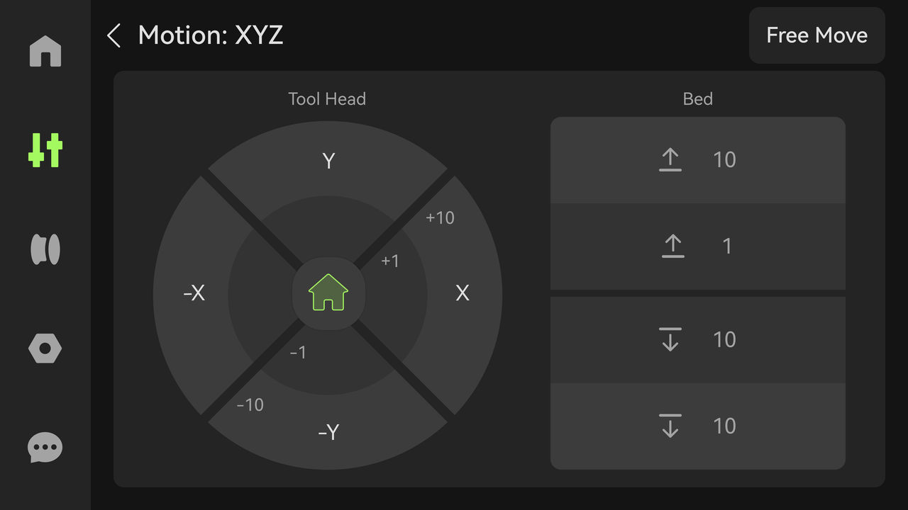

  1. Added an XYZ Free Move mode that allows the axes to be moved freely while the motors are idle, making maintenance and servicing easier.

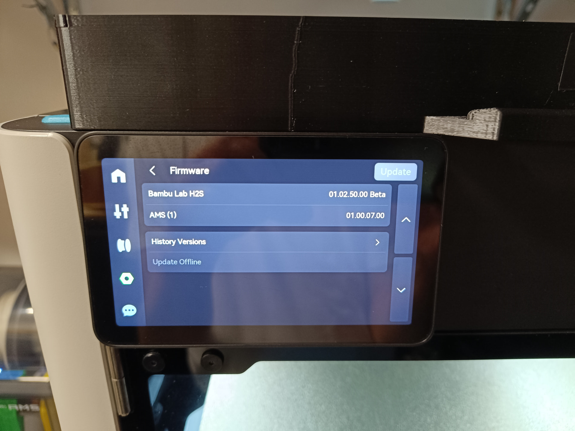

Hey All.
Just had the popup on my printer for the new 01.02.50.00 firmware and through id’s give it a go and found issues.
The bed leveling is sounding broken again like earlier beta firmwares: - https://www.youtube.com/watch?v=BejU4xmk5tQ&t=23s and tool head is acting like it is a not calibrated and off by a mm as when printing a large medel, the head keeps hitting the model when the bed drops, tool head moves to another location and comes back up a bit too far each time.
I did not get a video of that but got a video of the bed leveling sounding broken: - https://youtu.be/da9GJw_L9H0.
Going to have to roll back but happy to try the next beta.
Yep, this is different. Have you tried a factory reset.
One unrelated issue, your stopper shouldn’t move like that. Are you using my model? It looks like you’re one tooth off on the rack or you have removed the back gear during installation and have put it back in the hole for H2D/H2C rather than for H2S. The stopper still seem to work and park OK but it does funny things :wink:
I did try a re calibration but did not help. Rolled back to stable firmware and back to normal now.
But I can confirm I am using your model, and it is located right; only started moving like this with the new firmware. It has been moving silently :smiling_face_with_three_hearts: for the last, maybe 8 months and did notice how it was mis-positioned. But with the older firmware, all is aligning AOK now.
Wow this is really weird so it was just the firmware update doing very strange things. Thanks for the feedback
