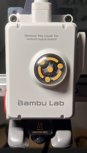

H2S has an a1 print head
It looks like the H2S has a grey a1 print head with a camera it will use the H2D nozzles, and it will be able to take advantage of the whole print area due to the print heads smaller size.
Why would you believe it’s lidar? Same exact housing is for the camera on h2D , more probable to be the same module.
Now who wants to bet for the price? I call 2K
I forgot that the regular one only had a camera
This particular picture doesn’t really show, tbh.
But it’s already known, somewhat, from older ā€˜leaks’ that H2S (or whatever) seems to be using A1 silicone socks, implying A1 hotends, implying also, imo, a less capable extruder gears just like A1 since A1 hotend is designed for lower max flow.
Bambu, prove me wrong please.
I’m thinking an A1 print head, but just super larger form factor - like Prusa XL size…
I don’t think so, it will just be able to use the entire plate

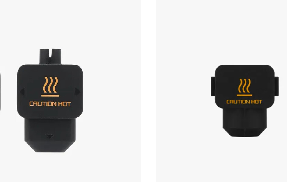

yep. that’s an h2d sock, if you look closely, you can slightly see the indentations of the arrows that only the h2d sock has.
Good catch. I was only focusing on what seemed like A1 sock’s ā€˜ear’ tips. That’d be great news, we’ll see.
