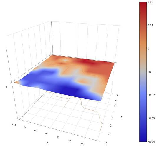

so i decided to do some bed tramming recently on my H2S with dial indicator, i printed holder for it and noted measurements of 4 corners, and regulated them accordingly. And i managed to achieve decent results - on 4 corners deviation 0.01mm, but…
I measured middle of the bed, and there is -0.20mm, left and right side of the bed measures +0.10 - that is 0.30 deviation and banana shape - look at the picture
so my question - can i do anything to improve that (mostly the -0.20 middle point)? Some kind of capton tape underneath? Anyone done something similiar?

Here is mine at 55C static and the result of auto bed levelling calibration
Hot plate 55°C, nozzle 140°C, no compensation from calibration
Hot plate 55°C, nozzle 140°C, WITH compensation from calibration

Really don’t worry about it but if you want to test, remove the screw from the middle front support bracket which is only used for transport and re-tram and re-test
Mine is removed in the picture
Bed mesh is very good at handling numbers this small
I would re-measure it at 75C @ 15mins, not re-tram it, just for the info since you already went thru the work :slight_smile: And retram only if you’re wildly out of spec IMO
I have this screw loosen after tramming, just as wiki says

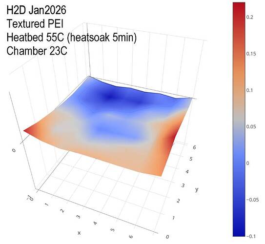

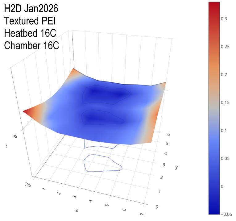

These were my results (no ABL)
Obviously I underestimated the role of the bed size. Thank you for the pictures!
Seems your bed is improving at higher temperatures :grinning_face:
