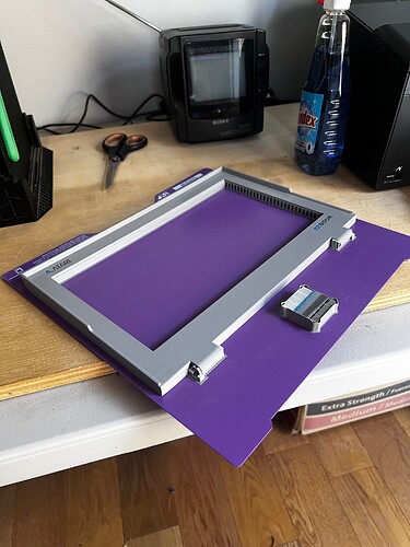

Full width part… going to be tough to get a nearly perfectly flat part. How much warp is too much in your view?
Also, make sure you machine is no where near an open window or AC vent. With the printer opening up and drawing ambient air in, you don’t want cool air sources near by.
Well unfortunately any warping at all is going to look bad on this part because theres a lid that snaps on and theyll be a noticeable gap at the seam.

here’s a snapshot… the arrow is pointing where the warping is…
