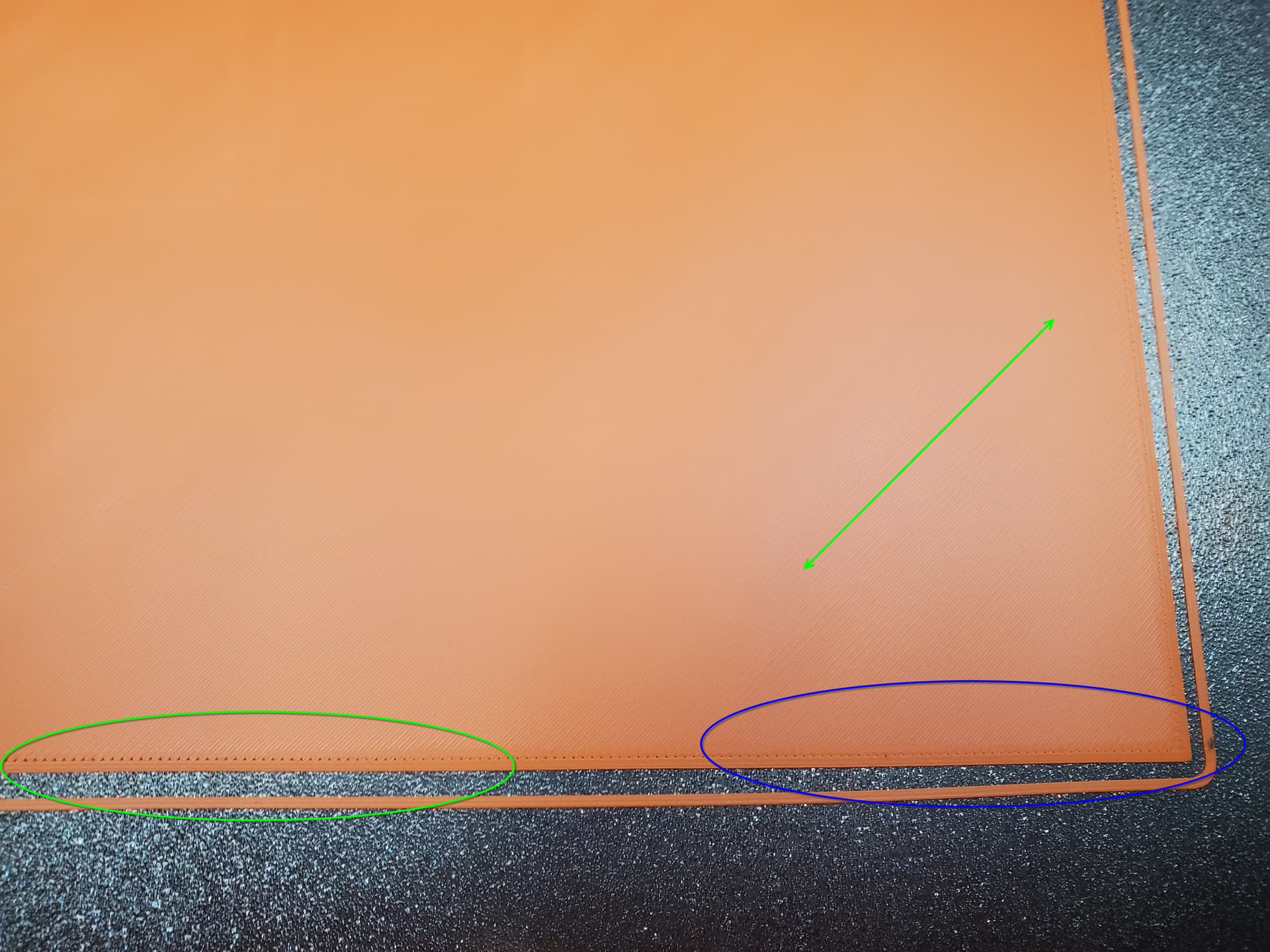

Small issue with my H2S. On a large 260X260 test print the infill is not fully reaching the perimeter at the front middle to left side of the first layer.
All other sides are perfect as is the overall first layer.
It starts good at the right front, blue circle, corner but slowly changes as the extrusions move to the left green circle. When I remove this print the perimeter is not attached to the infill.
Thanks for any thoughts.
That looks more like the Z height is changing and you are getting different squish, what does a full-plate 1 layer look like when you peel it off?
just infill/perimeter overlap rate set too low. change your slicer settings.
That pretty much is a full plate, single layer. I have varied the overall size of the print and that front area still has this issue.
The other 3 sides and the overall single layer look great. It is just this front.
I did a manual tramming of the bed using a gauge and it is dead on at all four corners.
Going to recheck the front to see if it is off.
No. As mentioned, the other three sides are perfect as is the overall first layer. In the picture infill overlap is at 25%. I have tried at 50% and the issue is still there.
