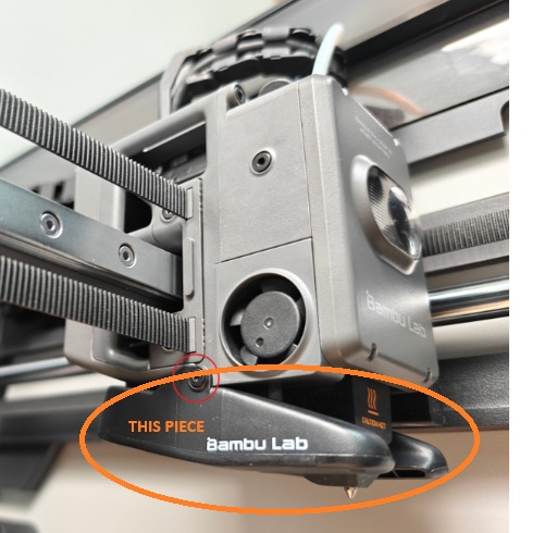

I cannot find the ducts for the part cooler for the H2S, only for the H2D/H2C.
Am I to assume the same parts work on the H2S?

I sent them an email with a picture of the part attached
And got this in response this morning:
" 2026-08-17 10:41:43
Dear Customer,
Thank you for contacting Bambu Lab Customer Support.
Please first clearly let us know the name of the part you need. The H2S does not have a separate air duct for the **Part Cooling Fan**. If you need to replace the **Part Cooling Fan**, below is the purchase link you need: [Part Cooling Fan - H2 Series | Bambu Lab US Store]. The link you sent is for the fan duct of the H2D/C, which is not compatible with the H2S.

I studied that part last night and everytime I selected it, the duct “shoe” disappeared and showed only the fan.
This morning, it appears to show the entire assembly. Maybe I am a conspiracy nut, but that web site is very different this morning/afternoon representing the H2S Cooling Fan.
  • Dave
I see what’s going on here.
There are two pictures when you click that link - those aren’t two different views of the same part, they’re actually two distinct parts.
The first one is the H2D/H2C fan, the second is the H2S fan and duct combo - it just looks weird because it’s an overhead view of the part.
Going through the Bambu wiki for this part, I’m reasonably convinced the link they gave you is right.
