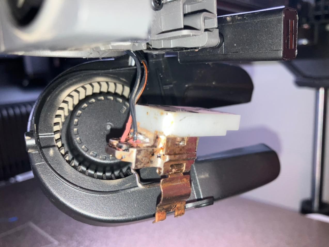

I’m dealing with an issue on my Bambu Lab H2s after a blob of death incident, a print likely lost bed adhesion, causing filament to accumulate around the hotend (blob). I cleaned the hotend manually while hot and tried to print again, but about 3/4ths of my prints now end up either with spaghetti at the last layers or detaching completely from the plate.

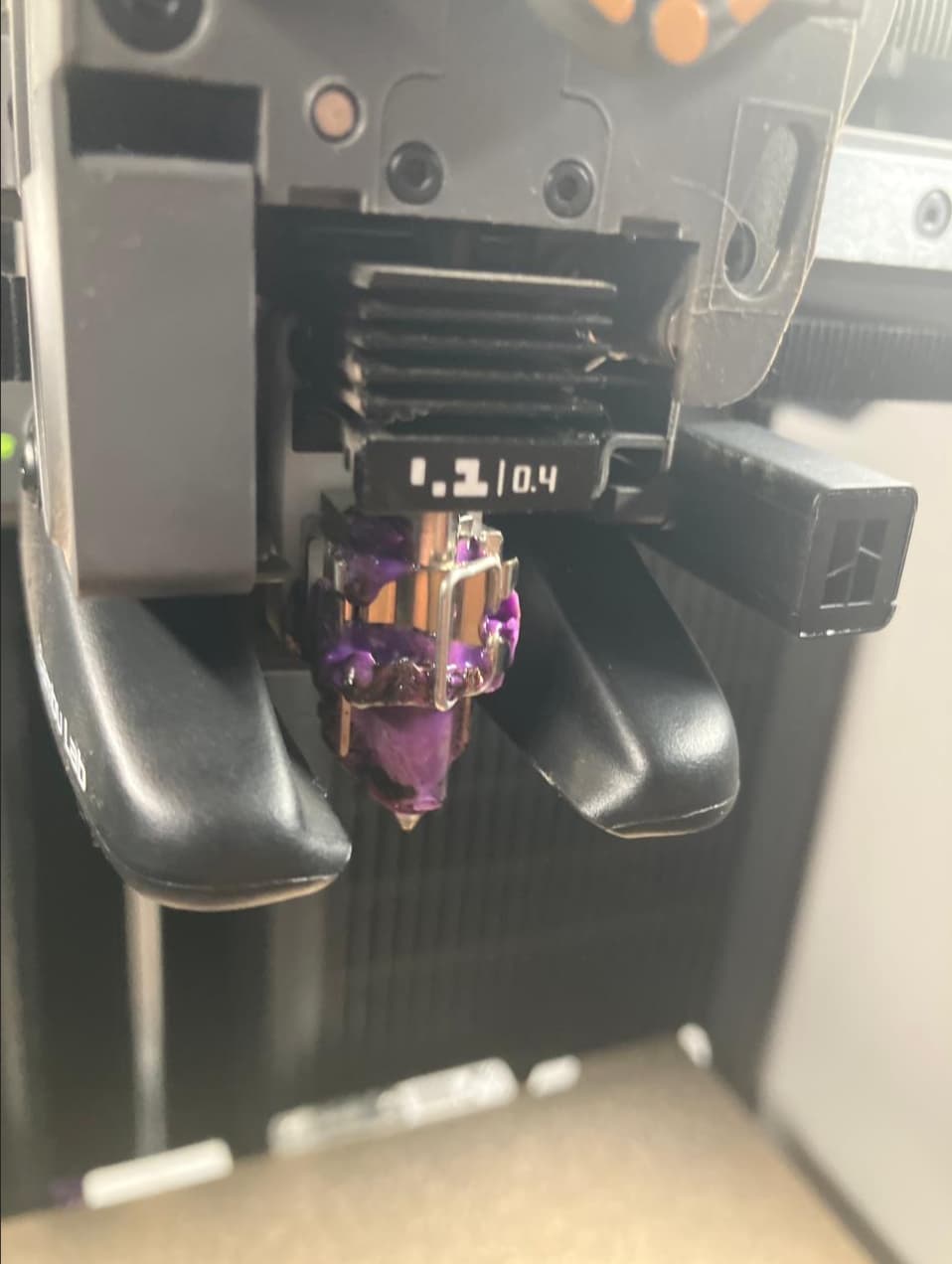

Here’s the nozzle just after the first blob

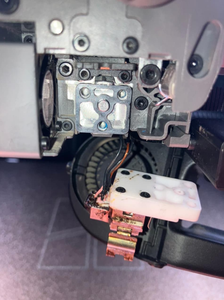

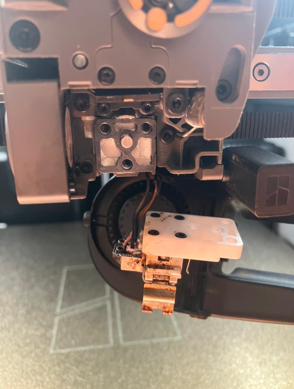

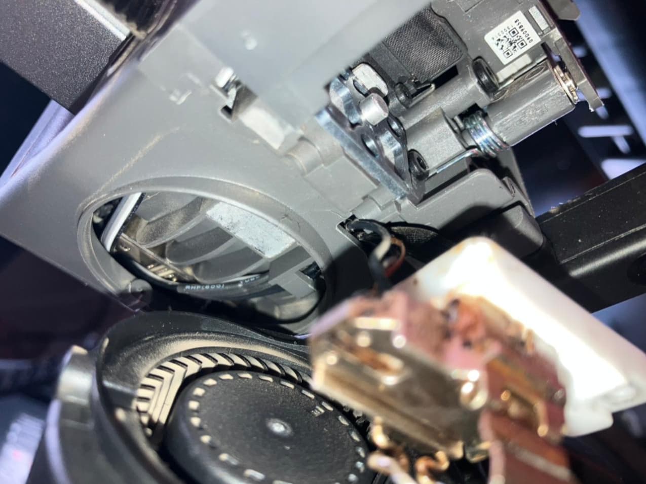

And here’s a few photos when I tried to remove the blob, I even removed the hotend to get a better view

I’d replace that heating unit as well.
