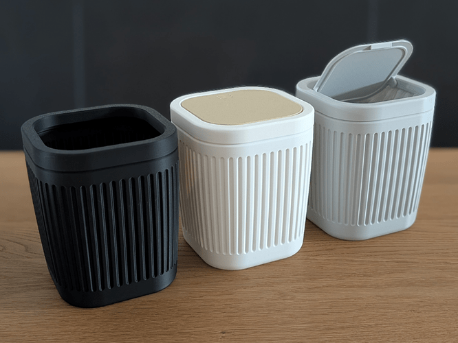

Hey Friends, I’ve noticed something unusual. My H2S always does short stops during a Vase Mode print, resulting in building up a seam for no reason at all. The transition from one layer to the next seem to be interrupted. I am only seeing this on my H2S. H2D, P1S and A1 Mini do not have this problem and print perfectly.
Is anyone experiencing the same?

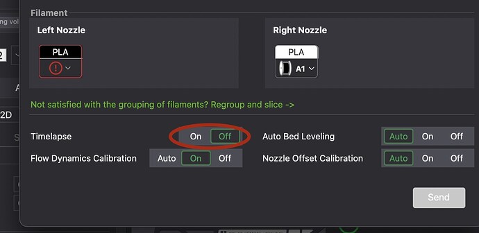

Turn off the timelapse recording, it was causing a similar problem for me during max flow tests (vase mode print) on H2D.
I can confirm it resolved with disabling the timelapse. Still, it should not make such a problem as it was set to traditional and not smooth.

When I print directly from the computer, sending the print from bambu studio, everything works well. After printing, if I want to repeat the print directly from the USB or Internal storage of H2S, the Seam appears again.
Anybody experiencing similar problems?
You can turn off timelapse on the “print agin” screen on the printer, its turned on by default.
Yes! It worked fine. Thanks so much.
I didn’t checked the Timelapse on the screen.
