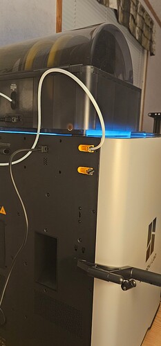

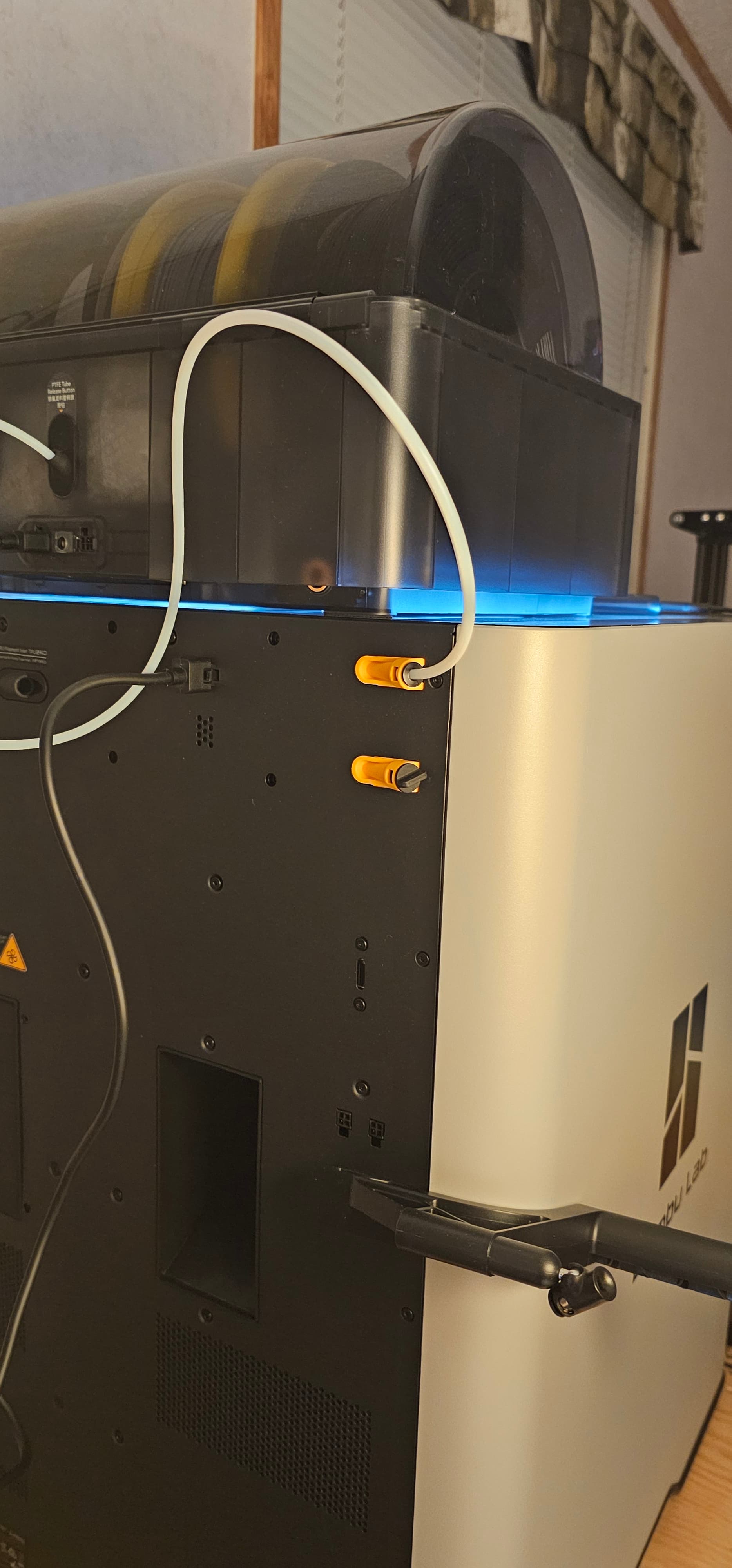

I do believe the H2S does have 2. My printer arrived on September 18. I am attaching a picture of the back.
I am also hoping to find out if I can use an external filament at the same time, but I don’t know if this printer can do that.

Since BL naturally used largely the same chassis, the H2D and H2S are very similar – but not identical. There’s a reason why there’s a plug in the second inlet :smiley: You can’t use both at the same time like with the H2D.
