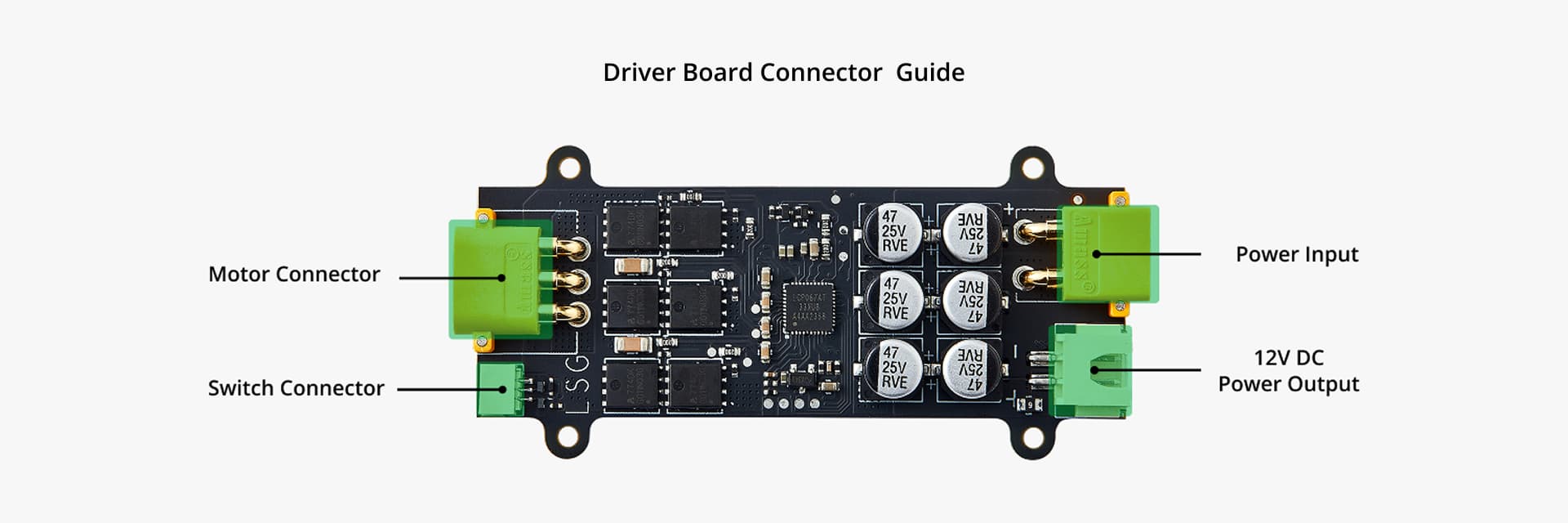

Does anyone know what the 12V DC power output connector on the driver board is intended for?
It’s intended to output 12V DC power /s
In all seriousness, there’s no intended use in the vacuum models but the driver board is likely not a bespoke board and this output would be for higher voltage uses.
Thanks! Do you think it could power on the CyberBrick remote controller receiver? Remote Control Receiver Shield (1PCS) | Bambu Lab US Store
Potentially, it’s input voltage is listed as DC 7.4V – 12.6V.
Well, I tested it and it works, but the issue is that it stays always on. The power switch only controls the motor connector, not the 12V power output.
