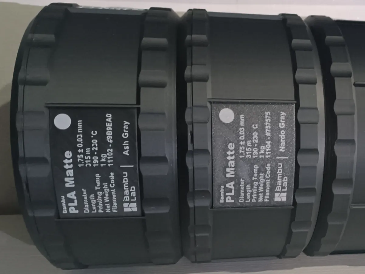

I uploaded a multi-plate model (a modular filament container) to MakerWorld.
The model fits all standard Bambu build plates and uses:

For reference, this happened on my modular filament container project:
