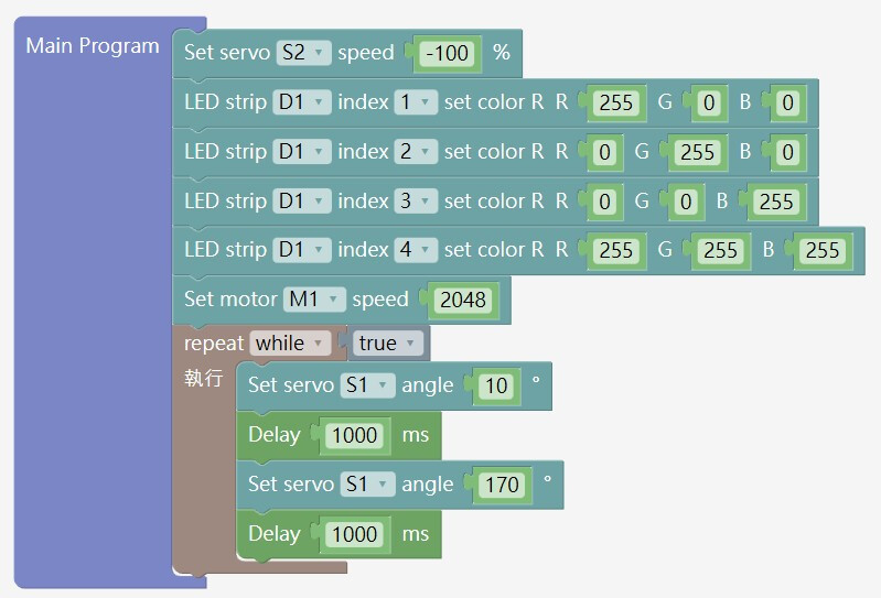

Hi Birdy, thanks for the feedback! :blush:
Quick clarification on the current blocks:
  • In the X11 “LED strip” block you can pick D1/D2 and choose index 1–4 (or All).
  • When you set index N, it only updates that LED and won’t affect the other LEDs’ current colors.
  • Each LED has its own RGB state.
    (See the single‑LED example screenshot below.)

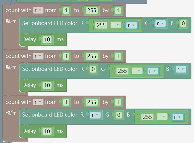

About fade‑in / fade‑out:
There isn’t a dedicated fade block on purpose — it’s a teaching choice so students can build the gradient logic themselves and understand PWM / brightness control.
I’m also sharing an onboard LED RGB fade example. Even though it’s for the onboard LED, the exact same logic applies to any LED on the strip — just replace “onboard LED” with “LED strip → index N.” :slightly_smiling_face:
