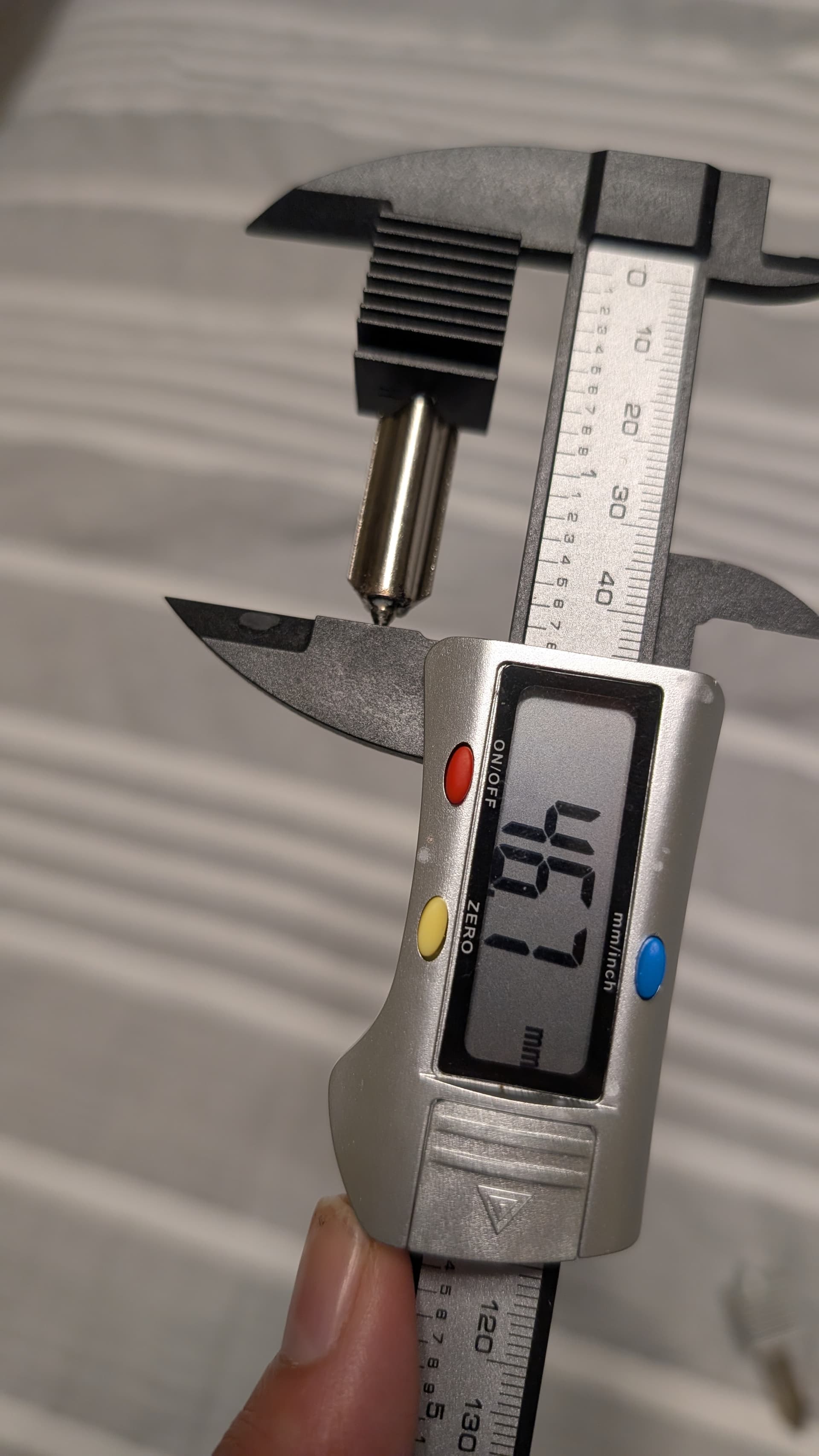

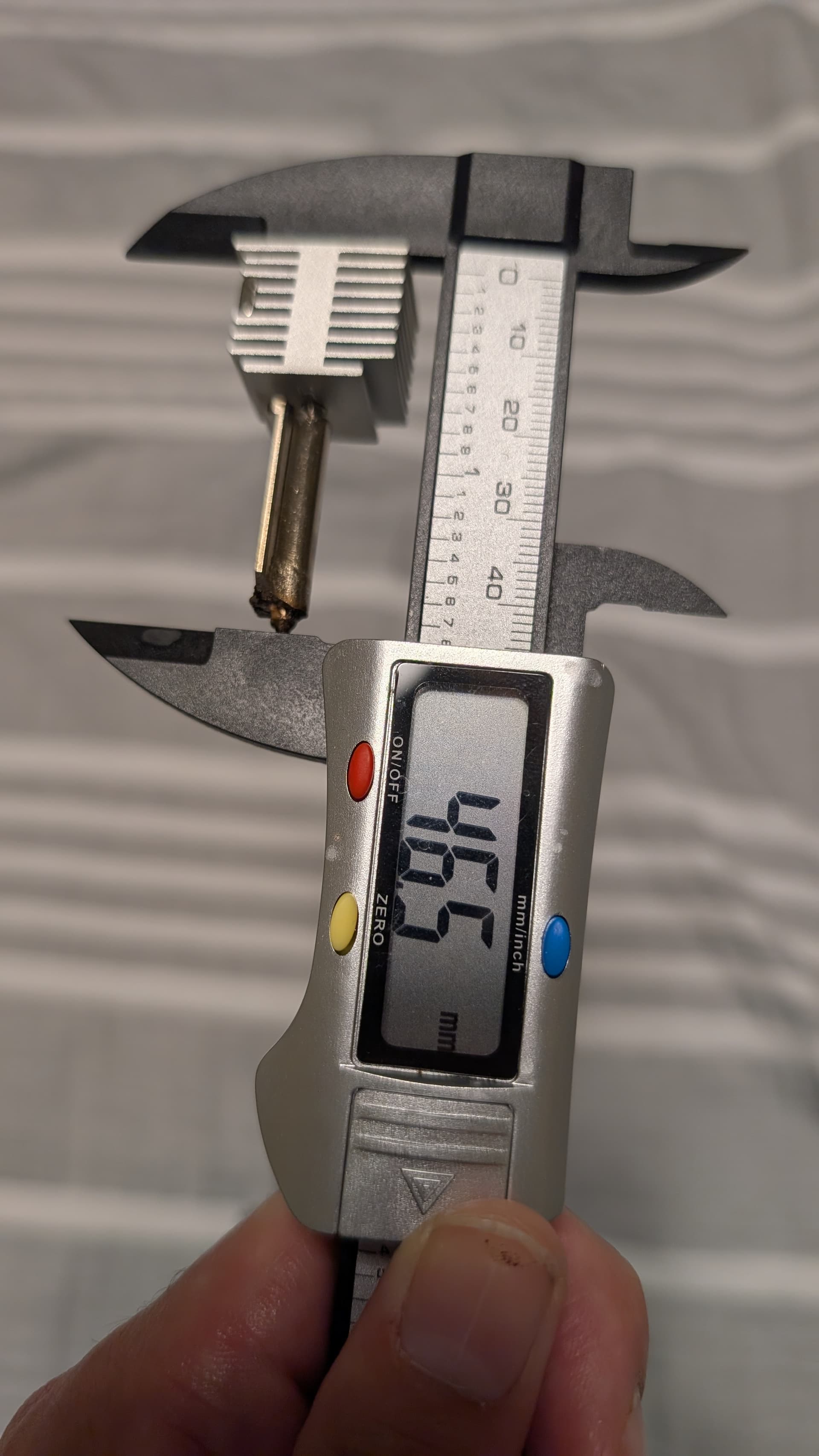

I just swapped out my a1’s stainless nozzle for the hardened. Both .4.
When I put the hardened it sounds like it’s scraping the plate horribly. It also manages to scrape a print off the plate after a couple of layers and it even looks like its overextruding? Not sure what the deal is, I adjusted the settings to the new nozzle, did a full calibration and tightened the hot end screws. Still had the same issues. Mainly the scraping (sounds horrible). Put the stainless back on and it printed buttery smooth with no issues.
Am I missing something or did I get a defective hot end?

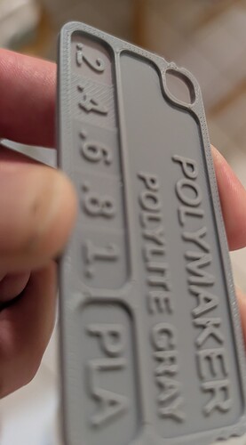

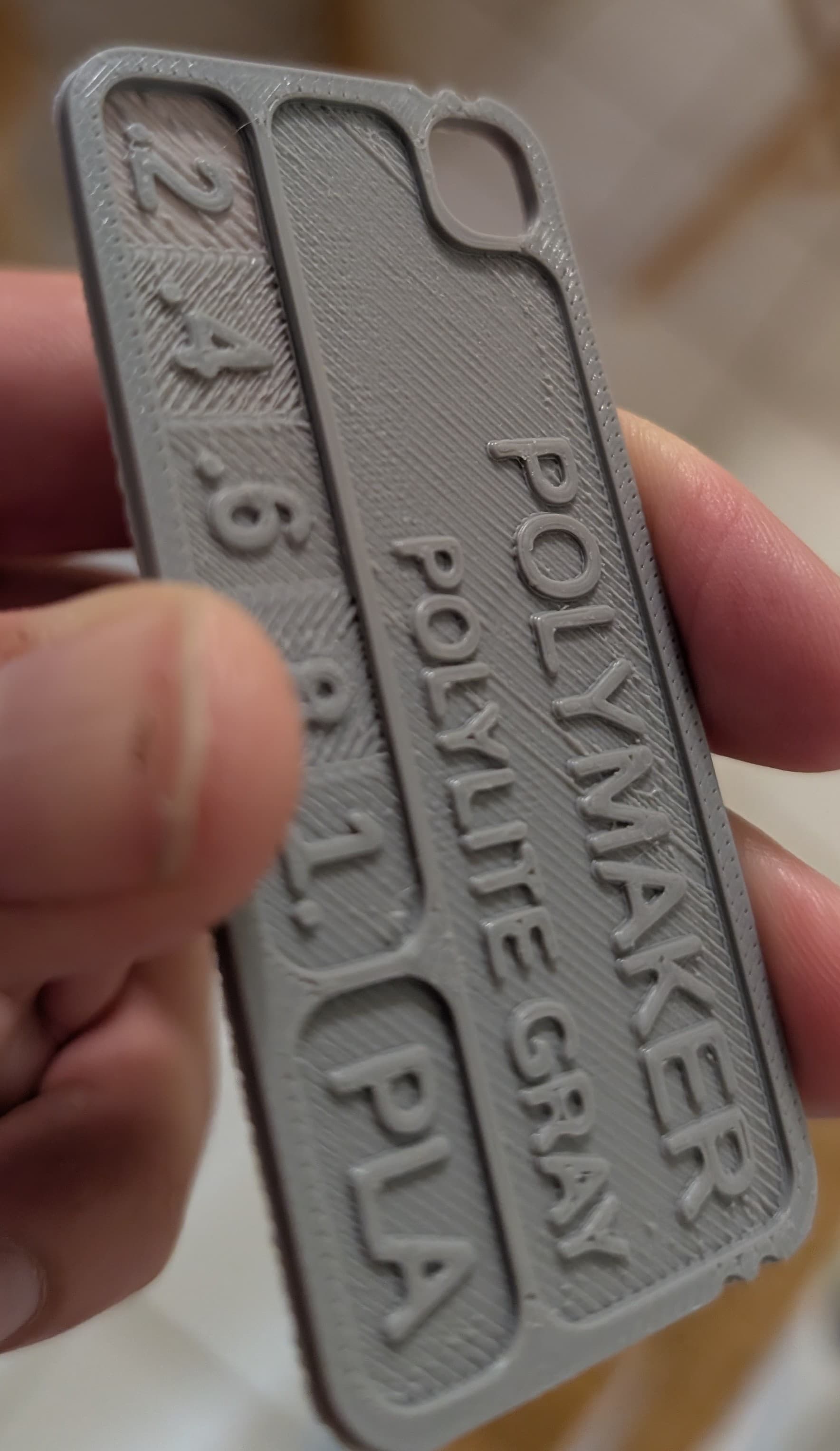

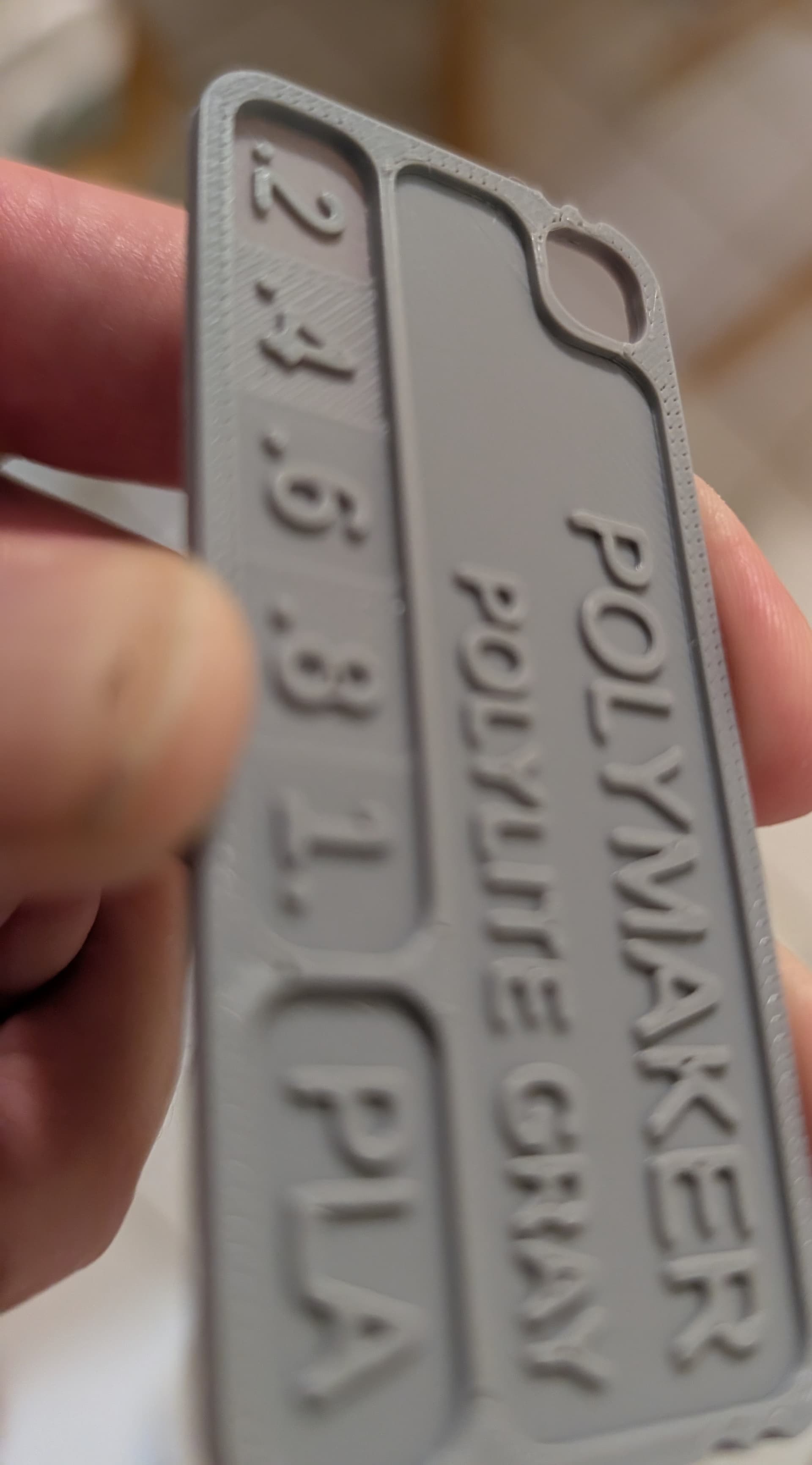

Yea, just tried it again and had to stop it after the 1st layer (was printing another filament card for testing) it’s just scrapping that plate and the print is all blotchy?

Yep, switching back to the SD and it prints crisp without dragging. For what it’s worth, noticed this.

I’ve also noticed all hardened nozzle I have (0.4 and 0.6) are slightly longer.
I trying to see if adjusting G29.1 Z{-0.02} line in start g-code will help but I’m surprised the default value are not affected by nozzle type since the lengths vary.
EDIT: G29.1 Z{-0.02} → changed to G29.1 Z{0.00}, printed small rectangle and significantly better looking surface, I’ll go back to -0.02 and tighten screws per wiki to do more tests.
EDIT2: Found that four screws at the back of heater assembly are bit loose so did the the following (per wiki): “Flip the heater assembly over to access the 4 small screws at the back and use an H1.5 hex key to retighten the screws…” , ran full calibration and reverted machine code tweaks. Samples looks much better.
