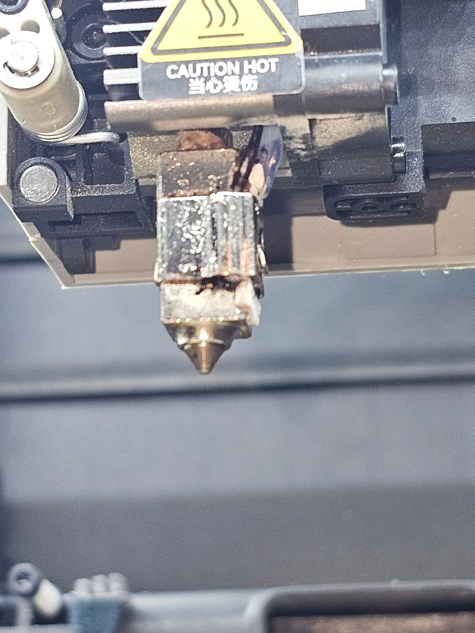

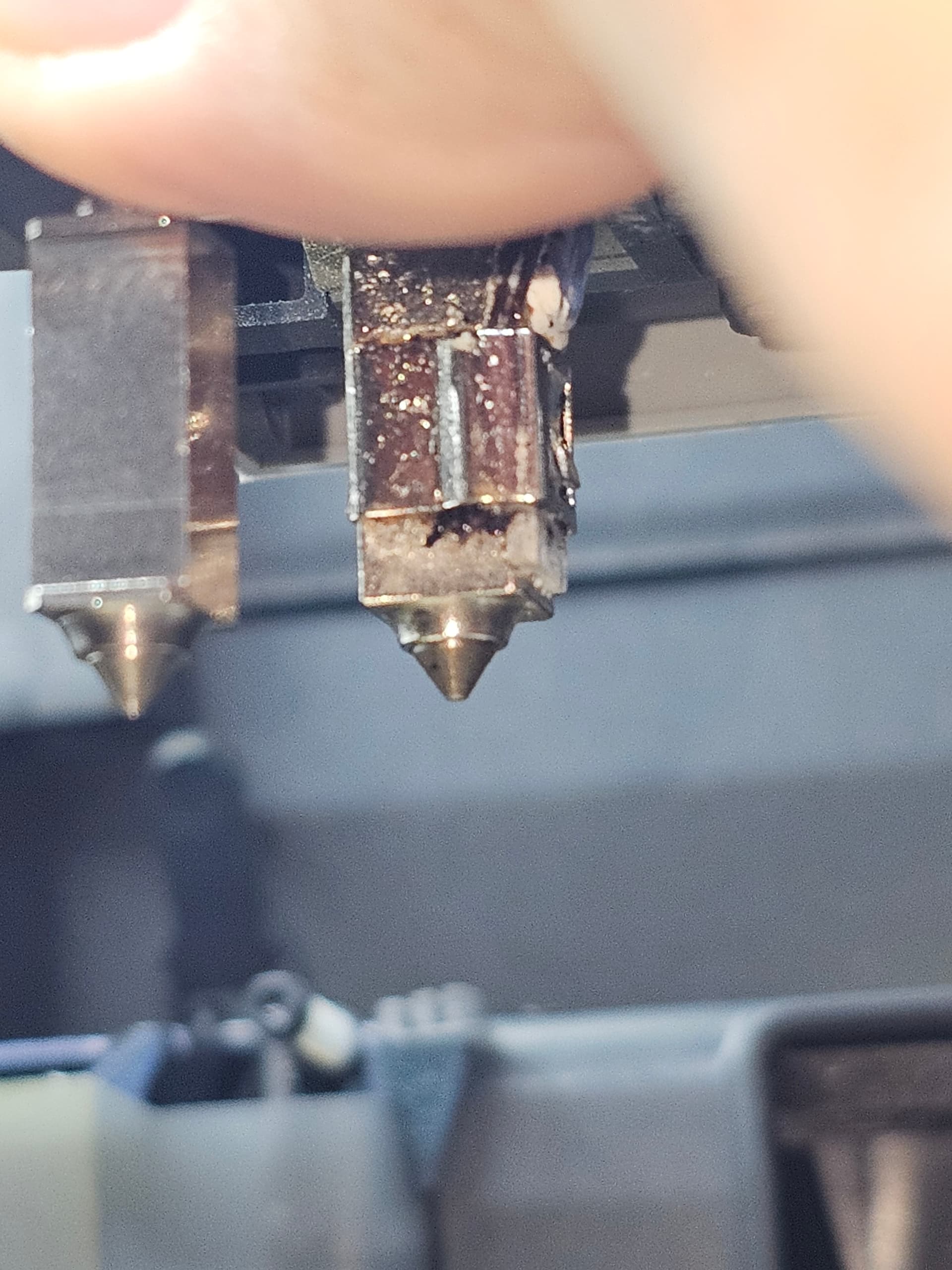

Got it. Will look tonight and take some pics if it’s questionable.

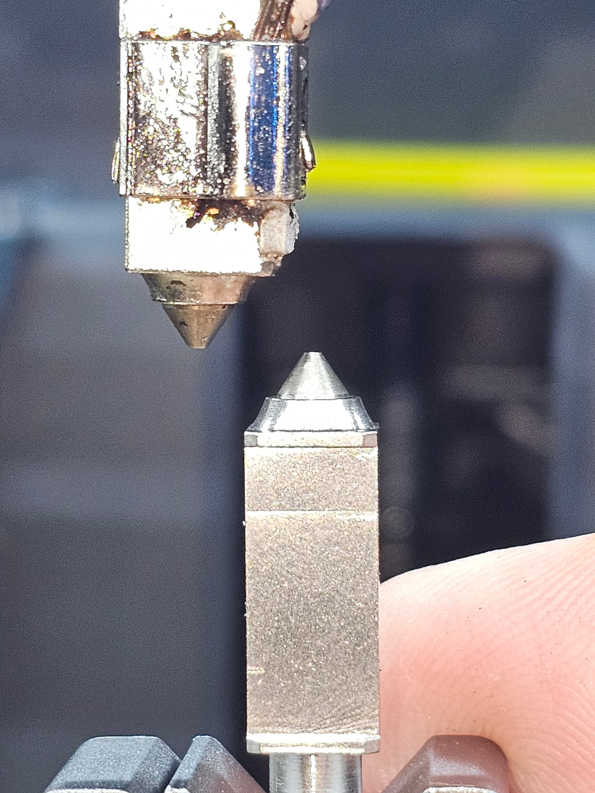

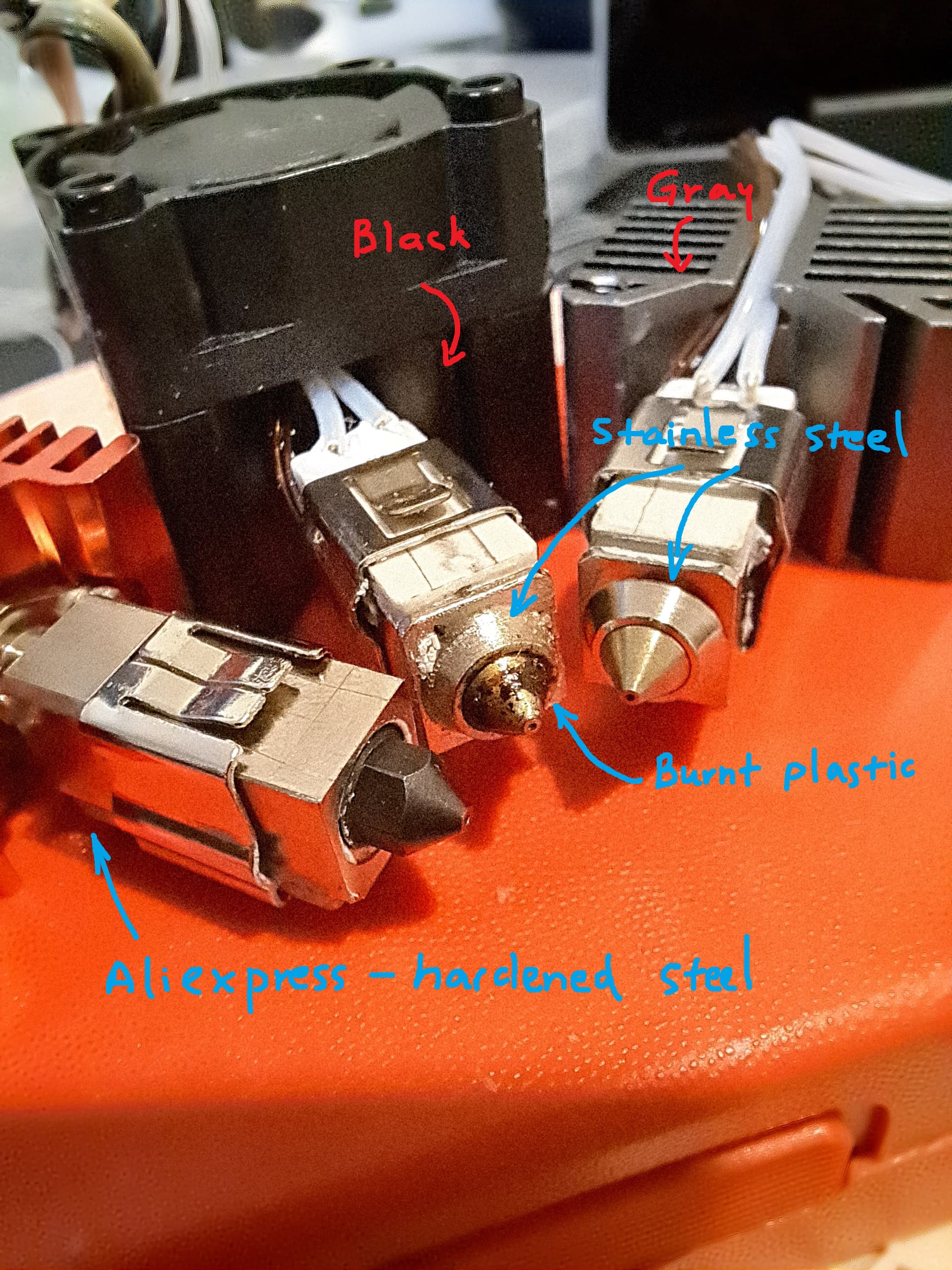

There is definitely a difference in color in the heat break fan/cooler. Black & sort of a matte grey. Nozzle itself can get discolored by heat.
I have a bunch of new spares I just looked at and looks to me like stainless has the grey cooling fins and hardened steel are black.

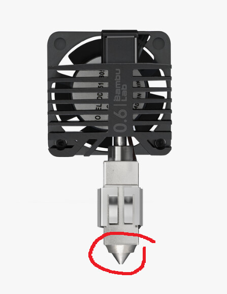

Hotend and spare hotend came with P1S are stainless steel.
I don’t have BBL genuine hardened steel hotend. But for visual comparision, hardened steel looks like

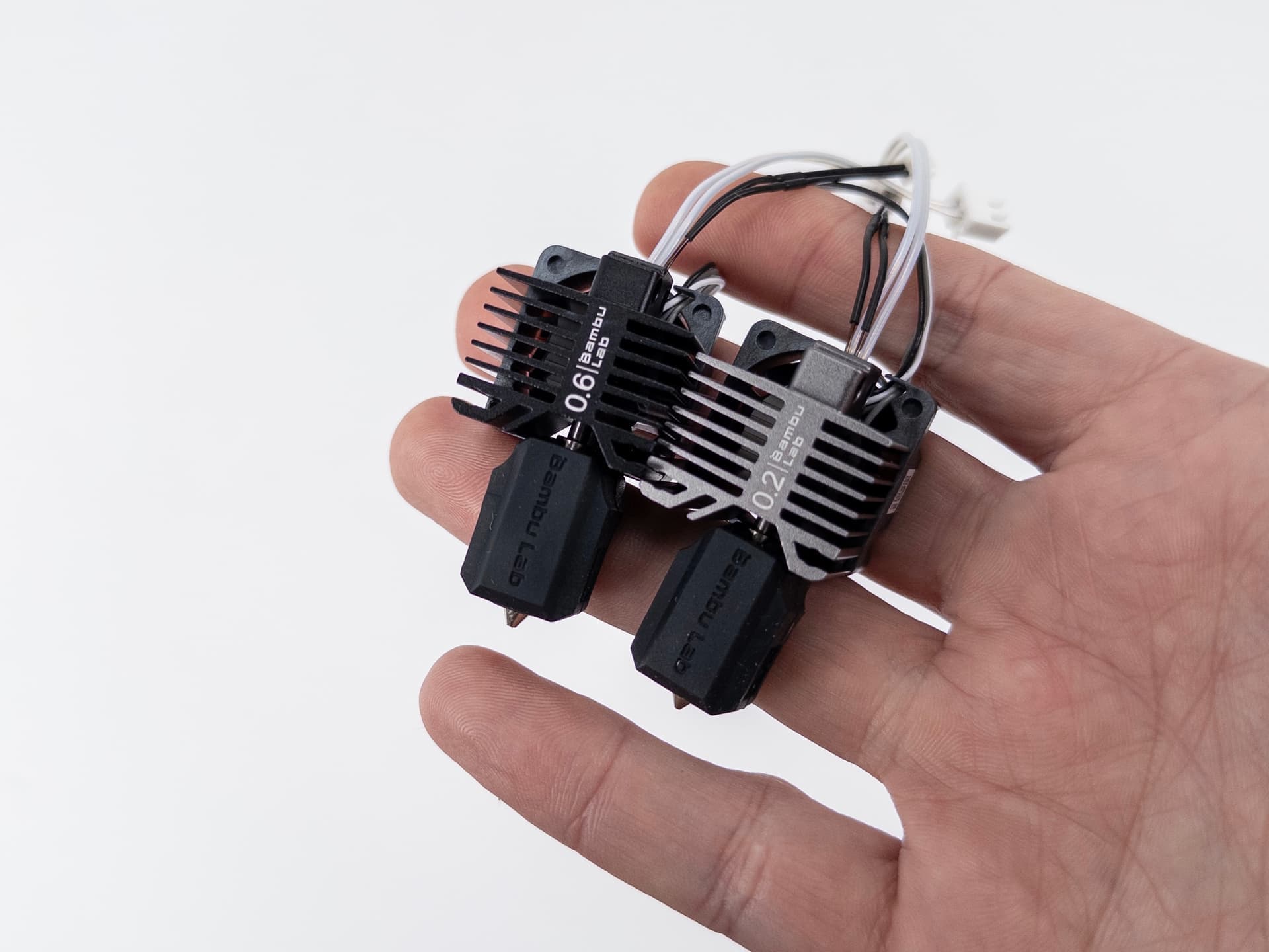

Here’s a pic from another thread that is similar to this one. The OP in that thread also thought he got the hardened version with a P1S. The consensus was that the heatsink on the stainless steel version appears black under some lighting conditions. Hardened is on the left.
